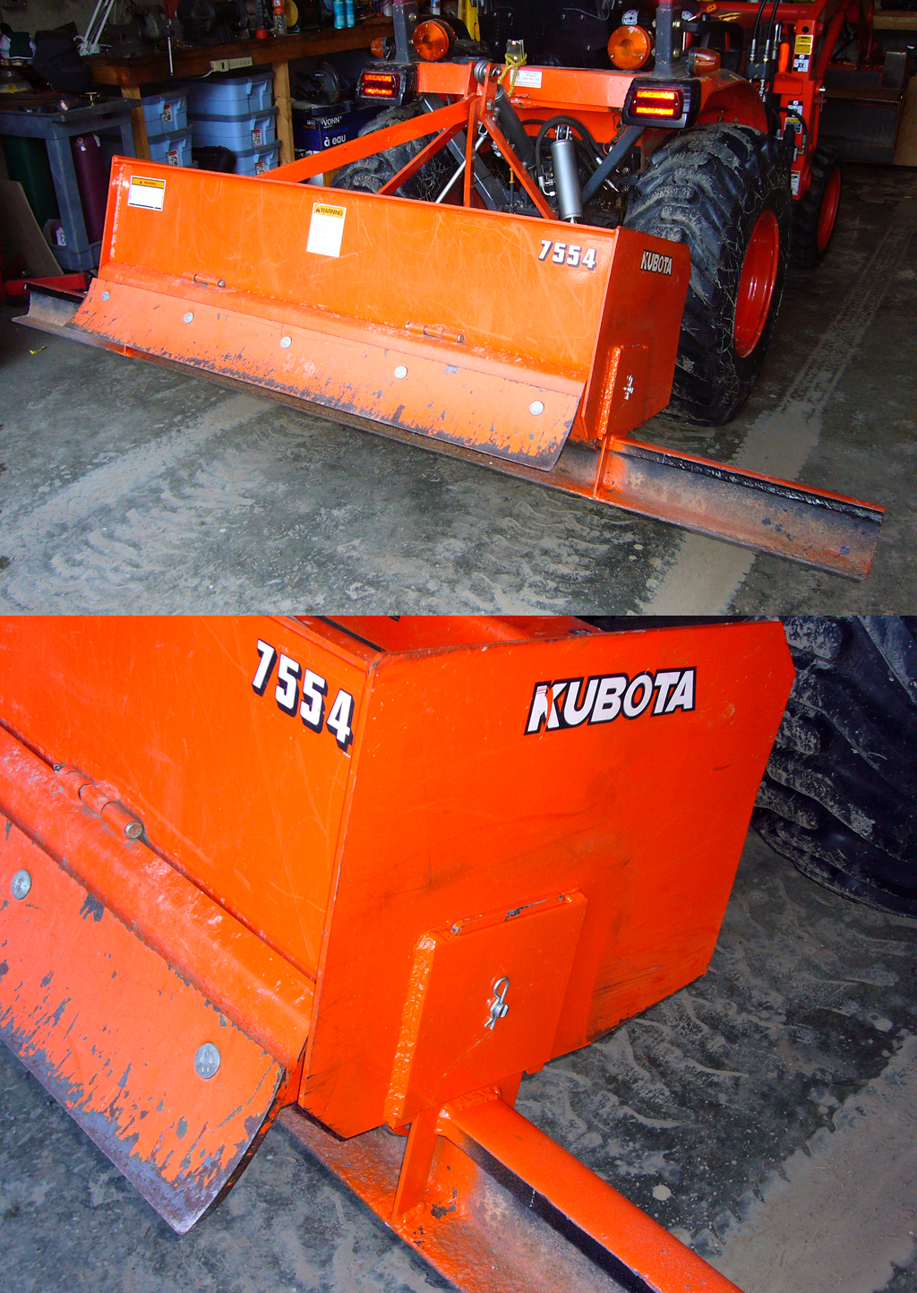

I have attached a pic of the 200 lb 8 ft Train Rail Grader attached to my 400 lb box scraper for a 600 lb total. With Top & Tilt 3 point hydraulics it does an amazing job of maintaining my 1000 feet of driveways especially after the winter ravages of snow plowing.

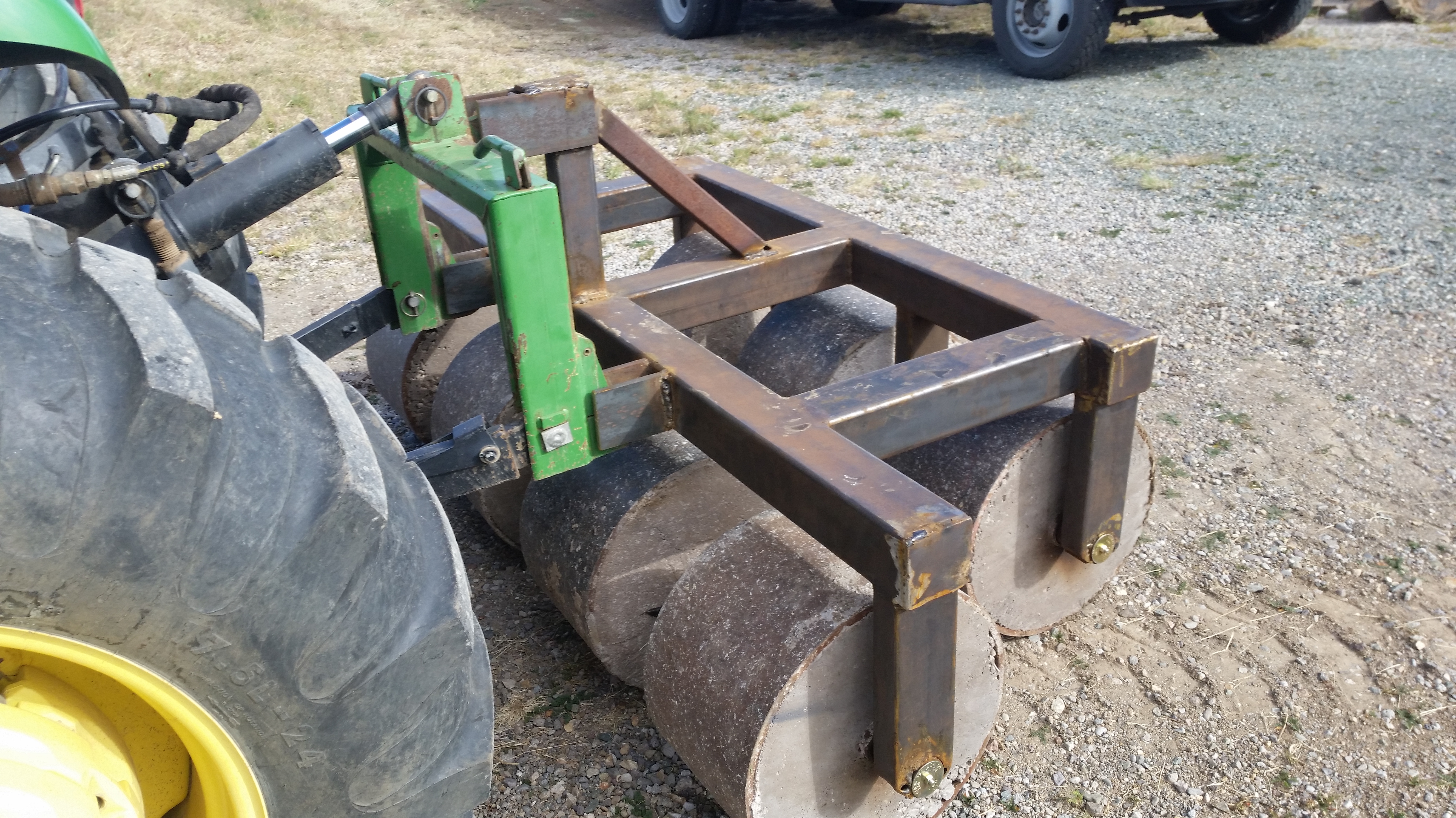

Both of my lpgs use the blades set straight. Most of my use (75%) is for smoothing pastures when grading for flood irrigation. This week I am using the small 4' lpgs to smooth over a customer lawn area.
Here are the two lpgs , 3ph spike tooth harrow and roller that I have built for smoothing and rolling my jobs. About $2000 total in everything plus my time which is cheap.:D
