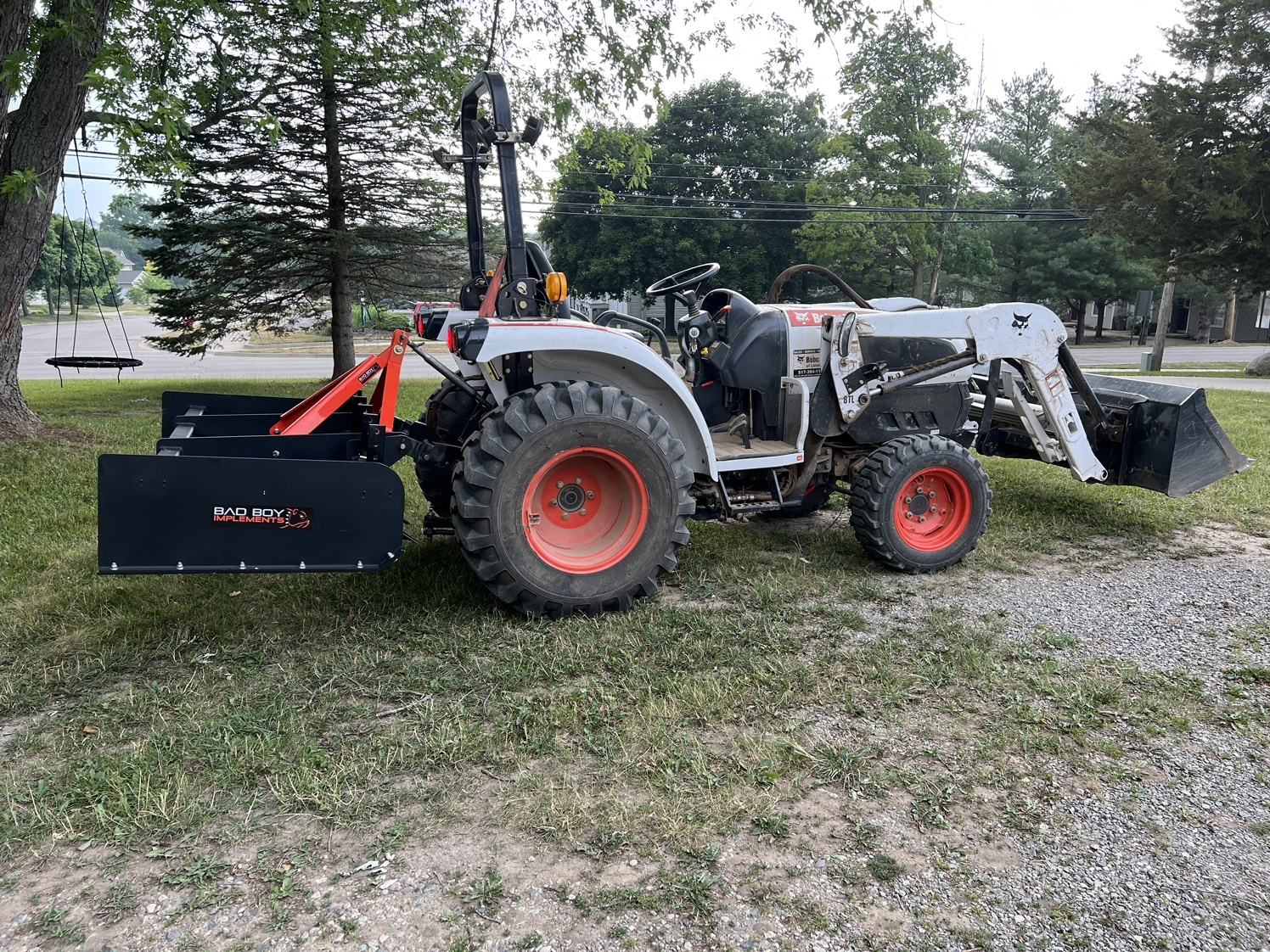

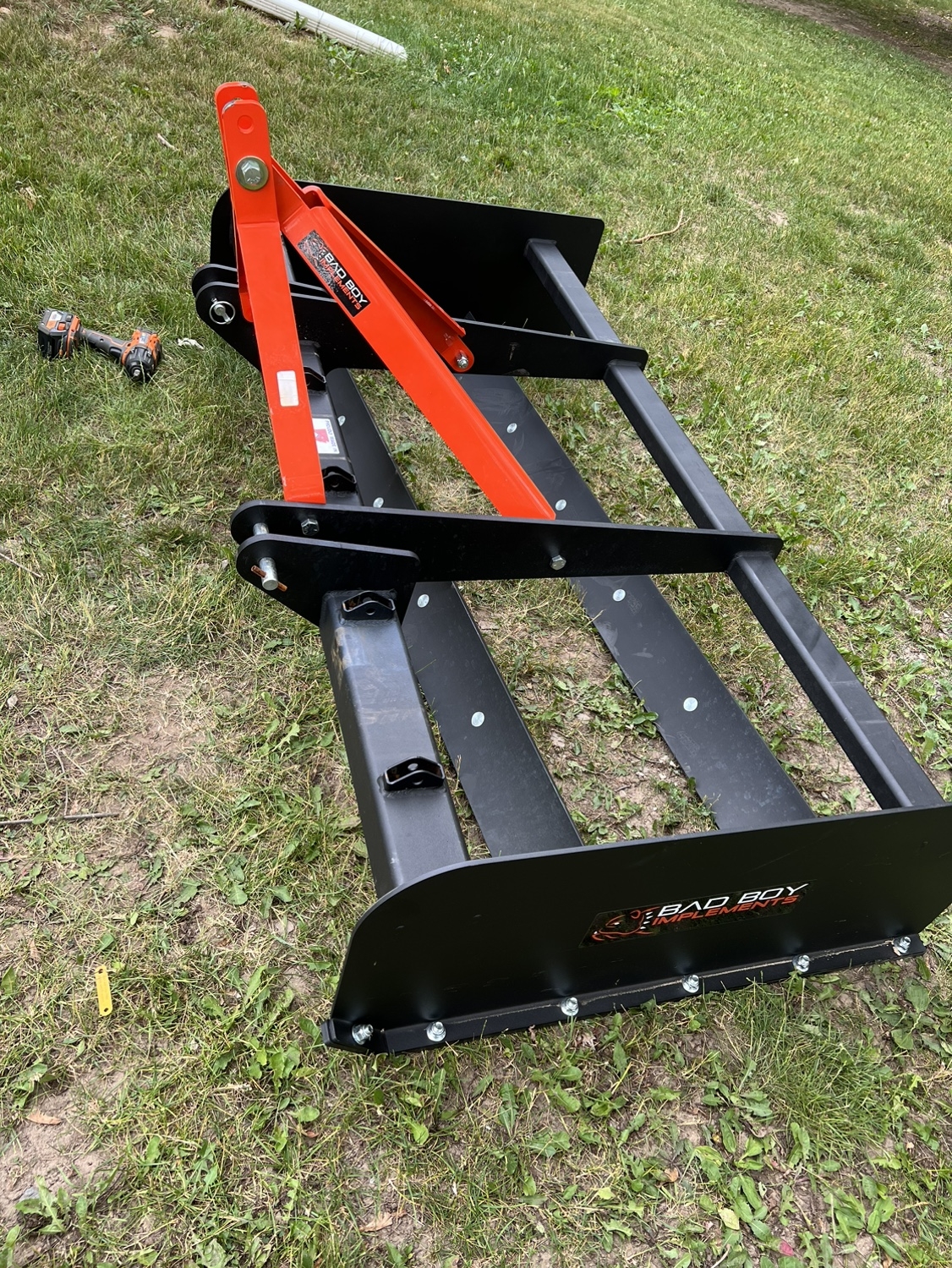

Here's what I threw together.

Update: more quotes today from 2 dealers
1) Landpride GS1572 @ $2400
2) Bad Boy 72" @ $1300
Both brand new.......
Guess which one I'm going to tomorrow?
   / Land Planes / Grading Scrapers
#75
One found its way into the back of truck this evening. Thanks to everyone that provided feedback. I was encouraged that none of you expressed regrets or disappointment in your purchases, and my local Bad Boy/ LS dealer shot me a significantly better price than any others. I rewarded him by purchasing promptly without haggling. I’m a strong proponent of rewarding good behavior.

I adjusted the blades down to the most aggressive setting since I’m in dirt. It cuts real well and gives my tractor a good workout. I think I need to adjust them back up a smidge to keep it from digging. I had dirt spilling over the top, back bar.
