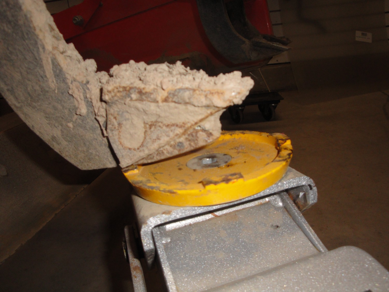

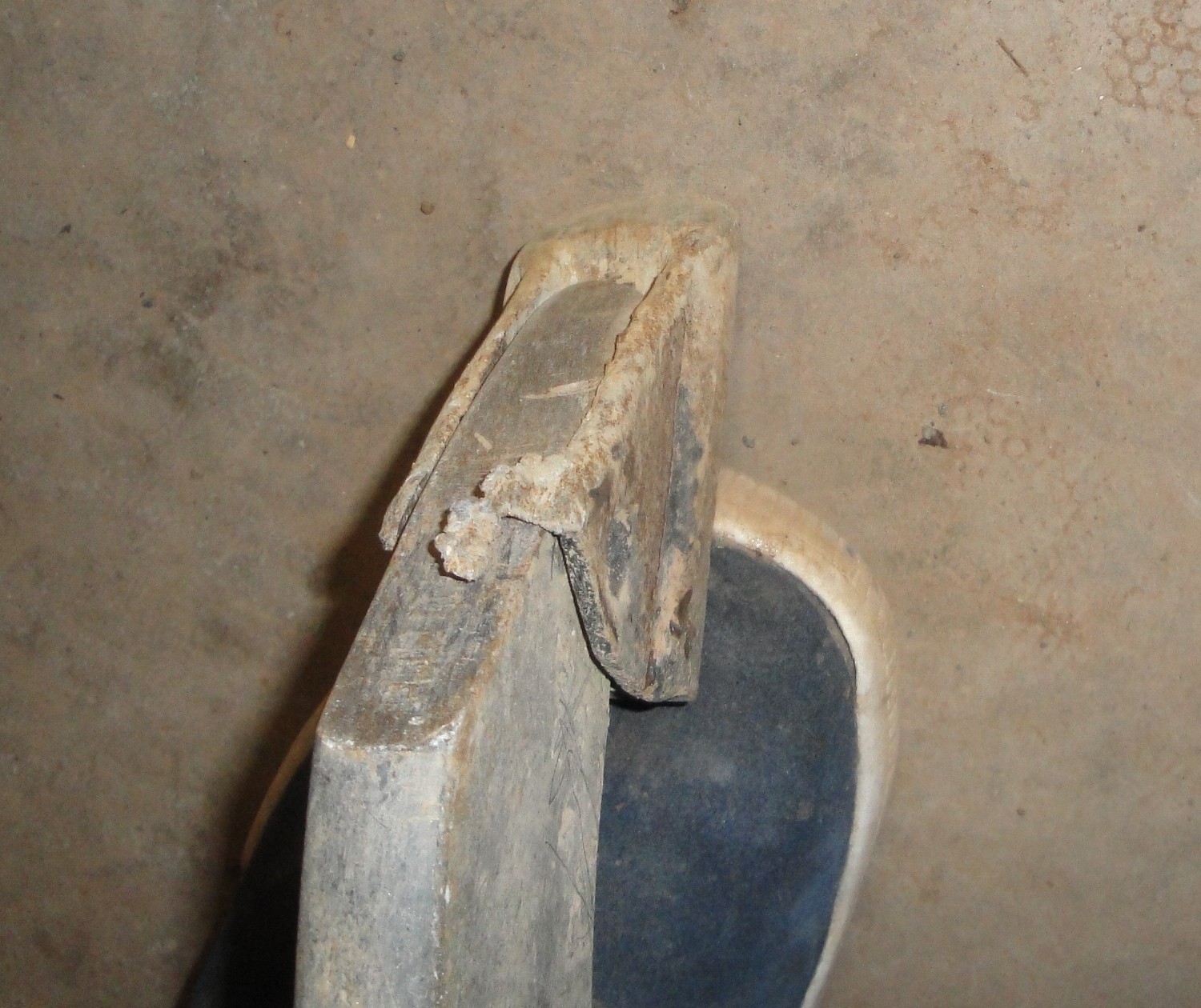

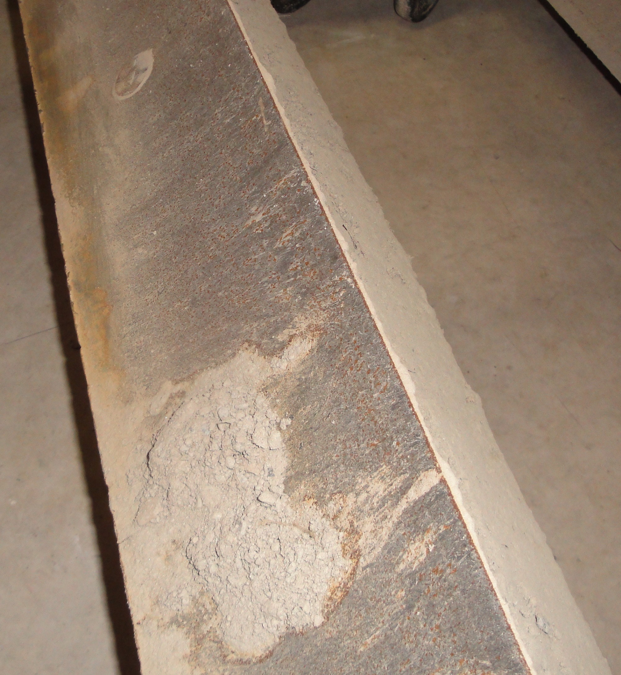

I see there have been a few comments regarding my post outlining, what I considered, abnormal wear on the blade and teeth of the landpride. Six months and approx 15-18 hours of grader use has accumulated since my previous post on wear so I'll update with photos. The blade is slightly worse for wear with more nicks than I reported back in May but the teeth haven't fared well. The last time I graded a few weeks ago I noticed two of the scarifier tips had rotated upwards on the shank rendering them useless. Further inspection has shown the bottom of tips have completely worn off allowig the tip to swivel around the dimple. The tips themselves have worn down considerably as well therefore all four require replacement.
I'm still estatic with the gader and the wonderful job it does grading roads/driveways but I'm less than impressed with the blade and teeth wear. My previous cheap-***** boxblade had considerably more hours on it with hardly a hint of wear on the blade or teeth so, in my opinion, Landpride has cheaped out on the wear items or perhaps inadvertantly sourced some questionable quality steel parts for the wear items.
Anyone know a good source for good quality scarifier tips?

my 72" Befco has about 15 hours or so of grading compacted bluestone and gravel. It works better than a rear blade or box blade but the scarifies are ready to be replaced. Both blades and the wear bars still look good but the teeth are a bit soft IMO.

About any agricultural dealer will have the shank tips available that are a friction fit and just need to be driven on with a 5 pound hammer. I had forgotten that one of mine came off when it was new. The replacement tip was $13. My dealer told me that the tips themselves are meant to be "sacrificial" and pull off if a large object is hit to preserve the more expensive scarifier shank. BTW, I only drop the scarifiers when I'm trying to pull up the base to help repair pot holes. 90% of the time my scarifiers are up and not getting any wear.
