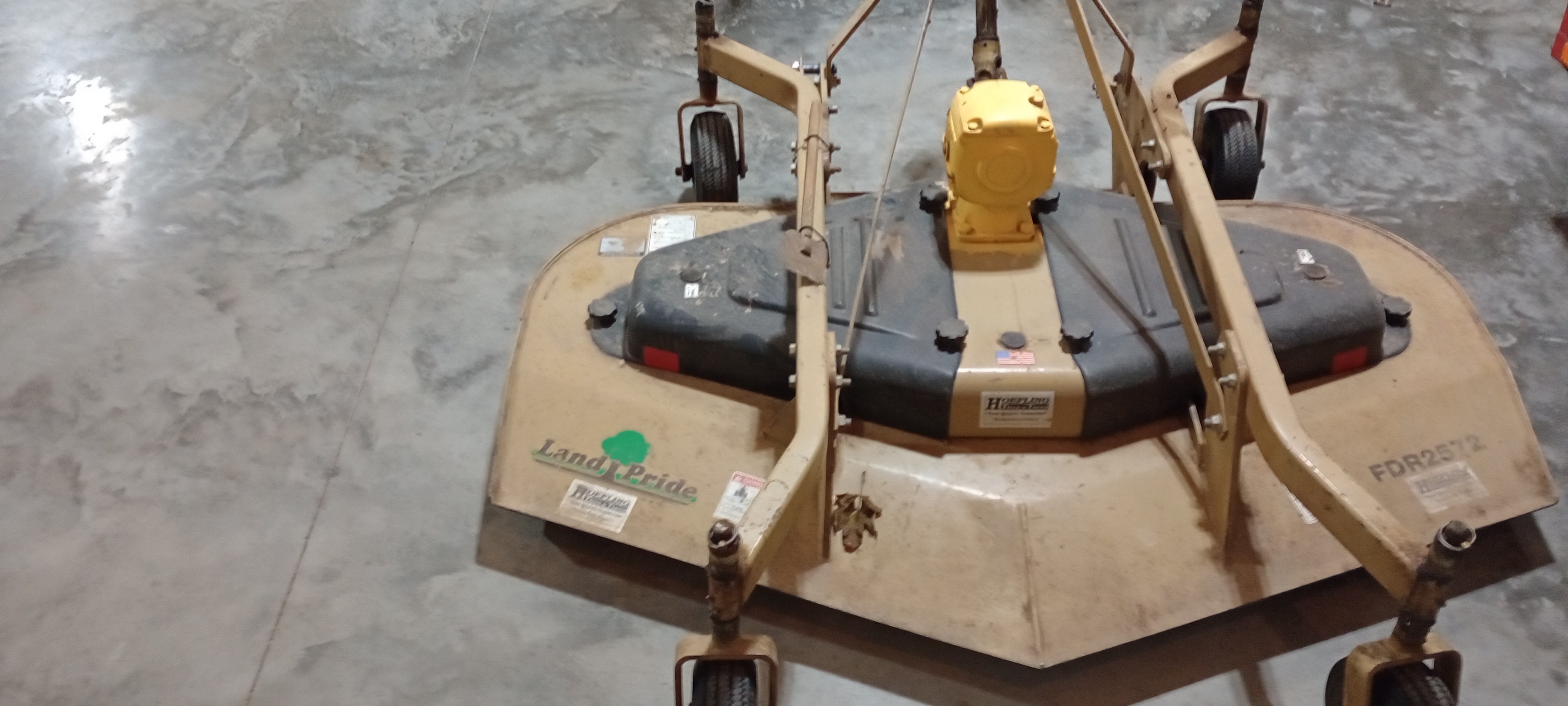

I purchased my land pride 2772 in 2014 and a used finish mower. Used a 4066R tractor. The finish mower has had three sets of blades, one set of tires and one belt, totally my fault on the belt. They have no dings and not bent up at all. I ran over a stump and bent one blade into a u shape. It gets used in places it shouldn't. Never had bearings or spindles replaced, so unless land pride changed the way they build them, ( and maybe they have) I have had great luck with mine. IMG_20250208_083448287.jpg

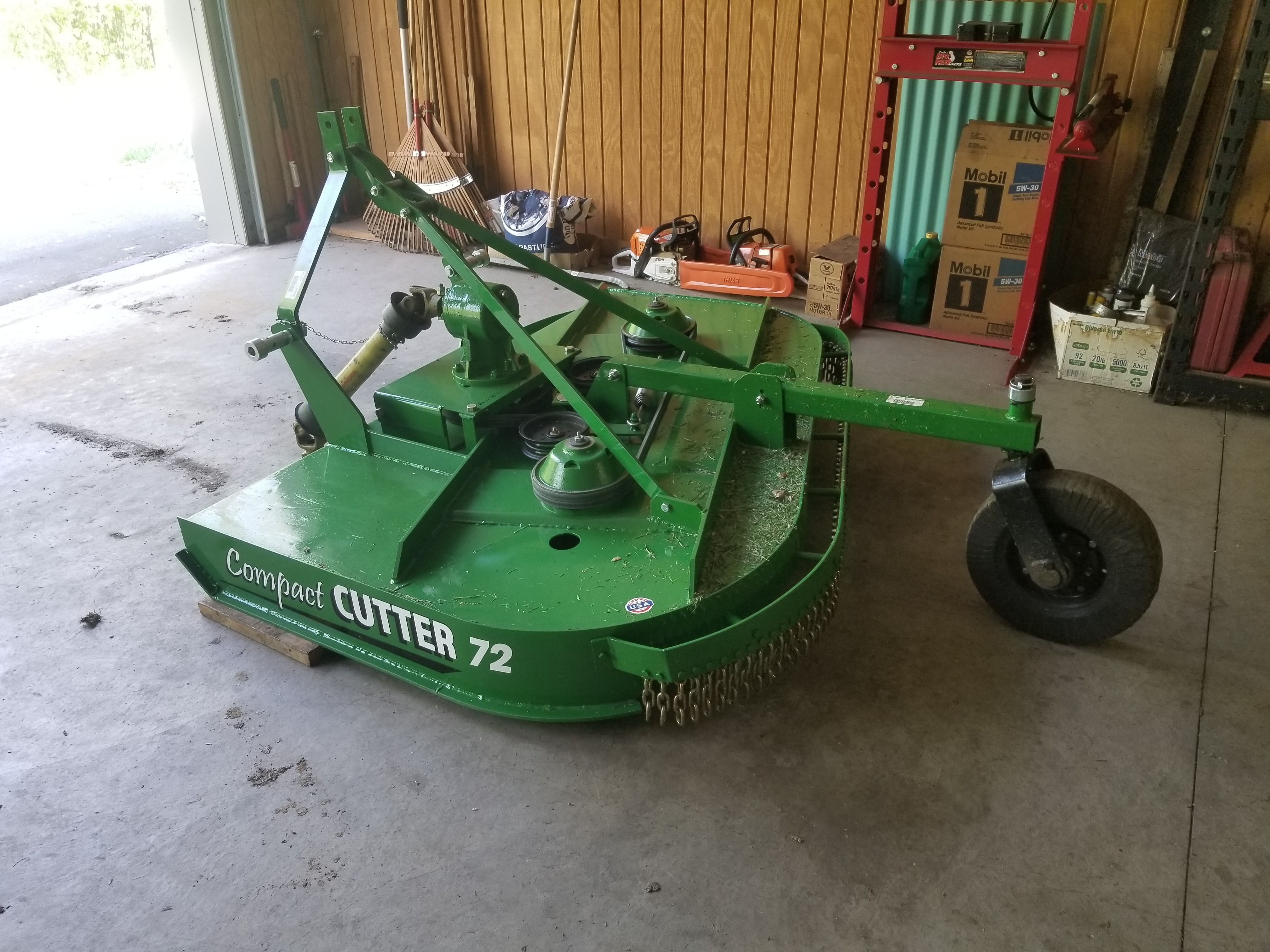

Before I built this 2-spindle rotary cutter, I looked long and hard for a used 3pt finish mower (cheap, because I was going to fab on it).
This cutter is a hybrid drive (gear over belt) so starting with a finish mower made sense. After years of engineering tractors/mowers at Deere and tearing them down after field testing... I knew what to look for.
EVERY 3pt finish mower I looked at (all brands) was beat to hel! Wow. You know they are designed to take just 1/3rd of the plant off... right? ;<) Every seller said the same thing "She runs great... prolly needs blades tho." Lol... cracked me up!!!
Those of you considering a used 3pt finish mower: look at the spindle pockets (where the spindles bolt to the deck). GUARANTEED they're as wonky as a log pile. Not a one of the finish mowers I looked at would EVER cut flat again (new blades or not). I ended up with a Keen Kutter 72"... it was a steaming pile when I got it but the gear box was good and it was a lump of steel to start with. She's got new life in her now!

One thing about multi-spindle mowers: their design often allows spindle placements aligned to better back-sweep tire tracks. This equals better cut quality. When you start mechanically lifting the material, you don't have to have the high lift blades and high tip speeds that  really suck the power. Today, you are now seeing some new batwings running very well behind moderate sized compacts.
My 2 spindle was built because there was zero offerings (other than single spindles) for a 20hp pto tractor like mine. I was off-setting half the mower width to get decent cut quality with my single spindle! Once in the grass last Spring, I hired the kid across the road (just out of film school) to video it.
For the techy: most single spindle rotary cutters are running high lift blades at appr 15000 fpm tip speed (fairly moderate, impact cutting stops below 12000 fpm). My 6' cutter is running twin Fred Cain 3' low lift swing blades at 13500 fpm... it flys with 20hp! Small blade diameters (multi-spindle mowers) use higher rpms to get the same tip speed: BIG ADVANTAGE. A typical 6' single spindle takes one wack for every 2" travelled (@ 3 mph). My twin 6' makes a cut every 1.1" @ 3 mph. Almost twice the cuts/foot! That why mult-spindles work so well. Not cheap though. Love to read about the mowers you guys are running!
