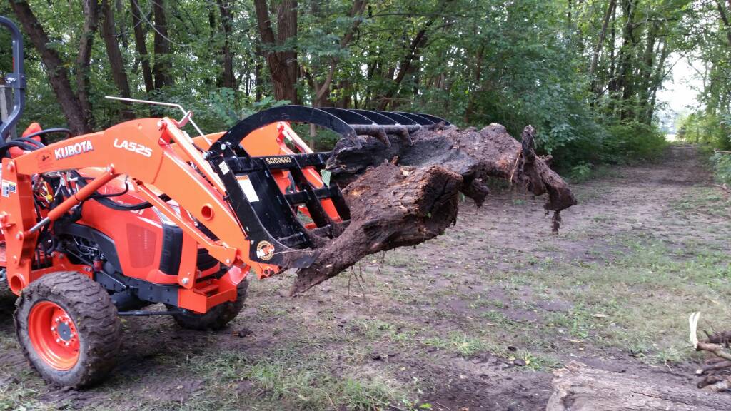

I got the SGC0660 with my L2501 last month. I chose the 06 over the 10 because it is lighter. No regrets so far.
Some of the things I've used it on. 20181013_104420.jpeg20181013_091110.jpeg20181013_091102.jpeg

I've got a L2501 and a LP SGC0660.
Had them both for three years now, they are a perfect match.
The teeth are all AR400 steel. Zero wear so far.

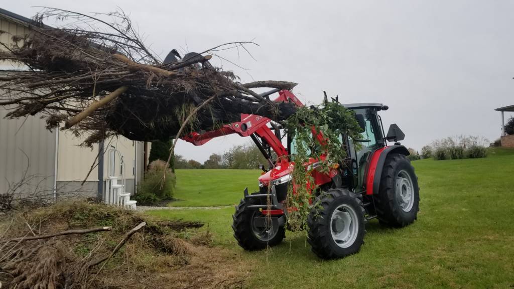

A grapple doesn't have to be as wide as tractor if you wont be using it heavily. Width gives you a little more stability handling the brush/logs, but it's not like a mower that you need to cover your tracks. My machine is 82"wide, my grapple is 78" ...works just fine20181026_114107.jpeg20181026_112729.jpeg
