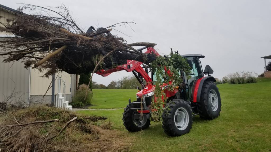

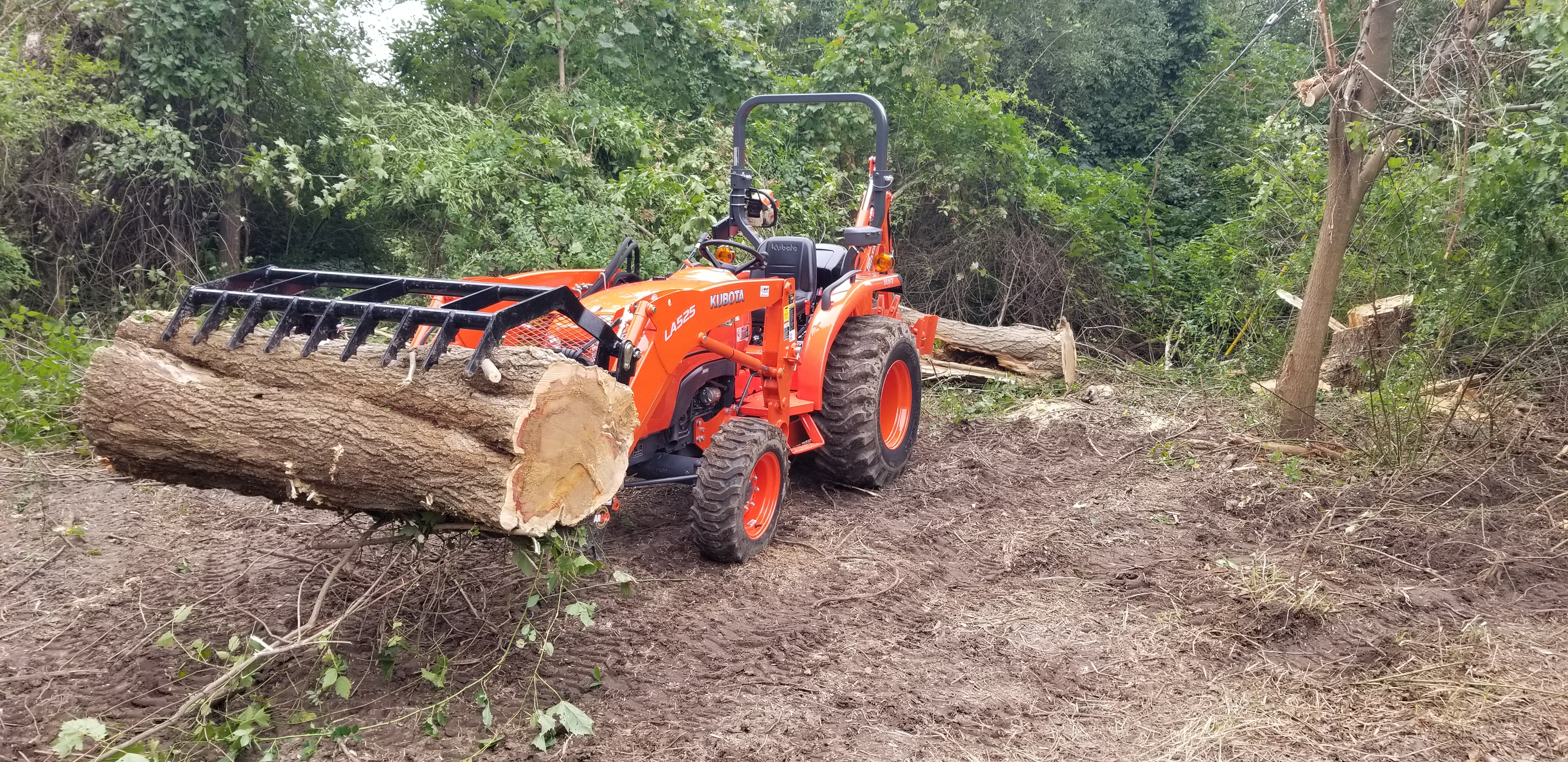

A grapple doesn't have to be as wide as tractor if you wont be using it heavily. Width gives you a little more stability handling the brush/logs, but it's not like a mower that you need to cover your tracks. My machine is 82"wide, my grapple is 78" ...works just fineView attachment 577579View attachment 577580
Same. My machine is about 78 and the grapple 72. Works just fine for me.

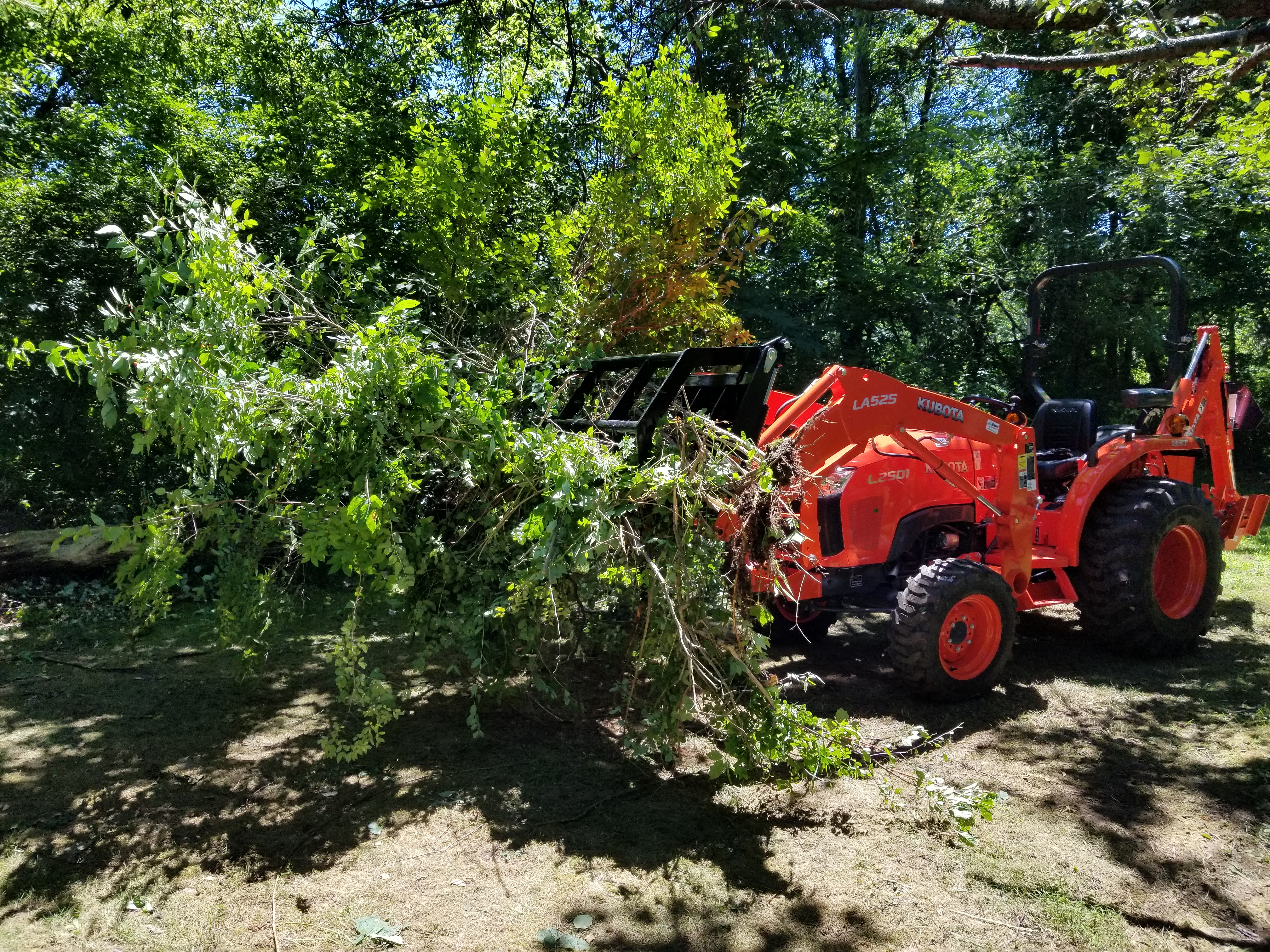

After using my SGC0660 some more I can see the benefit of the saw tooth teeth on the EA and larger LP grapples. They would be helpful for more log related work. Overall brush piling and pushing has been good. Can't pick up individual small pieces bur can rake it into a pile and then grab it or push it. Have done a very little root grubbing and it works okay on trees up to about 3 in or so diameter. My L2501 seems to run out of traction more so than the grapple not working. I'm still happy with mine but the EA 55 inch one would be a very good choice. Having any grapple is awesome. 20181104_102601.jpeg

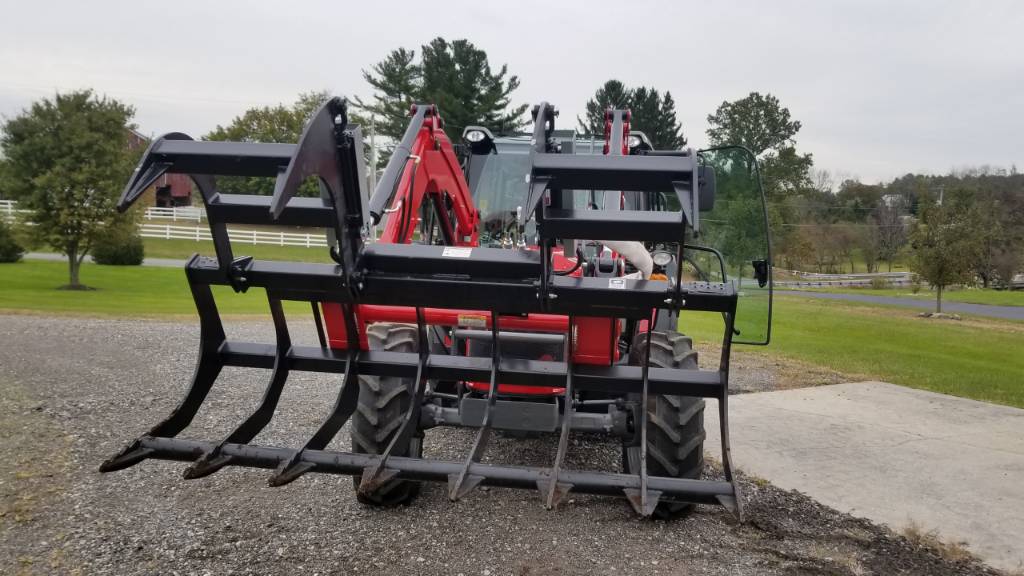

Geotech I have a 2501 with a 1060, my dealer let me try a 660 first for me the tines on the bottom are not for pulling roots it has a piece of pipe running the length about 5 in up limits the ability of it to get the roots out. It is lighter but not nearly as heavy duty as the 1060, it is a beast the tines are much longer work well for roots and clearing the thickest brush. I have a piranha bar also but rarely use it, it is heavier 360lbs but I can still pick up quite a bit you won't be disappointed with the 1060 just my opinion. 20180908_152942.jpg20180702_141035.jpg20180702_124424.jpg

Thanks Maxl. Really appreciate the input. That thing is a beast. I just bought the L2501 today. I ended up going with the 660, but that 1060 looks great!
