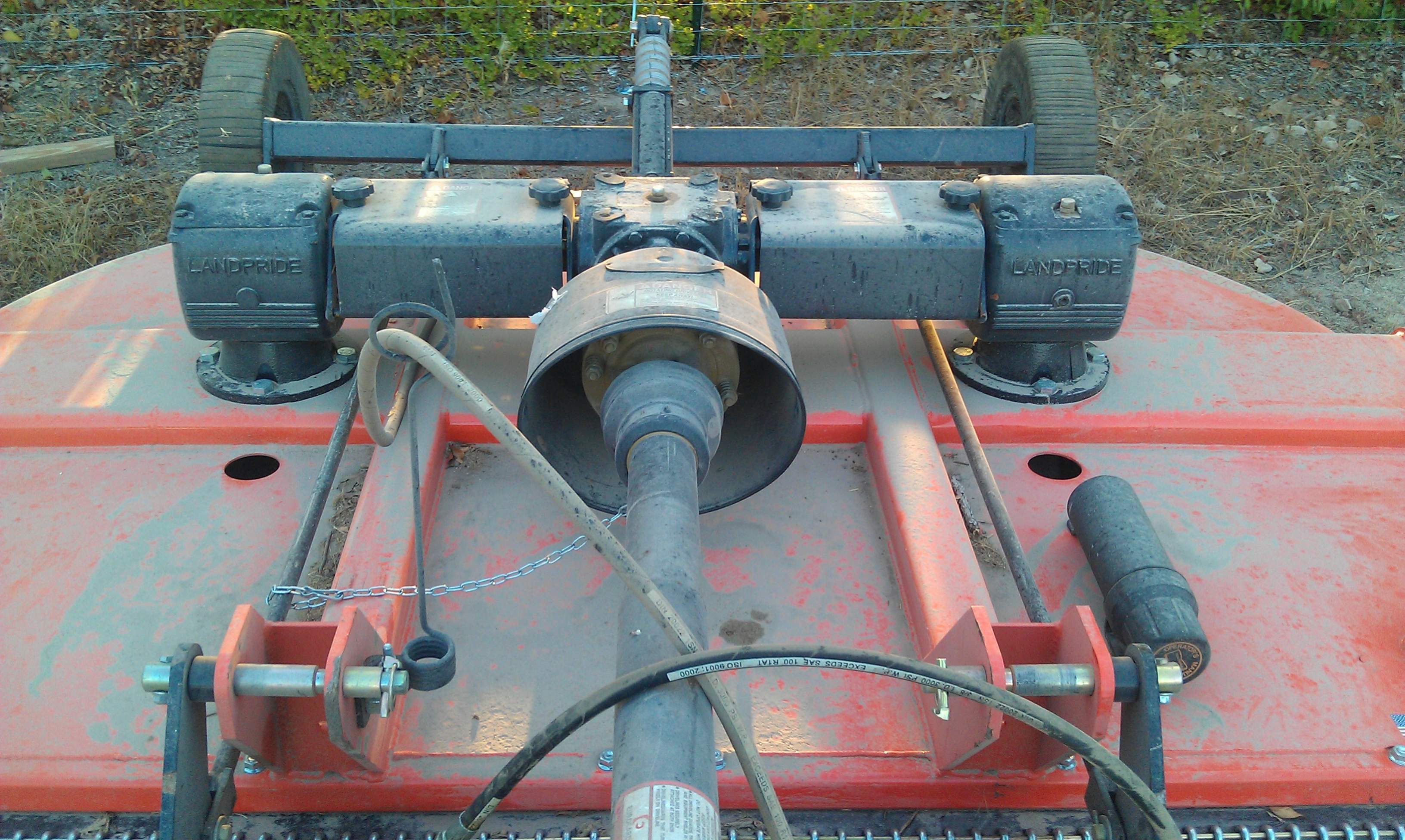

Have had really liked my 8ft Landpride(RCR3596) tough shredderView attachment 230448 No vineyards here just brush,small trees,goatweeds,etc.Hope it helps!!
Thanks, every reply is useful. The light duty mowers don't really represent the companies too well in my view. They are too easily abused and as a result there are more owners disappointed with the brand as a result which is why I tried to stress in my original post that I was dealing strictly with the medium duty cutters. I want to see what the people who actually have the medium duty models from these two companies think of them and it doesn't have to be the same 5' model, just similar duty rating/build quality so that I can better judge them.
