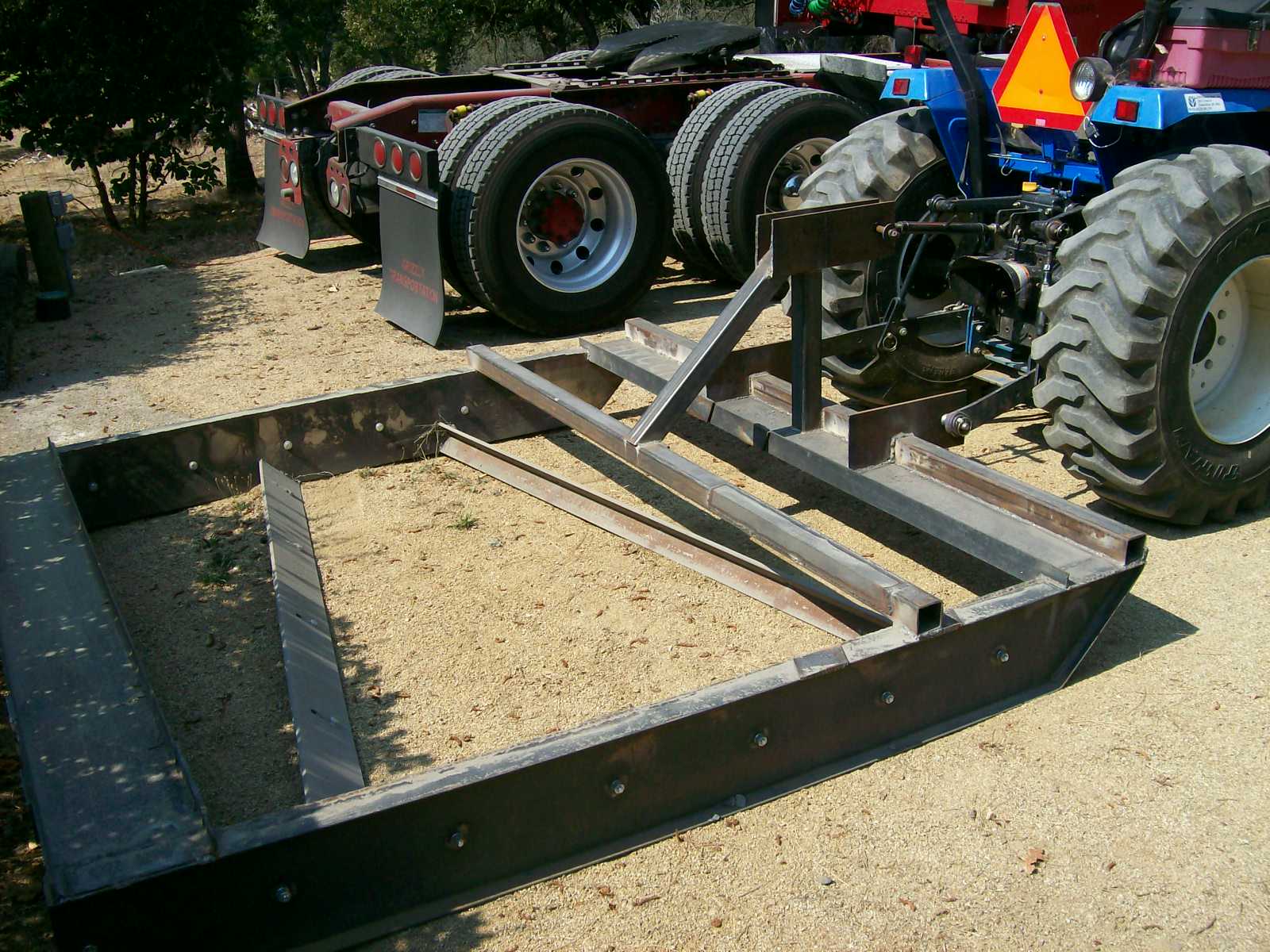

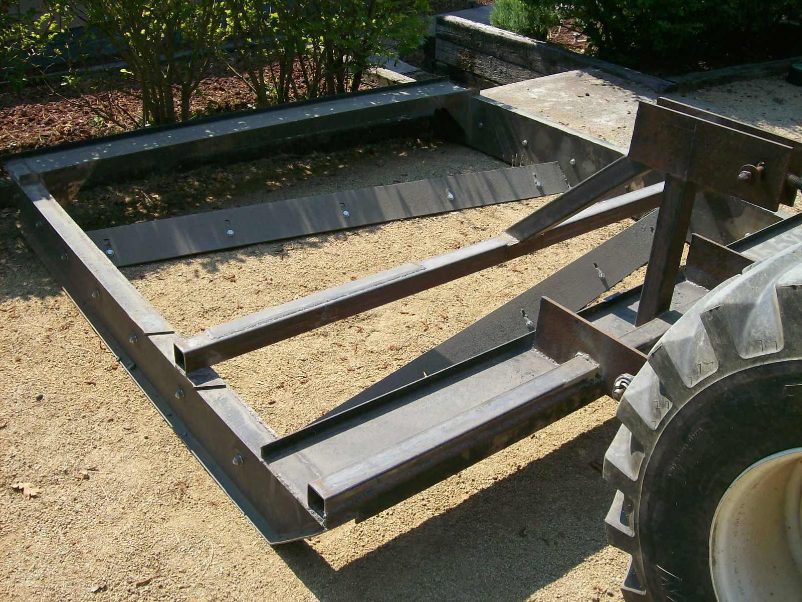

We use 3/4 crushed blue shale on our driveway which somewhat resembles yours , flat to start but goes to 14% grade for last 1/3 of 800+ foot driveway . As noted by others , to much rock without being compacted or rolled , Basically Sucks . Been there , Done That , Just Last Summer .
My blades are angled at 10 degrees with a pitch of 45 .
Old photo's of mine , before completion and after first test run . Added additional bracing , 3 point to back , etc... , just took these after first test before I got to far .
The only way I was able to correct wash boarding in one area that had never experienced problems before , was to scrape off maybe 1/2 a pick up load over about 100' length in trouble spot . Ended up being maybe actually 2 to 2 1/2 bucket loads on my TC 30 of rocked I scraped down and off drive . Problem has not returned since . Truck operator had no gate chains on his truck , thus when he was dumping / spreading and started up the hill , BOOM , rock went from 1.5" / 2" thick to almost 5" . My first passes moved a lot farther uphill , then I moved some all down to the end by highway . Regardless were I spread that other though , it jut ended up being to thick for that given area , So finally it went into the dirt on the side and no issue's since .

Your first paragraph correctly describes what I have. I already talked to the rock man....who has an extremely good reputation in this area....I'm going to talk to him again. But first I need to get some of this gravel spread out. Once spread, I probably will put a 'fine' load on the grade after the culvert.
As to the angle. My 28 front and 55 back is off since it should equal 90. I used an inclinometer app on a smartphone to measure. But...do know the blade is slanted more than your 45....probably more like 35. Would the steeper angle grab more gravel, or less? How far apart are your angle blades? I've pretty much decided I'll drill multiple holes in the mounting plates for the blade supports to give me quarter inch below and above the runners as will as even. And yes, I intend to try and spread this gravel more using different techniques with the TNT.
I don't think changing the angle will have much effect on how much gravel you grab. The land plane skids control the amount of bite you get and will be the determining factor, a rear blade would be a different matter.
My blades are set straight on my land planes for lawn and field leveling. That said I think it is important to have the front blade close enough to the leading edge of the skids that tilting forward allows you to get a bite. I don't have the measurements handy as we speak but will guess about 6 inches of the skids protrude in front of the blade. The blades can be set apart about 24 to 36 inches depending on your design without much issue, I don't see this as a critical dimension. As Gordon mentioned clearance between the cross frame above the blade carriers below is more important. You wan't the material to have plenty of clearance to pass over the blade carriers.
For a home owner build without commercial use and the main focus on your driveway maintenance I would build a simple land plane. With the blades angled and set about 1/4" below the skids or flush. Since the plough bolts are 5/8" size it would be hard to make fine adjustments using multiple holes as these would have to be too far apart on centers vertically. You might also consider building it with the blades lower to try it out and then add the proper thickness of wear strips on the skids to fine tune. My first land plane was built with the blades set 1/4" below the skids, after using it for a few hours I decided to set the blades flush and added the 1/4" wear strips to bring the blades flush.
Planning and research is important but I wouldn't over think this. My thoughts after 5 years of use are that weight is important, having a rigid non flexing frame and having long enough skids are key. I use topntilt to adjust my land plane and it helps a lot.

The blades I have are 8ft long. What's everyone's opinion of making this 8ft wide versus 7ft? It would avoid cutting these which I bet are extremely hard.
Right now, 8ft seems too wide, not for the tractor but for the drive. Actually 6ft would be better for the drive, but need 7ft to cover the tractor tires.
Right now thinking I'll stick to 7ft.
