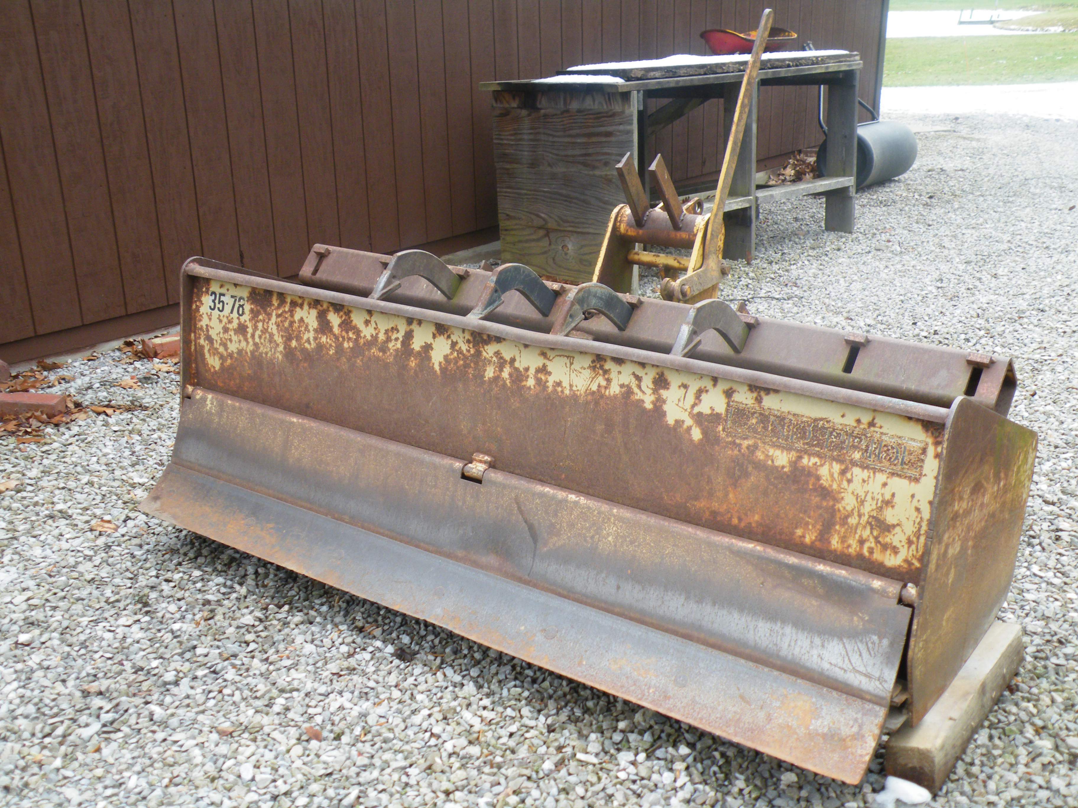

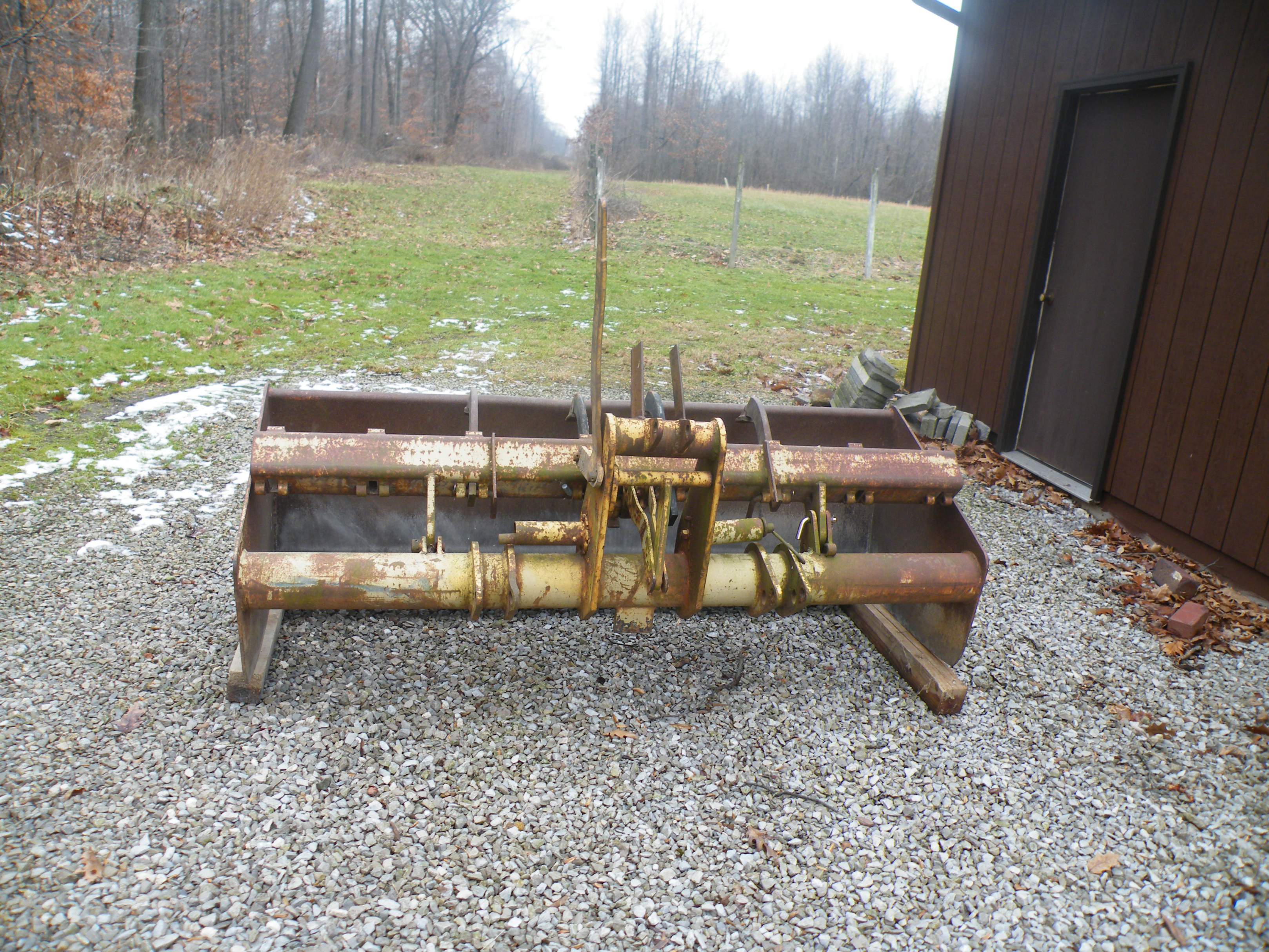

How about a 35 series.
Weight is your friend.

A 25 series will give you good service for a few years.
A 35 series will give you good service for the rest of your life.
It's your choice.
Murph's 35 series as well as my 35 series are very old blades and still function perfectly with no distortion. Yesterday I use my TnT to lower the right corner of mine and hook it under an 8" cedar stump and pull it out of hard clay with my M9540. Probably would have twisted a 25 series doing that.
Post some pics when you make the purchase. You are going to enjoy having this attachment.
