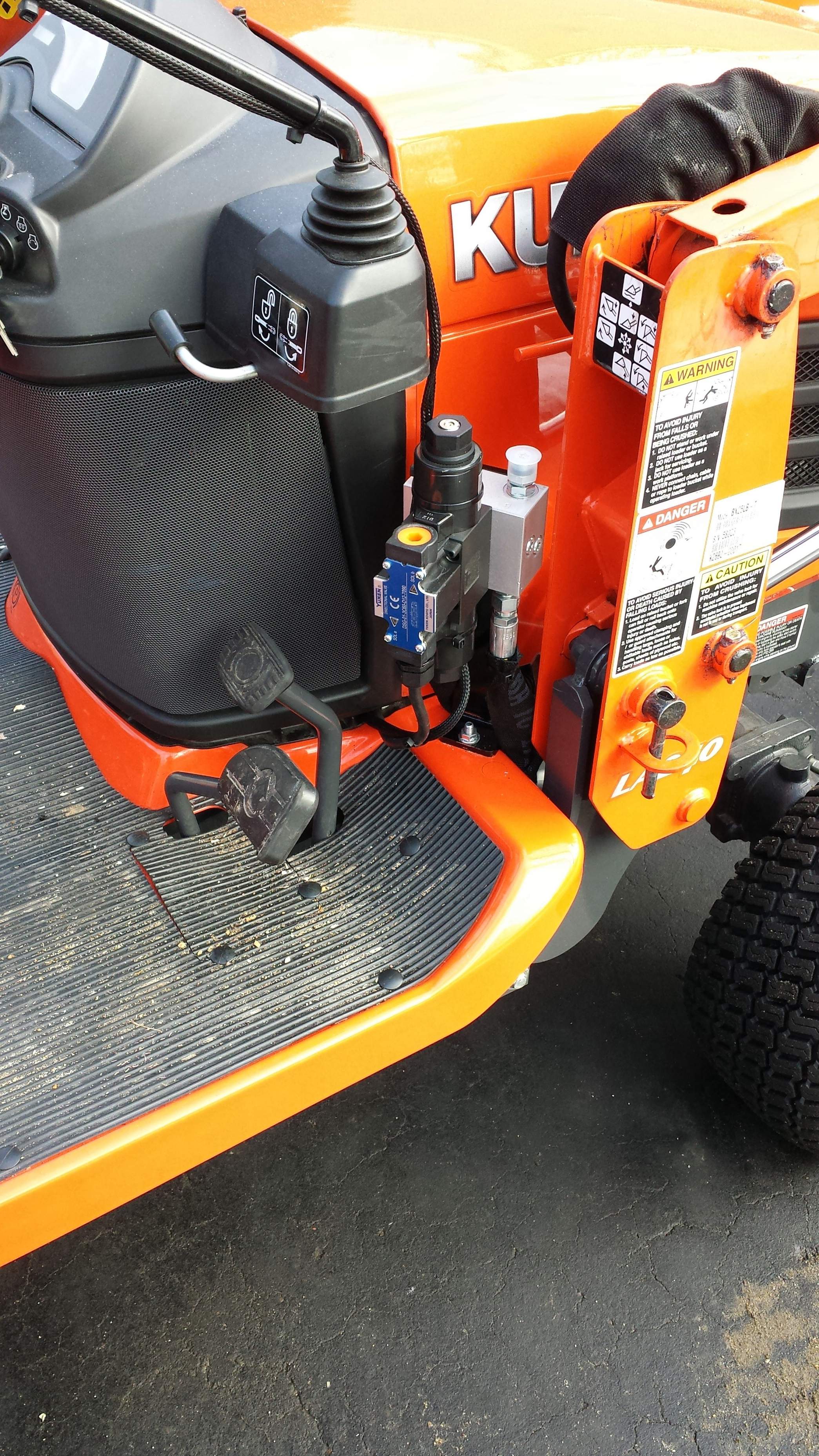

Just a couple quick updates. First off, before I get flack on those zip ties, I did cut off the excess straps tight to the locks. Second, though the instructions don't recommend you remove your FEL before installing the control valve, I would recommend that now that I've installed it. Getting to the nut on the OEM carriage bolt is harder than it looks, plus you'd have more room to maneuver the hoses around the FEL mounts. Third, with the new valve mounted, it will be a little tighter hooking/unhooking the FEL quick connects, but that's a small price to pay given the increased functionality the 3rd function valve provides. I vaguely see a FEL quick-attach snow plow with hydraulic angle in my distant future......

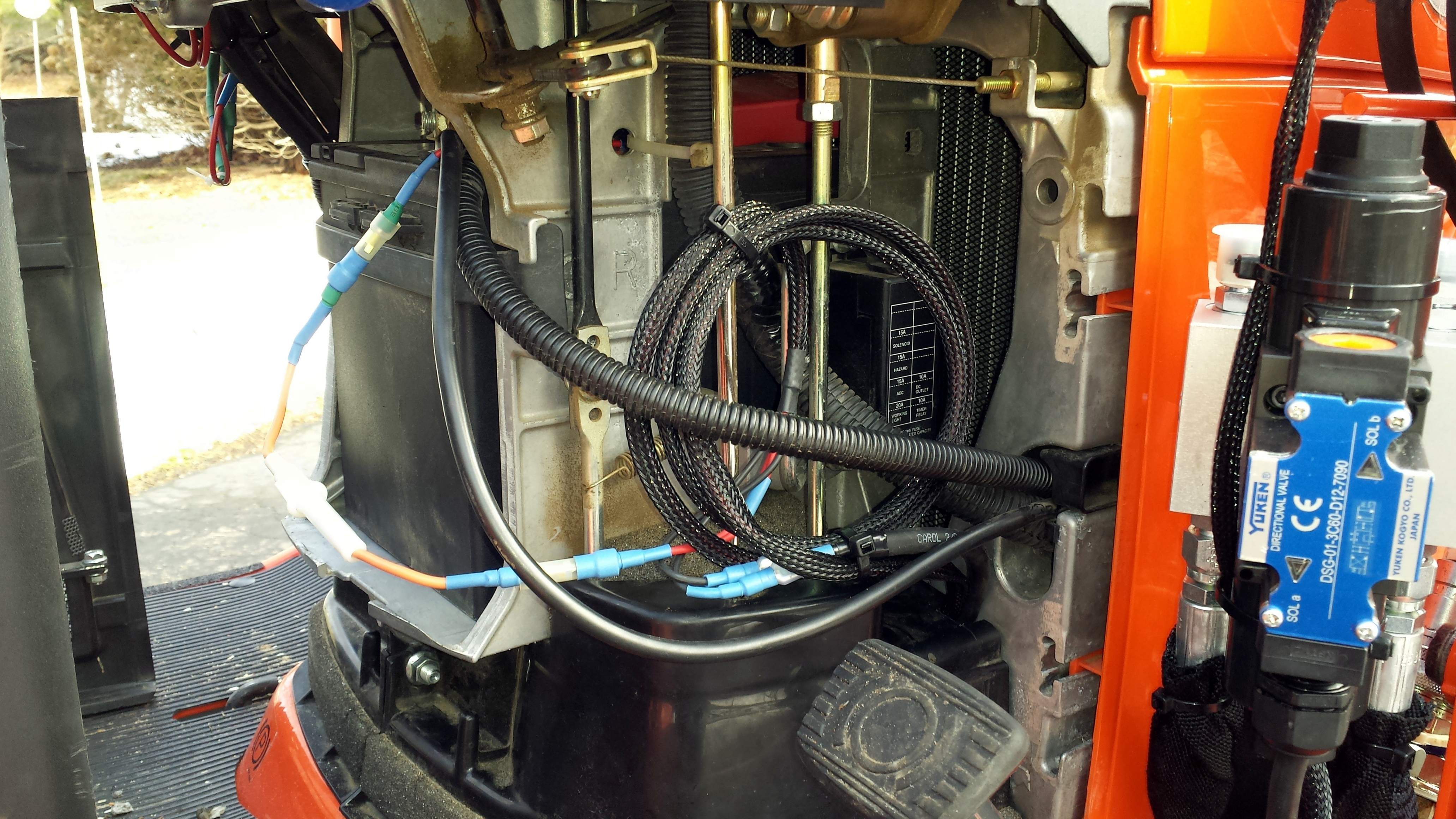

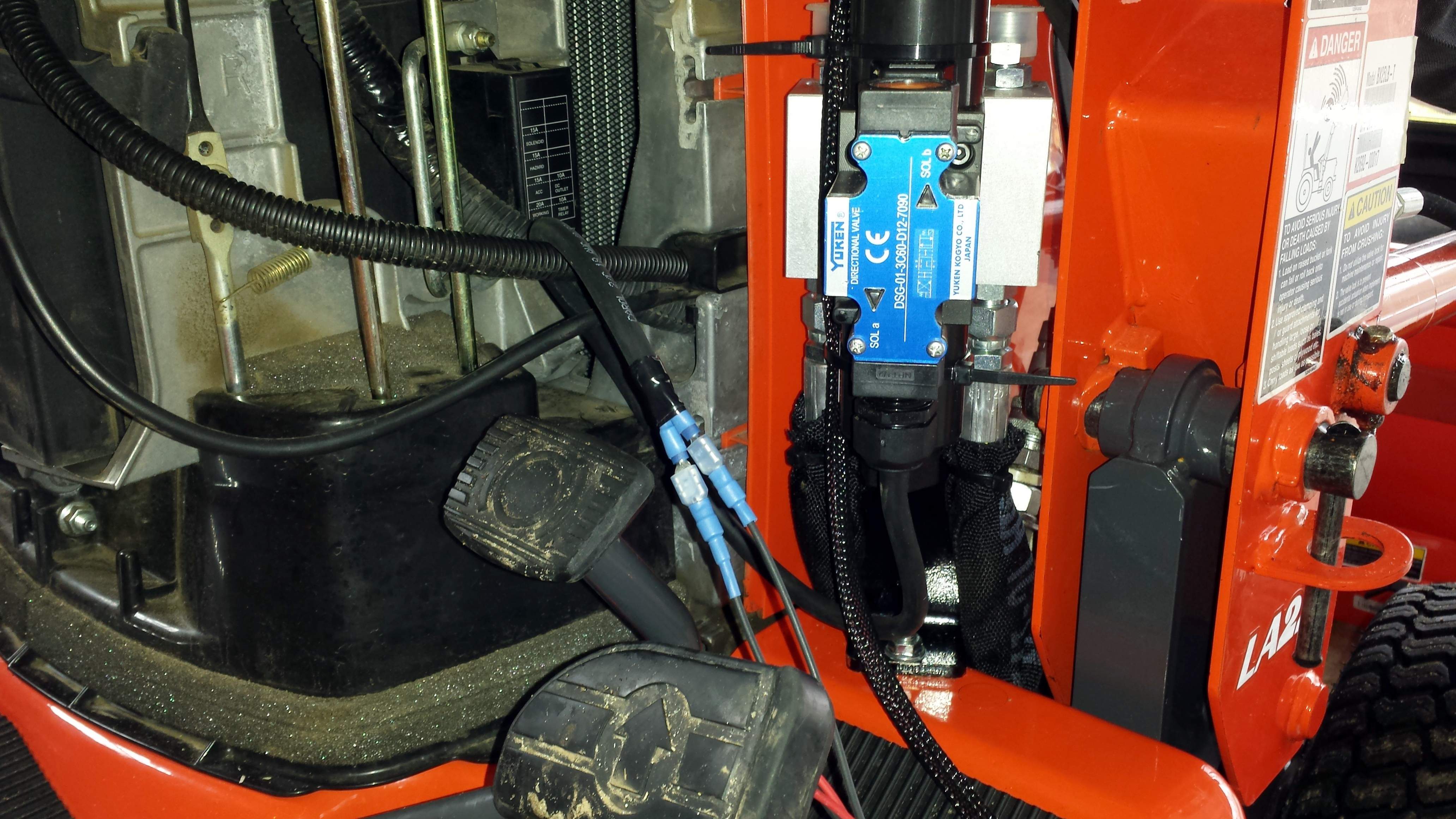

I did hook up the electrical connections yesterday. There a four wires coming from the new joy stick handle, two red and two black. Two wires on the directional valve, one white and one black. The instructions basically tell you to wire the red wires to the battery with the 10 amp fuse in line, and the black wires to the valve. Since it doesn't specify which black wire goes to the white or black wire on the valve, I just wired one to each. I assume the valve is grounded through the mounting bolt since there's no separate ground wire.

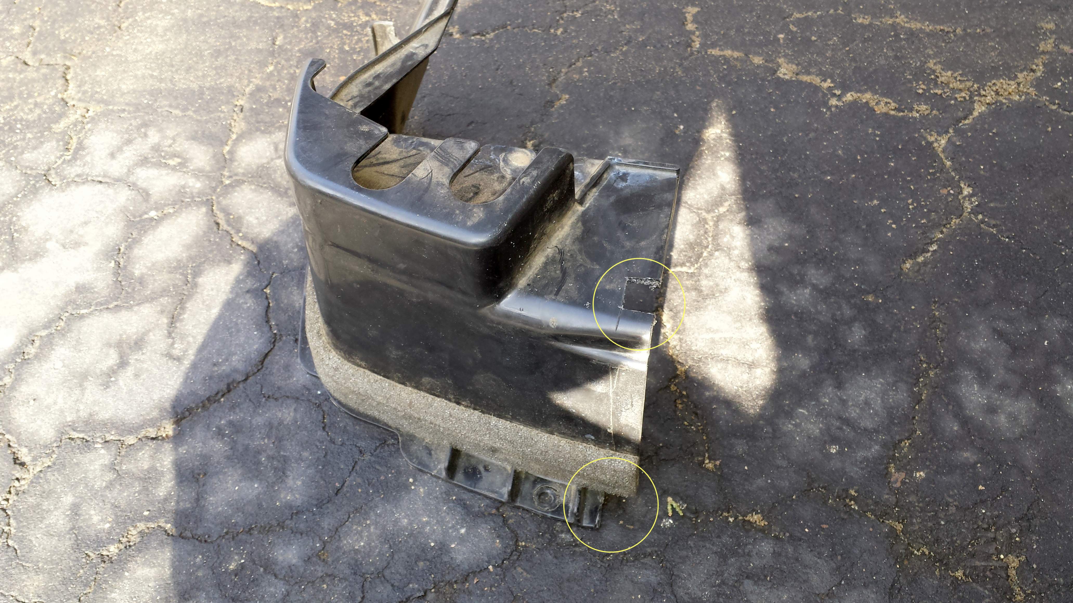

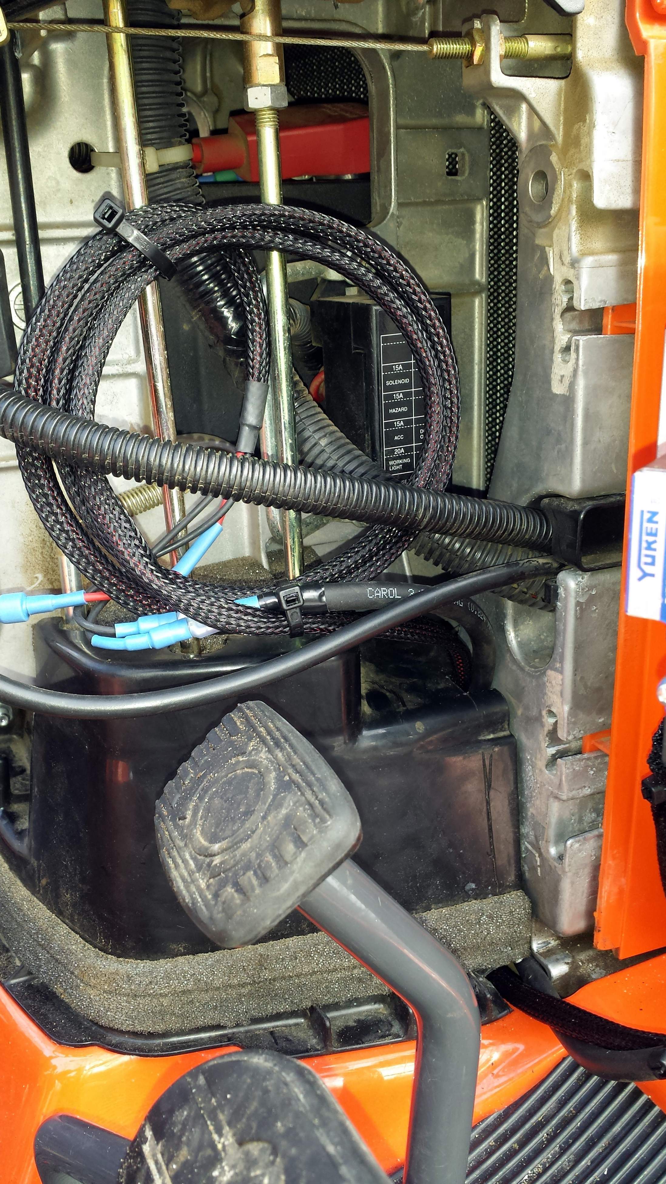

The new joy stick handle comes with a lot more wire than you need, but I decided not to cut any of it and just loom it up under the dash. Biggest issue was figuring out how to run the wires inside the screened cowl that hides the battery and provides air flow to the radiator. My first attempt was a no go. I notched a .5" by .5" cut out at the right edge of the cowl and tried to snake the two wires through there. Didn't work. As I thought about making the notch bigger or moving higher up the cowl, I decided to take a different approach. I noticed a small hole at the bottom right corner of the cowl when installed. There's some space between the cowl and the floor board. Decided to run the wires through that hole after I cut jut a little bit of the corner off the cowl. From there, I than ran the wires up through the plastic "dust cover" (not sure if that's the right term, but see pic's).
I did have to remove the plastic dust cover and make a few notches on it (see pic), but it's hidden behind the cowl and can be removed and replaced without disconnecting the wires. Worked good and the install looks clean from the outside. Just wish I hadn't made that notch in the outside of the cowl to start with. For connectors, I used some spade and bullet connectors I had already. Shrink-wrapped all the connections. Also, I used an in-line fuse holder that I had and not the one that came with the grapple. Just liked it better. So, it's all wired and now just waiting for the final hose connections once my male QC's arrive. For now, I left the fuse out of the holder so I don't accidentally hit one of the joy stick buttons and shoot oil into the air. LOL. I don't see any other way to wire it, but I guess I won't know if it's right until I try to use it. Anyway, again, hope my experiences help future LP grapple owners.
