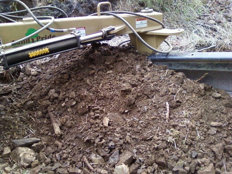

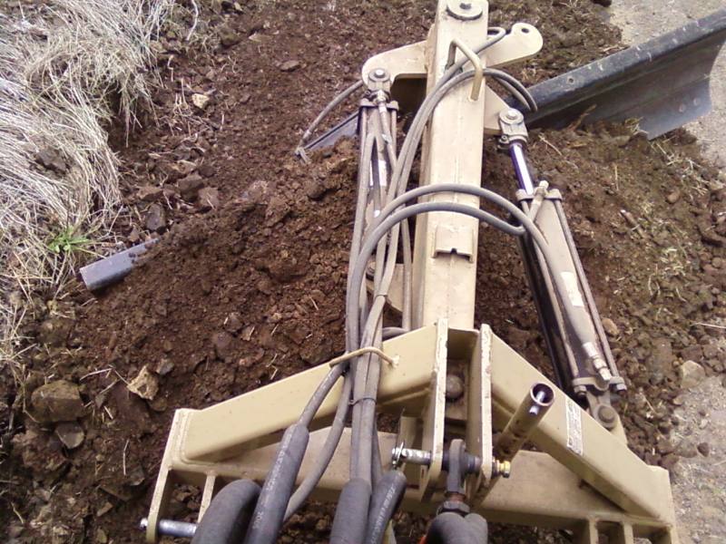

I never updated this thread as one guy asked me to.
I will start off with I love this RBT4096. The three way hydraulics give me infinite on the fly control of all three angles and I use all three sometimes in very small increments adjusting constantly depending upon what I am doing. I can not imagine not having all three hydraulic adjustments and what it would do as far as affecting my productivity and the finesse with which I can adjust without stopping and having to go back and make some incremental 15 degree movement then restarting.
Question as far as would the tractor handle it, loaded up.
I had a lot of concern about that as the RBT4096 was rated for 60-100 hp and I was just under the 60 hp with my year model and at the low end of the range to boot. I figured I would just have to take smaller bites and not so deep at a time. When I took it out I found I was thrilled with how my tractor could load up the blade and still move dirt and rock. I have not yet used it on snow (just drive through it with the equipment and truck) but expect that to be a piece of cake even with the wet and heavy stuff we get. I have used it to repair a logging road that has gone without repair for 11 years. The road that I have worked on is about 4500 feet with a 350 ft rise (a bit over 7% slope), of course there are steeper places and shallower places. I have loaded a couple of pictures of the blade partially loaded. This is on an up hill segment. The tractor has performed so much better with this blade than I ever thought it would. Even with it swung way to the side and angled I have been able to track almost straight with very little side slippage. I have R-4 tires with a lot of weight in them which helps.
