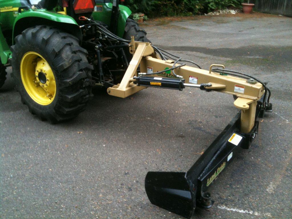

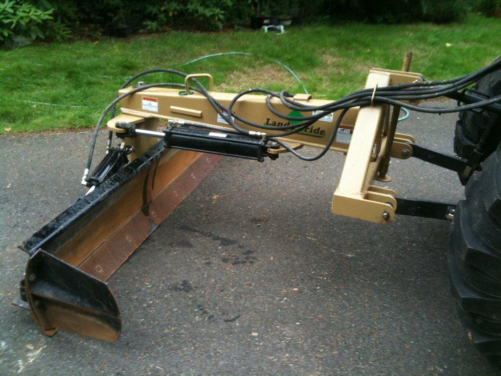

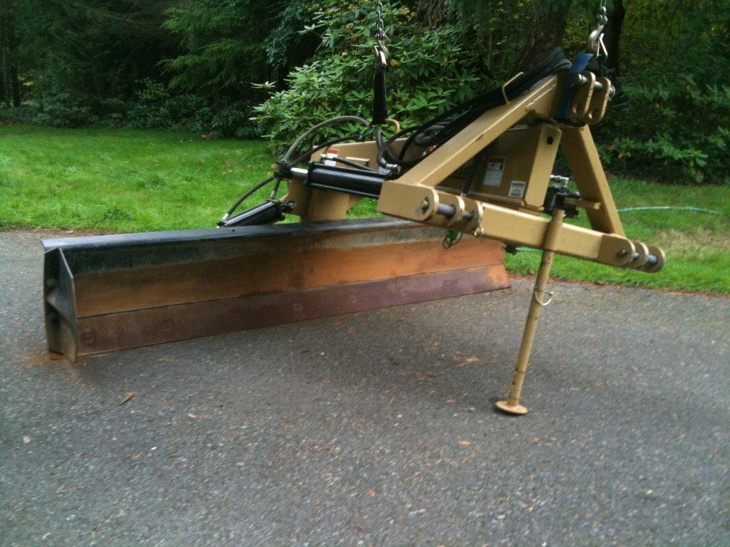

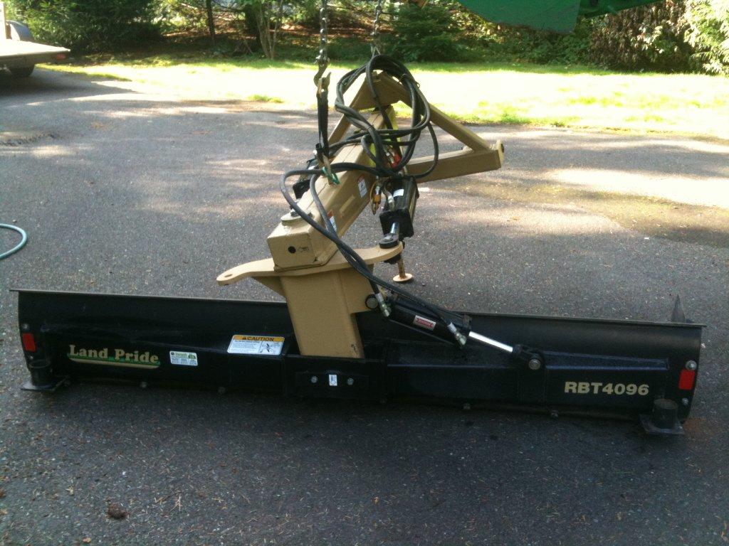

Well I took a look at the RBT4096. The salesman that I had talked to was not there as he had said he would be so I talked to another guy. He told me that they also had a new RBT3596. Went out and took a look at the 3596 and it had two cylinders, manual on the offset. Then looked at the RBT4096 and instead of only the two cylinders (no offset) that I had been told originally, it had all three cylinders. (Surprise) What I wanted anyway. They told me the new RBT3596 with two cylinders was $2550 and the RBT4096 with three cylinders was $2400 firm since it was a consignment sale. Of course the first person on the phone told me $2550 firm due to consignment and only two cylinders so who knows. I think he may have been confused. Anyway they came down on the RBT3596 to $2300 but said they could not move the price on the 4096. It would have cost me another about $350 to add the third cylinder and hose and fittings so I took the more capable and better priced used unit, at $2400 which also included skid shoes and end plates (one of which still had the factory paint, he never put it on just used one) which the 3596 did not have. A $3800 unit new for $2400 with minimal usage.
Very happy with it. Not much wear. The cutting edge does not even have a nick. The moldboard does have some rust but just because the paint got rubbed off. It has been left out in the weather and has some minor pock rust on the frame.
Never dealt with this dealer before but really liked them. Had lots of inventory. They are what my normal dealer was before they went through two different owners. Just wish they were not 2+ hours away in good traffic and 3+ in busy traffic
The pictures you asked for were as I unloaded it and then after hook up. It was a pretty good deal I think.

Thank you for posting the pictures. You got yourself a very nice blade for a good price. :thumbsup: Very annoying when you talk to someone on the phone and get one story and then go in person and get another. At least it worked out for the better for you. :cool2: Now all you need is a hydraulic top link so that you can really pick that blade up for transport.
I sure would like to come across a deal like you got on an RBT3584. Oh well, someday. :drool:

You did good on your purchase, and those end plates will make your life easier when it comes controlling where the spoils go.
Just make sure to raise the parking stand before doing any work! Don't ask me how I know.

It looks like you got a great deal. I only fantasize about using such implements as I run a JD 2305 and I would just LOVE to be able to control my little blade with hydraulics (or electric worm drives, or hamsters or ANYTHING other than manual adjustments. I did have one thought that might account for the rather high HP stated for proper operation. Your blade certainly looks like a fine piece of equipment, but it also looks like it sticks WAAY out behind your tractor. That extra distance combined with the added weight just might make the tractor difficult to control as the rear blade sinks into earth, especially when the blade gets angled. Mind you, this is only one thought and it might well be incorrect, but I too have looked at that very same blade (while dreaming of owning a larger tractor) and wondered why the HP requirements seemed so high for a blade that appears to be functionally near identical to its barely smaller cousin, the RBT 35. I am just guessing, but would you let us know how your tractor (I think it will work just fine personally, but then again, what do I know) works when the blade is engaged.
