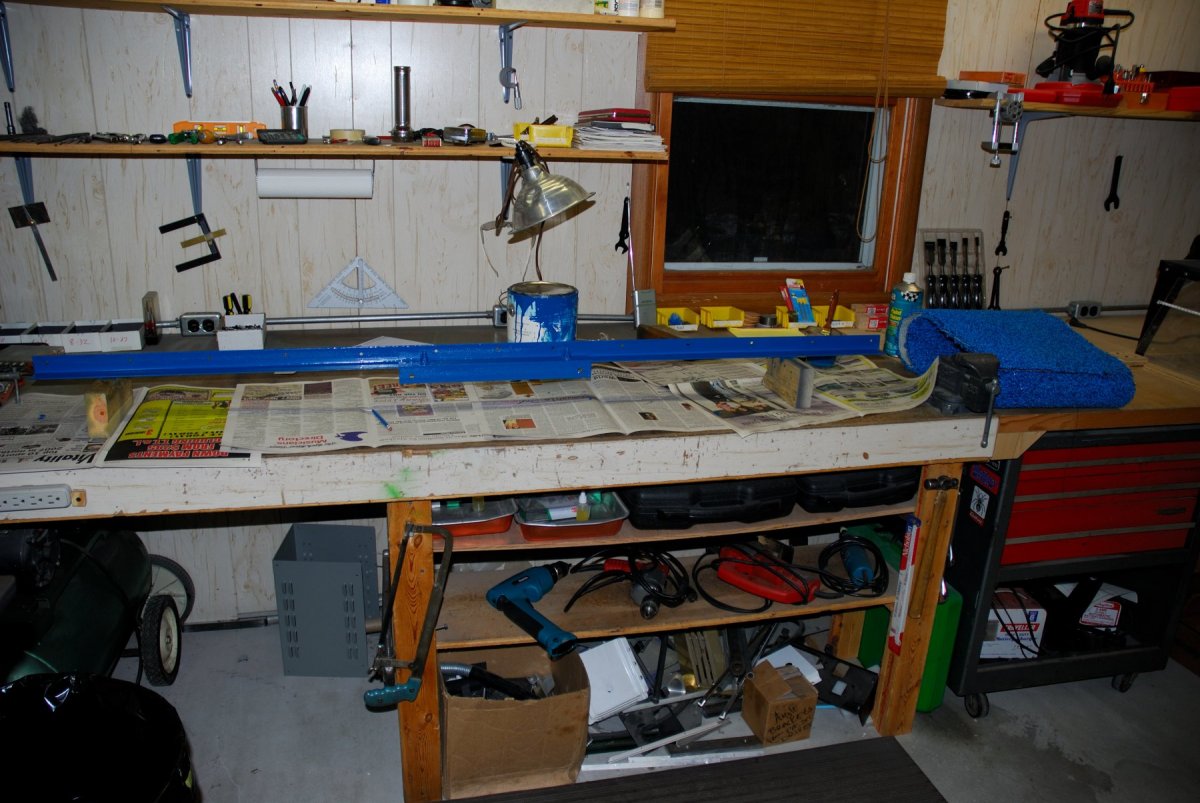

Dirt: I build the bracket to hold the carpet today. I will mount it to the 16" square tube that holds the tines with two 3/8 bolts. The carpet is cut and sitting to the left side. I plan on keeping it almost to the ground. I can always shorten it. I will mount the carpet with 13 1/4-20 bolts and large washers.
I happened to think I won't be able to see the bottom of the rake now. I wonder if that will make it more difficult to do grading. Has this been an issue for you?
I just had another thought. I have some heavy duty stainless screen I could try too. I could see through that a bit. I'll try the carpet first. Won't know till spring now.

ccsial,that carpet is a perfect match for FORD BLUE. It will look really nice.
As far as not being able to see the rake..............I guess it would depend what task you are doing with it. I don't need to see the tines when I am grading the road or snow removal. I've done that so many times I can do it by sound and feel alone. If you find you need to see the tines, just roll it up and bungee the carpet out of your way as I suggested in an earlier post. I think you will find that even though it blocks your view of the tines, you will get use to that and still be able to do the same quality work whether you can see the tines or not.
