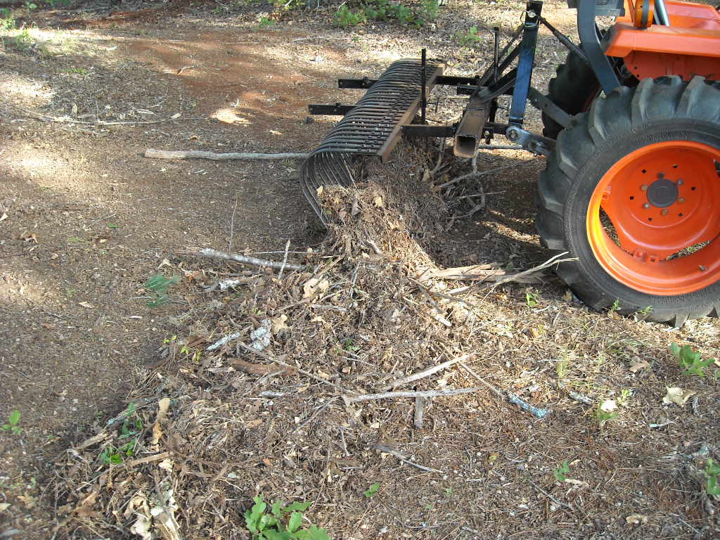

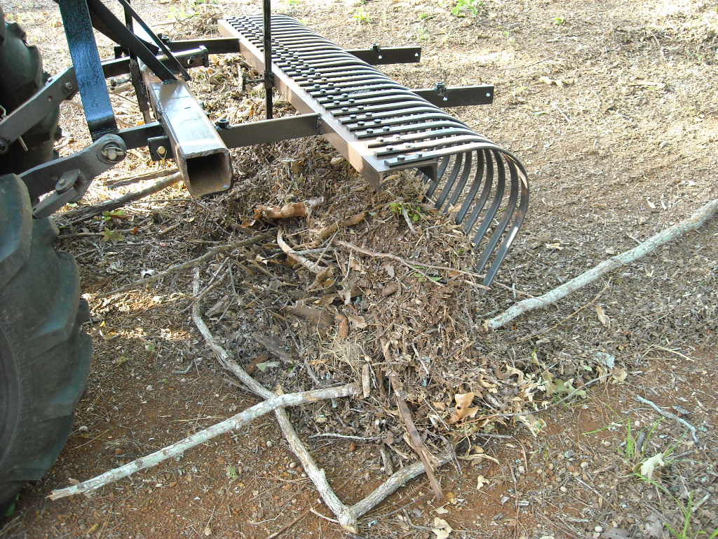

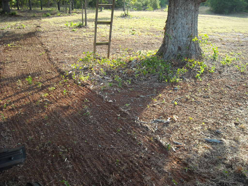

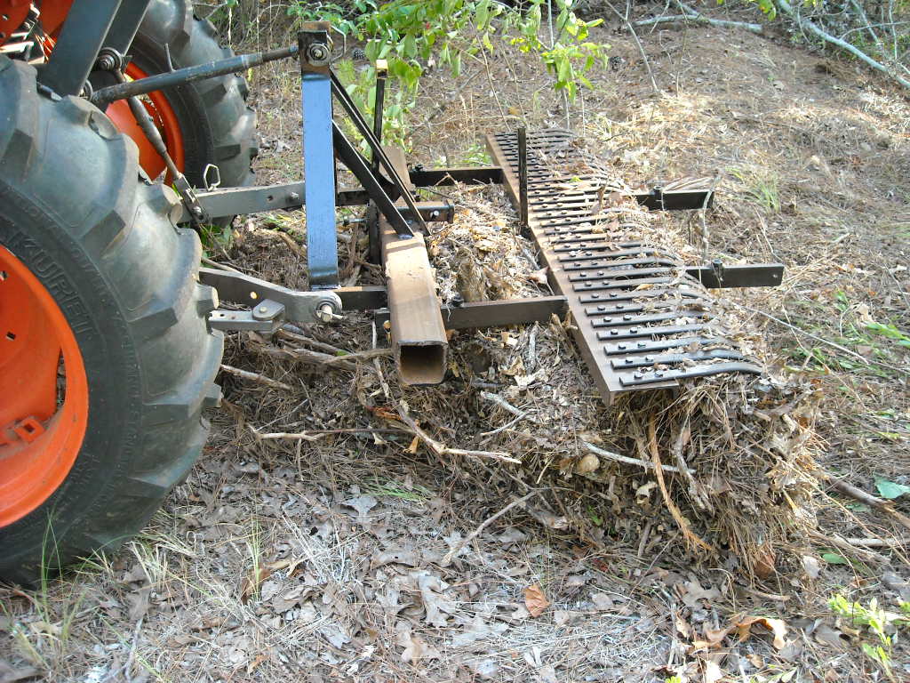

These rakes don't "dig" that well....being springy and all. They will move around some loose dirt but that's about it.
Mine just floats on the ground and I make a few passes. It's a lightweight to because it's homemade.n It's a really neat tool!
Good Luck,
Rob
