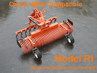

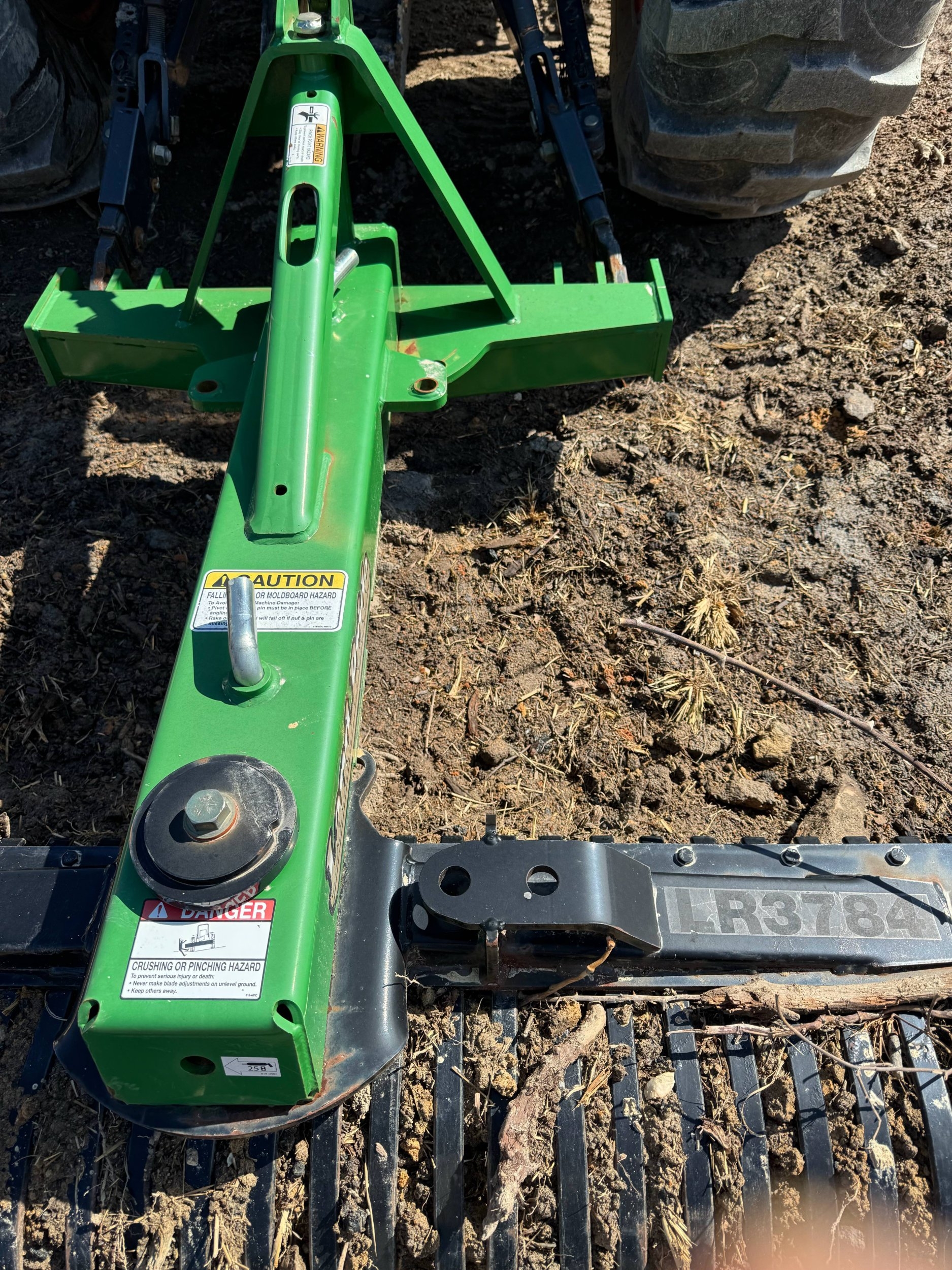

I like the kick stand on that one. It looks well made and is fitted with mounts for a cylinder to change the angle of the blade. I added a cylinder to mine for that function. Being able to change the angle from the seat is a game changer for rake operation.
I rake mostly fist size rocks off the surface here by windrowing them for removal from cleared areas, horse pastures and such.
Yes, you could add a hydraulic to it

I busted up two "light duty" landscape rakes while maintaining my mile long private road. I finally spent the extra $$ and bought a York rake with scarifier, gauge wheels and drop down grader blade. Except for tire replacement, It's been trouble free for 20 years now.

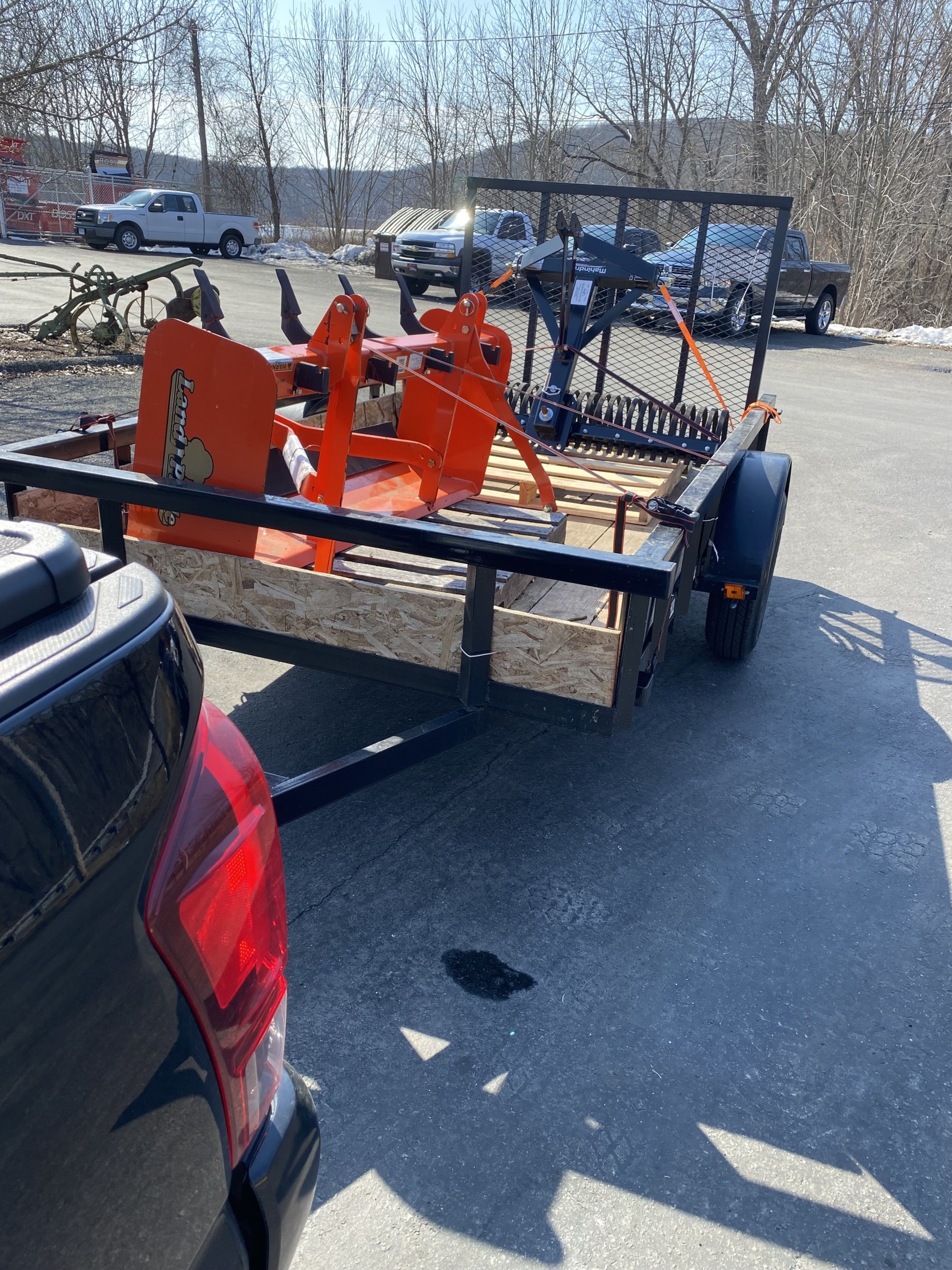

I ended up going with the 5ft Mahindra rake. Got it for $850, after tax $900. The price was right and it had a good weight to it. Also picked up a 54” (BB1254) Landpride box blade. Had some paint scuffed up and wasn’t assembled. The dealer took $250 off and threw in a can of paint.

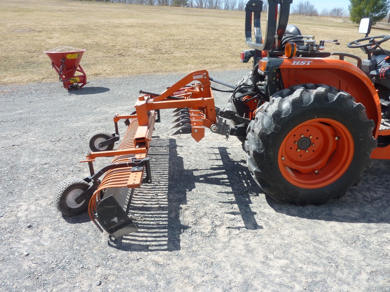

Once in awhile, if I have the gauge wheels fully lowered, the 3pt hitch won't raise the rake enough to clear debris on the ground. I considered making brackets to extend the gauge wheels farther to the rear so they would rotate 360 degrees. Instead, I installed a T&T kit which solves the problem.

View attachment 854657 View attachment 854656
I wonder if set so one pulled it with the tines reversed if it would break up manure clumps.
