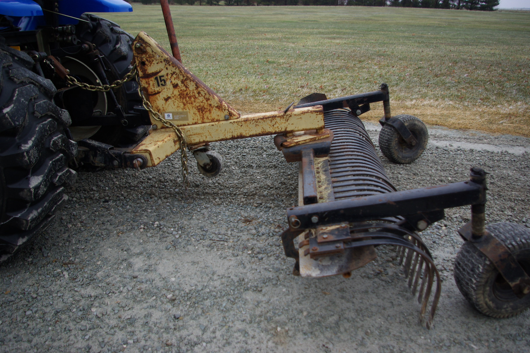

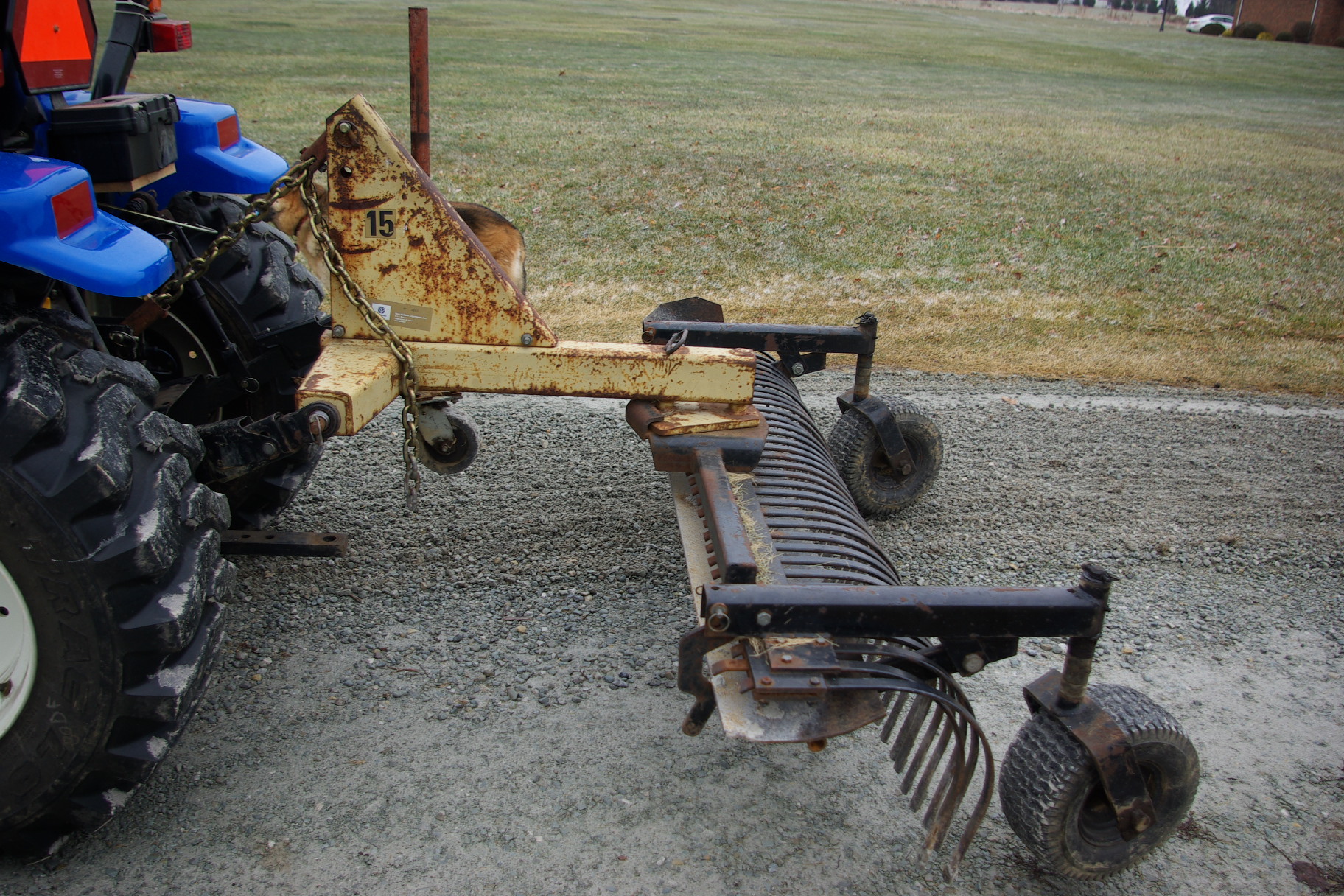

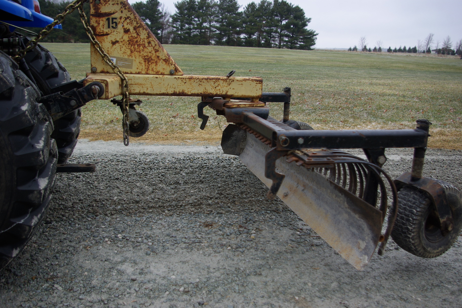

I have just under 1/2 mile to maintain.
I started out with a 5' box blade. 6' rear blade and a 6' rake.
Unhappy with all this I sold it all and bought a 7'' rake.
Added a adjustable set of gauge wheels and am really pleased.
I make a pass on each side with the rake tilted down on the outside and forward a hole to send extra to the center of the road.
This gives me a slight burm of gravel left on the outside which helps deflect the rain water from flowing into the roadway and a burm of gravel in the center.
Last pass is right down the middle with the blade set straight and no tilt. Leaves a nice 7" roadway with another slight burm on the outsides of the blade to again defer water runoff into the road.I do this twice a year to redress it as well to help level it out and fill in low spots.
I dont use any extra weight on the blade and set the wheels so the blade cuts about an inch into the road. The weight of the scraped rock keeps the blade solid into the ground.
My secret here is to set my tractor speed t just a crawl and works (for me ) beautifully.
And am very happy to only need one implement.
As far as loosing fines in the gravel.... by running very slowly and adding all the year's windfall of small branches and leaves it leaves a nice firm roadway.
And yes I too have a couple of really steep areas that were a challenge. My first climb into the property before I started I had to put my pickup into 4WD to make the curve. With a creative mixture of native materials its a lot easier and smoother now.

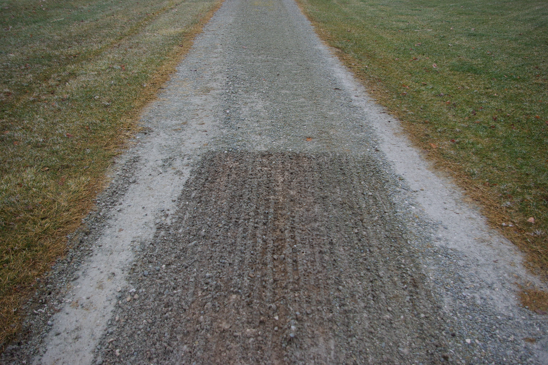

That all makes sense...I thought that might be what you mean, because I've had the same experience. I used #34 for my base...they are pretty big. This was done with the intent of adding crusher run after the construction trucks are finished because they will be pretty hard on the road. When I put the rock down, my dump truck operators had varying degrees of skill...I made sure they set the chains the same on each truck, but some drove slower than others, so in some places the rock is a little too thick. Not a bad thing really, as a good base will prevent wash outs. But in the areas where the rock is thick, the rock is also a little loose. So, funny, like you, I did the same thing where the rock was to deep: "On my really bad areas I would load the tractor bucket with dry topsoil and "fling" the dirt "a shovel full at a time" spraying it out by hand." Within six months, the dirt washed into the voids and disappeared from view. And each fall the leaves help too...their organic matter does act like a binder to help stabilize it so you don't spin out. I haven't compacted it yet except with a Cat 953, but that's not optimal because the tracks spread the weight so well. With time its getting better...every drive over it compacts it further. The road has held up REALLY well. We just had the storm of the century...my 80 year old farmer neighbor says its the most rain he's seen in his life. We didn't have any washout or erosion so I'm quite pleased. I wonder if a rake could handle my big #34 rock?
Here's a photo of the curved area not long after the rock was dropped. When I built the road, we cut into the bank to keep the curve wide (we actually brought logging trucks up and down this road). After the logging was done, I brought in 75 tandem loads of dirt to build the road up to the top of the bank cut to get rid of this ugly "cut" area, and to reduce the grade. I got the dirt for free, but had to pay for the trucks and loader. The road is about 12-15' wide. Its crowned everywhere except in the curves where I sheet flow water so it doesn't run down the outside edge of the curve (which would cause a ditch to form over time). No ditches anywhere...water is drained using broad gentle slopes away from the road, with 10-20' wide turnouts to get rid of accumulated water.
