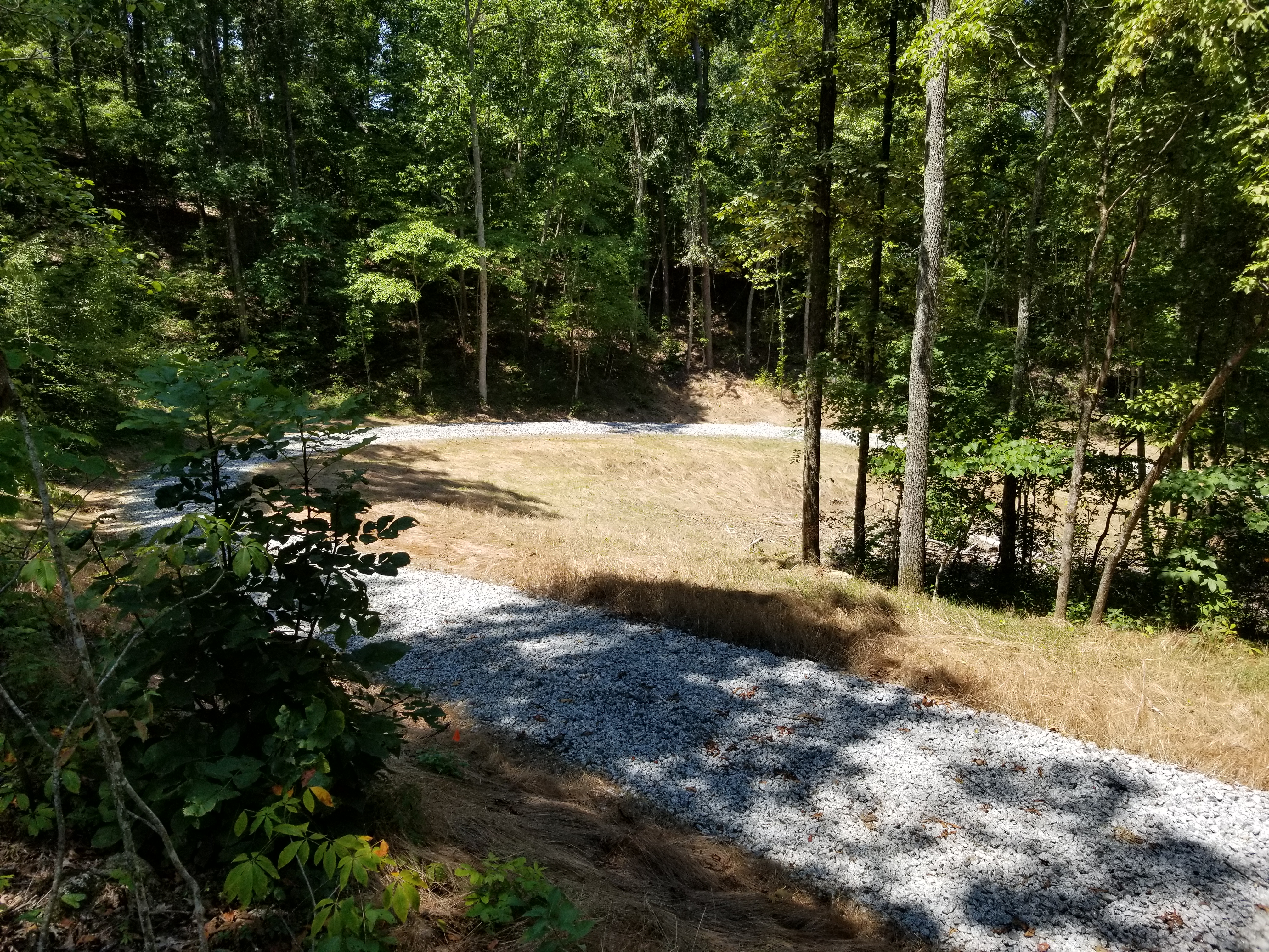

Here's a photo of the curved area not long after the rock was dropped. When I built the road, we cut into the bank to keep the curve wide (we actually brought logging trucks up and down this road). After the logging was done, I brought in 75 tandem loads of dirt to build the road up to the top of the bank cut to get rid of this ugly "cut" area, and to reduce the grade. I got the dirt for free, but had to pay for the trucks and loader. The road is about 12-15' wide. Its crowned everywhere except in the curves where I sheet flow water so it doesn't run down the outside edge of the curve (which would cause a ditch to form over time). No ditches anywhere...water is drained using broad gentle slopes away from the road, with 10-20' wide turnouts to get rid of accumulated water.
20.jpg View attachment 585368

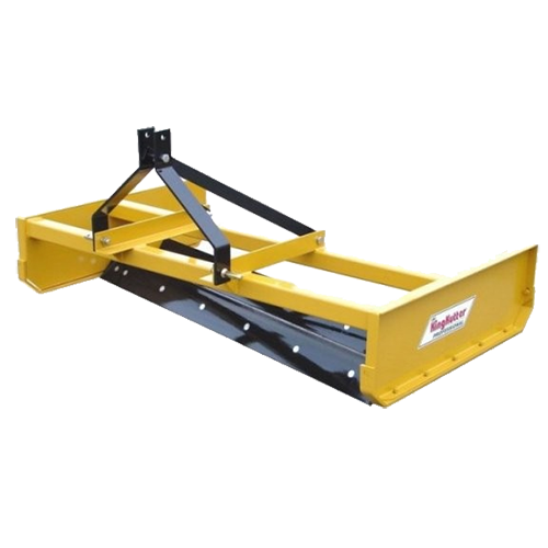

DEG-72.png check out this option.
