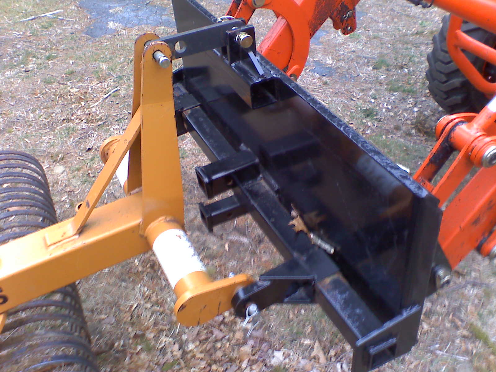

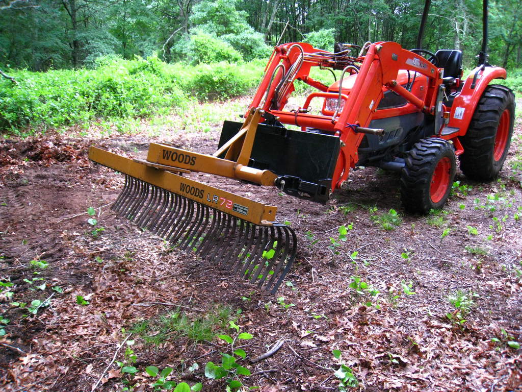

I bought a new ETA rake without the wheels. I have i a quick hitch with an adapter plate welded to it so i take my bucket off and use the rake in front of the tractor in reverse. Works pretty good.
I do the same with a front mounted 3PT. Very convenient and more precise control for small areas compared to tradional rear mount. However, I managed to bend the rake last weekend by catching it on an unseen stump.
Farmerbuck and Island, those are great ideas for front mounting the rake. I'd like to do the same. Do you have a photo showing more detail of the adapter plate?

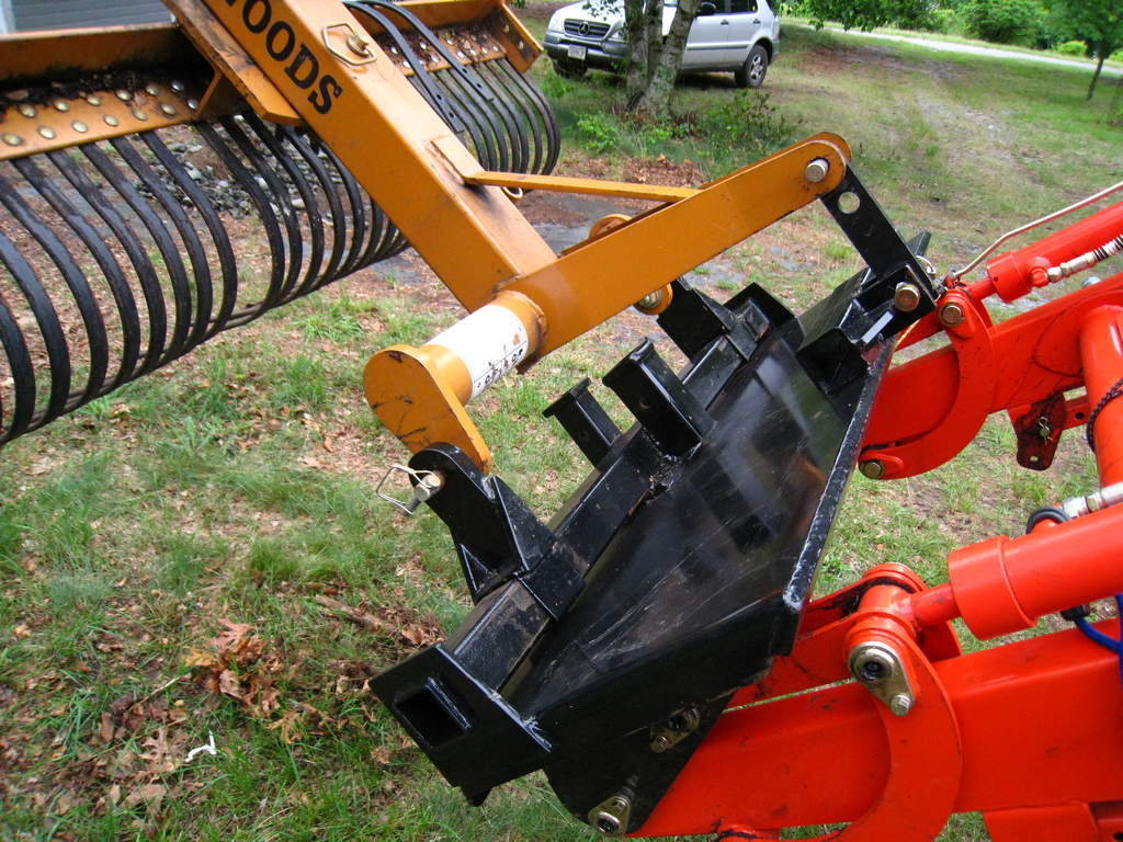

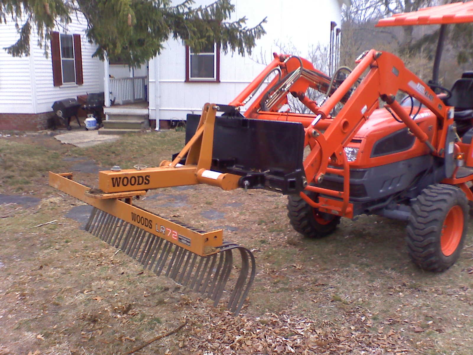

Mine is commercial. Got it from Rick Wallace a few years ago. Don't recall the price but reasonable maybe in the 200-300 range max.

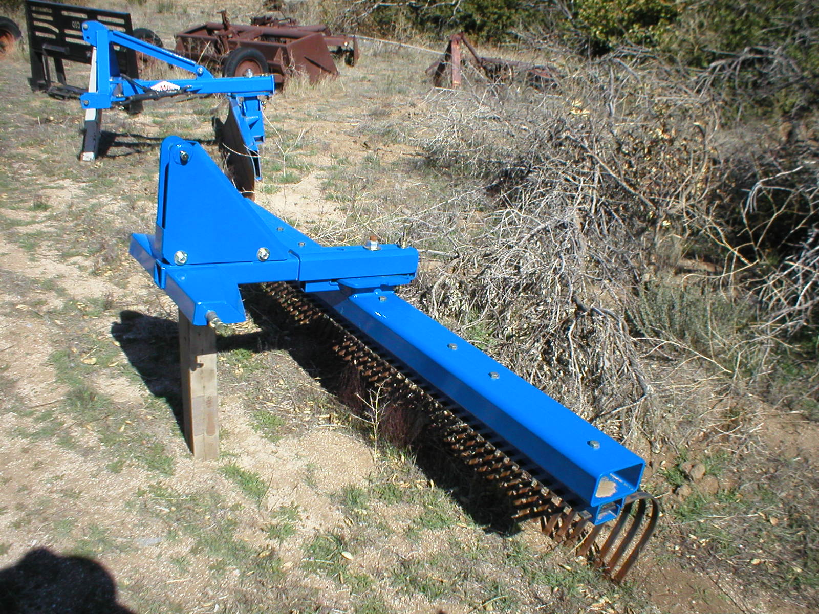

I didn't know those were available. I wonder how long it would take to drill about 72 holes in 3/8 though.
The heavier duty rakes seem to use box rather than angle. I'd guess that would be the way to go.
My original rake used 1/4" channel to hold the tines. It literally became a churro (twisted). I ended up getting new channel and then mounted the channel onto a 3/8" 4"x7" tube. Of course that has led to the cat1 hitch frame not being sturdy enough. I am going to change the hitch frame over to a cat1-2 and have it with an offset-able boom and hydraulic angle. All the stuff is at the shop, I just need to DO IT!
Thanks Island. That is great and I'll likely get one built. I see your rake has the feature I wish mine had, i.e. it is reversible so you can push with it.
I'll download the photos for future reference.
Thanks again.
