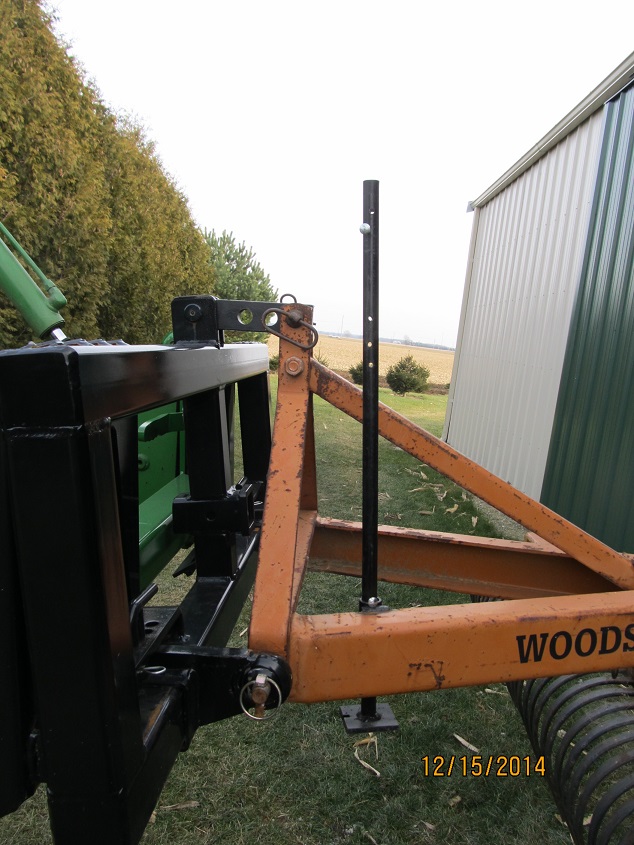

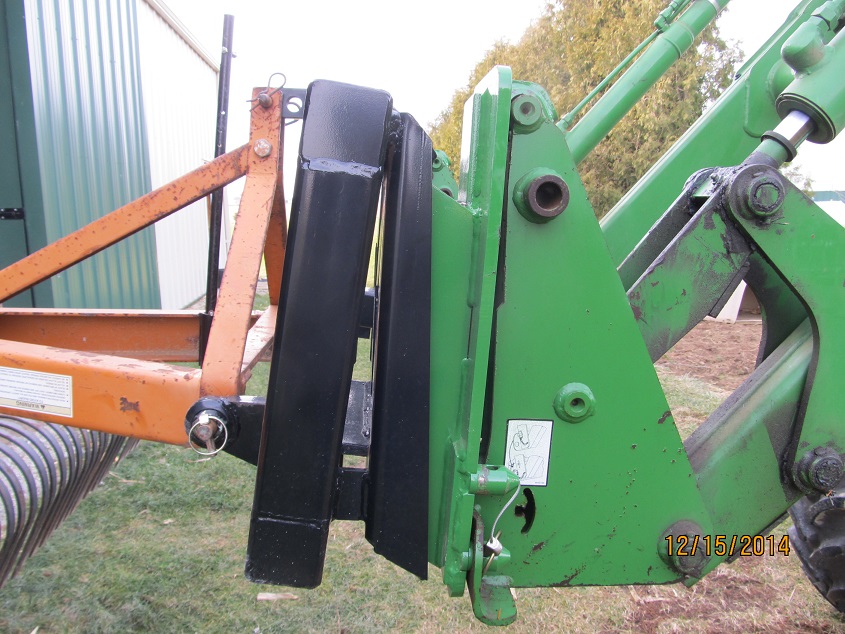

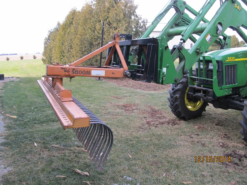

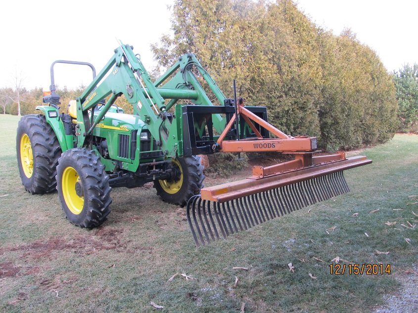

Here's a photo of my landscape rake snow plow. It's a closely guarded secret that a rake will often plow better than a blade. Since my part of Ohio doesn't get much snow anyway, the rake is perfect since I already have one and yet don't have a plow blade or snowblower. It's perfect because I can use what I have..
I adapted my quicktch JD loader over to a skid steer mount with an adapter made by an Amish shop. They did a great job and I needed the SSQA for a tree shovel I have. More on that in a minute.
Off the SSQA adaptor I got a 3 point adaptor I need for using a platform on my loader. So it's only natural to use what I already have to hook up my 8 ft rake onto the front of my loader. I won't know until it snows but I think it will work fine since a rake already plows great in the 3 point arrangement. Here are the pics.

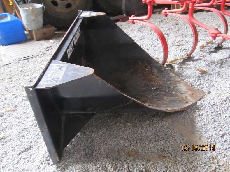

All this started because I bought this tree shovel at an auction. It's a SSQA mount and it's something I really need to move small trees and rocks in landscape applications. Anyway, here's a picture of that shovel and it works great.

/ Landscape rake snow plow #2
Plowing snow with a landscape rake.....
I'd like to see that.
It works great for most snow. Lots of old threads on it.
In fact, when I lived north of Bangor, I plowed lot of fluffier snow with it in 3pt hitch arrangement.

Where did you find one of the rare SᗡOOM rakes? (2nd photo, post 1)
Bruce
Bruce
Very observant. That is indeed a rare one bought at auction. I have seen other things with one upside down decal and figured it was either a "second" or a moron on the assembly line. Works the same as with two upright decals so I'm OK with it.

My only concern if tine dig in,other than that good idea.
