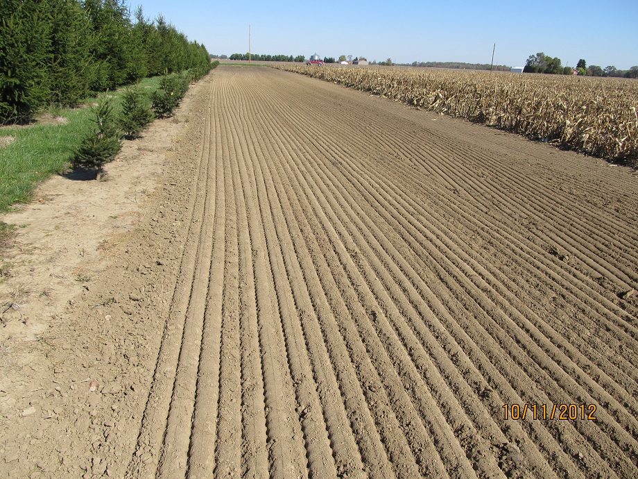

After the ground is tilled and packed with a very heavy packer, it's still soft in the sense it's not rock hard. Here's a photo attached of very hard ground that was tilled and then packed. It's soft now but will firm up a lot after a rain. Yet it's not hard in absolute sense. It's "soft" as it sandy, even though it's clay but it's not "hard" as the ground on the left. This arragement would look very similar in softness/hardness to most arenas I have seen over the years. I'm not that versed with horses and behavior and while I owned one in the past, she always left me baffled.
A lot of this is subjective and my personal opinion is based on experience over the years on stuff I learned the hard way. This is an art form as opposed to a science so it will take a while to figure out what you want. I could teach my method but it would take 25 hours and then could be challenged by someone else with a he-said, she said kind of thing. Don't buy anything until you think it out. The $$ will still be there and you'll make fewer mistakes. You'll still make them, just less of them.
