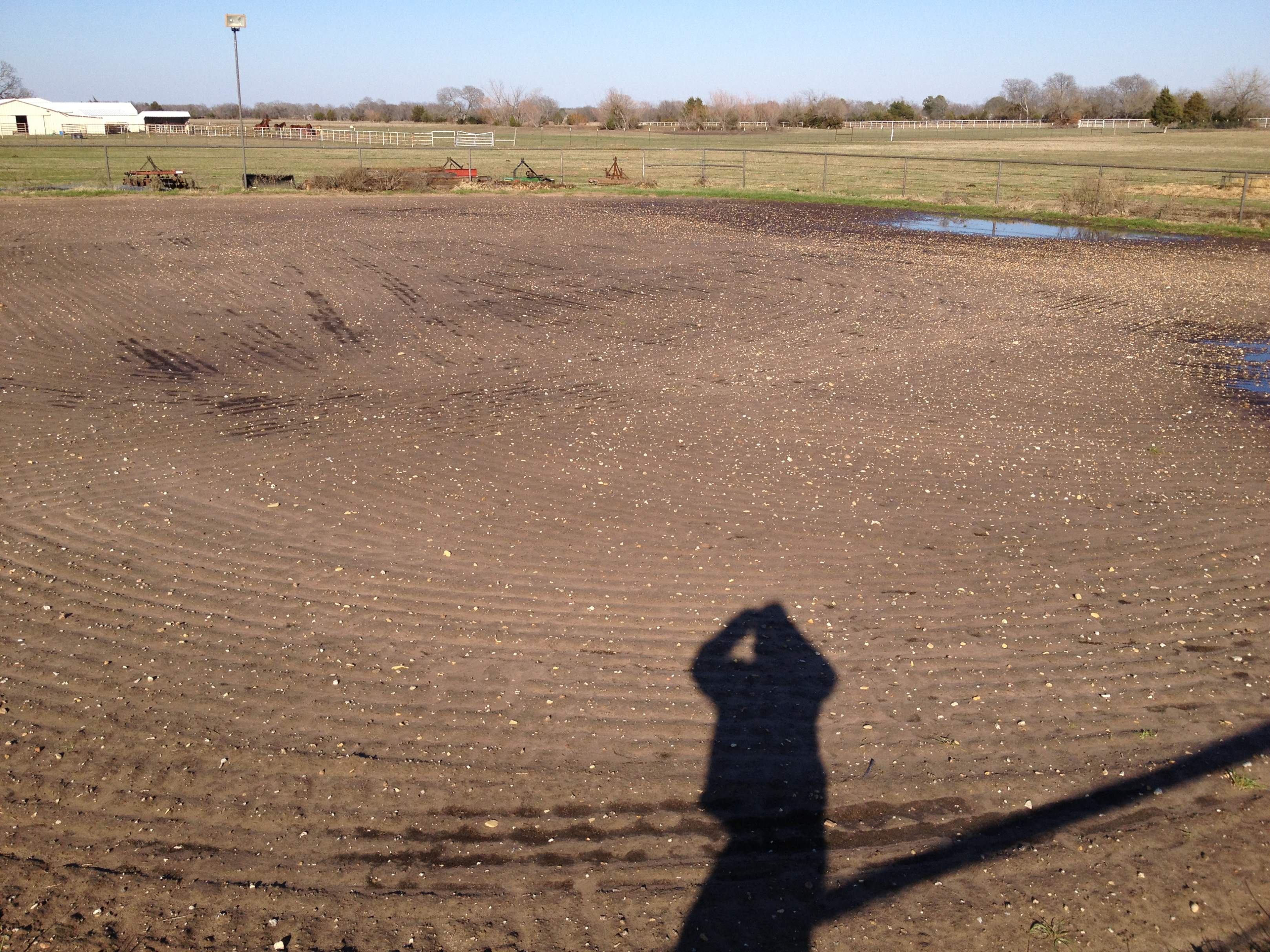

I have a riding arena that I decided to restore to its original purpose,( previously used as part of my rotational grazing program:thumbsup: ) I disc'ed and drug the arena and much to my surprise the base is rocky dirt. When we get a good rain it really exposes the amount of rock in the soil. Other areas of my property are not this rocky, maybe the previous owner was planning on making a solid base and bringing in sand to spread over the semi-rock base. Unfortunately I cant purchase that much sand right now and I need to get the majority of the rocks removed from the arena. When I drag the arena it makes the arena somewhat useable but Im nervous to really work my horse hard when all this rock is present. Is adding rock a standard practice to help with erosion control? As the title says is a landscape rake the best option for rock removal? Most of the rocks are the round smooth style. Here's a pic to give you guys an idea of what Im dealing with. Before people start posting.....Yes Im aware of the low spots throughout the arena, I know I need to work on my dragging skills.:D

When you said rocks I thought you meant ROCKS. For the stones you have a york rake would bring some along to gather and be easier to pick. Around here frost will bring them to the top if not this year but next so it can be frustrating because you can pick nearly every year. They would still surface even to put sand across the top of the field. To rent a powered rock rake once a year might be your best choice.
/ Landscape Rake the Best Option? #3
I would use a harley rake to windrow and pick up the piles. I deal with this sized stones all the time with a hand rake too, raking circles into piles to pick up.

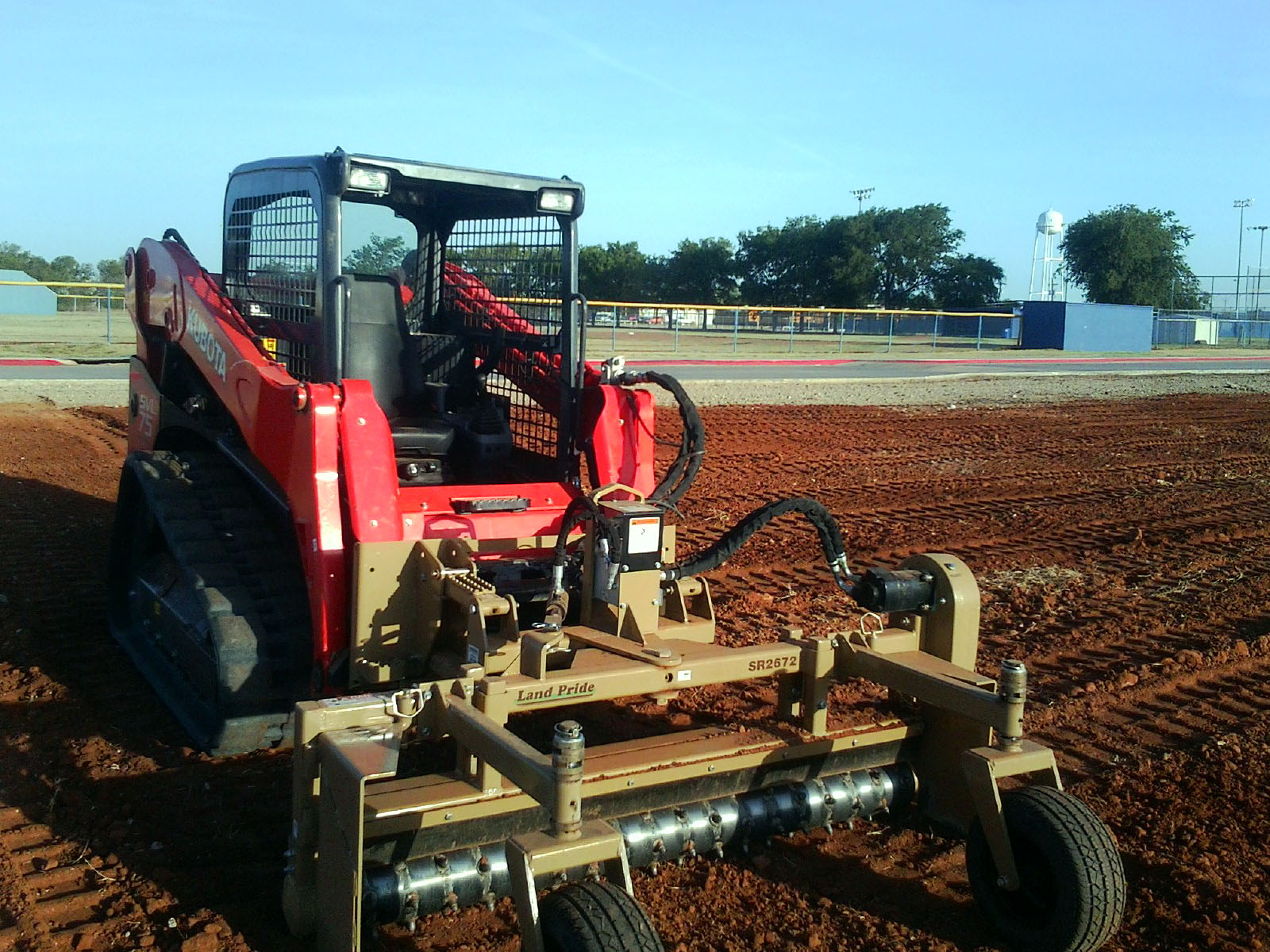

I'll second that idea. Here's a power (Harley) rake mounted on a CTL, but you should be able to find a pto powered unit for your tractor for rent.

thanks for the pic rdrancher...I may see what it cost to rent one. Does it remove rock or embed it into the soil? Reason I ask is b/c I see a little rock content in the pic. Obviously I have never used one but I dont want to rent one and be disappointed with the results.
/ Landscape Rake the Best Option? #11
When you run the Harley rake the rotating spiked drums are angled and they walk the rocks to the trailling edge leaving them in a small windrow. you can make another pass on the opposite side and add to the windrow. You wind up with a windrow to pick up every 10 to 12 of width so it eliminates alot of raking. For areas that don't require it to be quite as rock free you can double up the windrows again and leave less piles to clean up.

The answer is not to rake them at all. Bury them with a rototller. I do it all the time.
On a lawn I helped a neighbor with there were lots of smaller than a baseball sized rocks around and the neighbor was determined to pick them up. I came in and rototilled it and he couldn't find a one of them. I then pulled a heavy Brillion packer (8 ft wide @3,000 lbs) over it and flattened things out to settle it and push any marginal rocks below grade. That part is a must or all the rocks will surface again. After a couple rains a few rocks came up and we picked those up by hand.
I use a rock rake occasionally but not as much as I used to. For me it is a levelling tool with the tractor set in draft control, You can make a field flat as a pancake with repeated passes that way. Then I come in with my six ft HD tiller set on deep and the rocks are gone. Oh, when tilling in rocks, just make one pass with the tiller set on deep and go as slow as you can. My L4300 goes approx 1.1 MPH in first gear.
On a field as you describe, you can pick rocks till the cows come home and there will always be more. By getting them below the surface a few will show but you can pick those by hand. The above is what works for me. Now, if you want to rent a Harley rake that's fine. Just do the rototill thing afterwards and what's left will vanish.
There's a bit of a learning curve, but the process goes pretty fast. In the photo I was spreading dirt and not really trying to remove all of the rocks. I just posted it so you could take a look at the rake. There was a thread I came across here on TBN that had some excellent photos of a tractor mounted Harley rake working, so you might want to do a search for it. The thread was from back in 2008 I believe. Also, Bobcat Ninja has a great video on youtube using the rake.

thanks to all who replied. sixdogs, I was thinking about getting a rototiller anyways for gardening and other purposes, but Im not sure its the answer to my arena problem. since I dont want to plant seed and the surface will always be soft( 2-3" layer of loose dirt all the time) I fail to see how the rocks will not resurface each time it rains. Will the amount of rocks in my arena cause problems for a rototiller? thanks
/ Landscape Rake the Best Option? #17
1---No problem--I once rototilled my 400 ft, large (2 1/2") rock driveway (with a heavy duty tiller) and moved it 40 feet away.
2---If you rototill---- and then pack flat--- rocks will not surface to any degree. That has been my experience in maybe 600 acres. You must pack it flat, however.
I'm not exactly sure why but think my old days of science in school hold a clue. Maybe the flat surface creates some sort of "hydraulic pressure", for want of a better phrase, that causes the surface to remain level and the rocks to stay suspended. Much the way bananas stay below the surface of jello when it cools in the fridge despite it being stirred up when partially cooled.
Whatever rocks resurface over time you can simply pick up at your leisure a few at a time. And the ground will not be soft if you oack it firm with a heavy packer as I stated.
3--my vote is to use the tiller on a very slow speed as opposed to rock raking it. That way it stays level and rocks stay under. Raking the rocks will only leave a fair number that are partially exposed and ground that is packed hard. You'll never get them all by picking and I have tried every which way from Sunday to get rid of rocks.
So, evaluate and follow your path.
