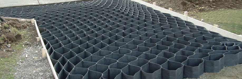

Take a look at this; it is call GEO cell. I have seen it used to create a parking lot on a grassed area. While this will not eliminate the water it will give a solid base that will keep you form the muck.
