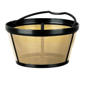

I use coffee filters all the time to run stuff through...do a pretty good job. Hard part is finding something to put them in that works like the one on the coffee machine, ridges to hold the paper up etc...save your old one if you ever toss a coffee maker. What I use now is a reuseable coffee filter basket with fine brass mesh, put the paper filter in it to catch smaller stuff...

The coffee filters are a great idea- Unfortunately I don't drink coffee, so didn't have any around. I like the idea of finding a metal coffee filter and fitting it to a funnel though.
