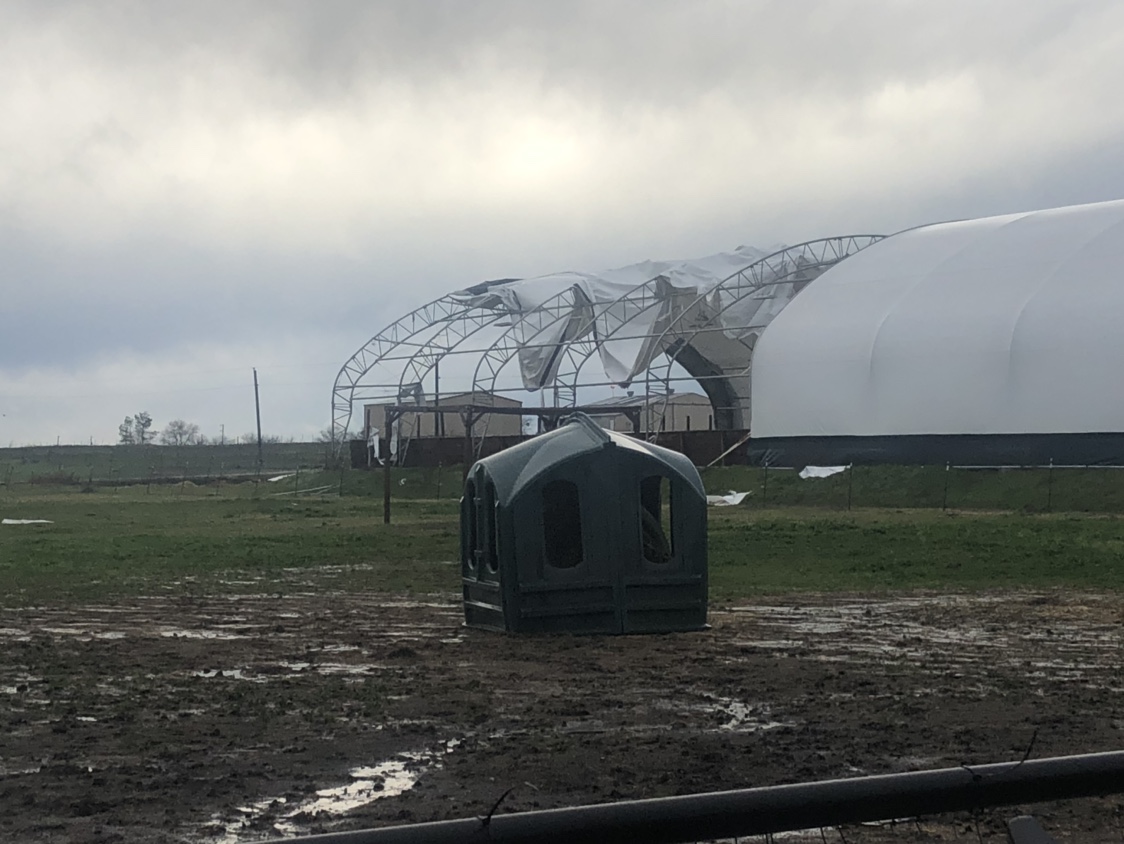

Question to my favorite TBN geniuses:
Long story short: 2011: Built a 72x300 fabric building that is used as an indoor riding arena. My cover is in 3, 100 sections.
2014: North Texas storm tore the middle cover off. Clearspan made it right.
2019: Storm rips off another cover. This time: they want $20k just to replace 1 cover (not including labor.) Before I bought the building, I was told the cover is approximately 10% of the cost of the building. I paid $110K including shipping, taxes etc. Insurance is covering it, but how many more times is insurance going to cover it?!
The warranty was for 10 years, and has a wind rating if 90mph. Neither weather event reached that. Here is their response:
敵ood questions. The warranty unfortunately does not cover any acts of God or weather incidents like wind. The structures are designed to meet minimum 90mph wind but the warranty only covers manufacturers defects.
Ummm straight line winds less than the rating advertised, isn稚 a manufacturing defect? Twice in 8 years! Are my expectations too high here? Am I being unreasonable? Anyone else experience this, and reach an acceptable resolution to this problem?

We talked to these guys for 7 months before we bought the building.. we went and looked at a couple of different fabric structures made by this company and others. I assumed that any wind damage within the wind rating would be covered by the amortized warranty (aside from debris or negligence). I’ve learned sooooo much from this experience though... building wise and contract law wise.
I’ve been seriously considering filing a claim with my state’s deceptive trade practices act unless they make this right. So far, I’ve got them to convert the damaged section of the cover to their newer system where the cover is in 20’ sections... but I want them to do the whole thing because I noticed a section (kind of hidden) where the bottom stretch pocket is separating! Also, the skirting rail and hammer strip system (that we paid extra for) does not work well at all. The skirt sits over this u channel and you hammer this white strip that’s supposed to hold it in place... they pop out all the time. I went back and shot some metal screws through them every two feet or so and they stayed in place better, but some still came undone!
