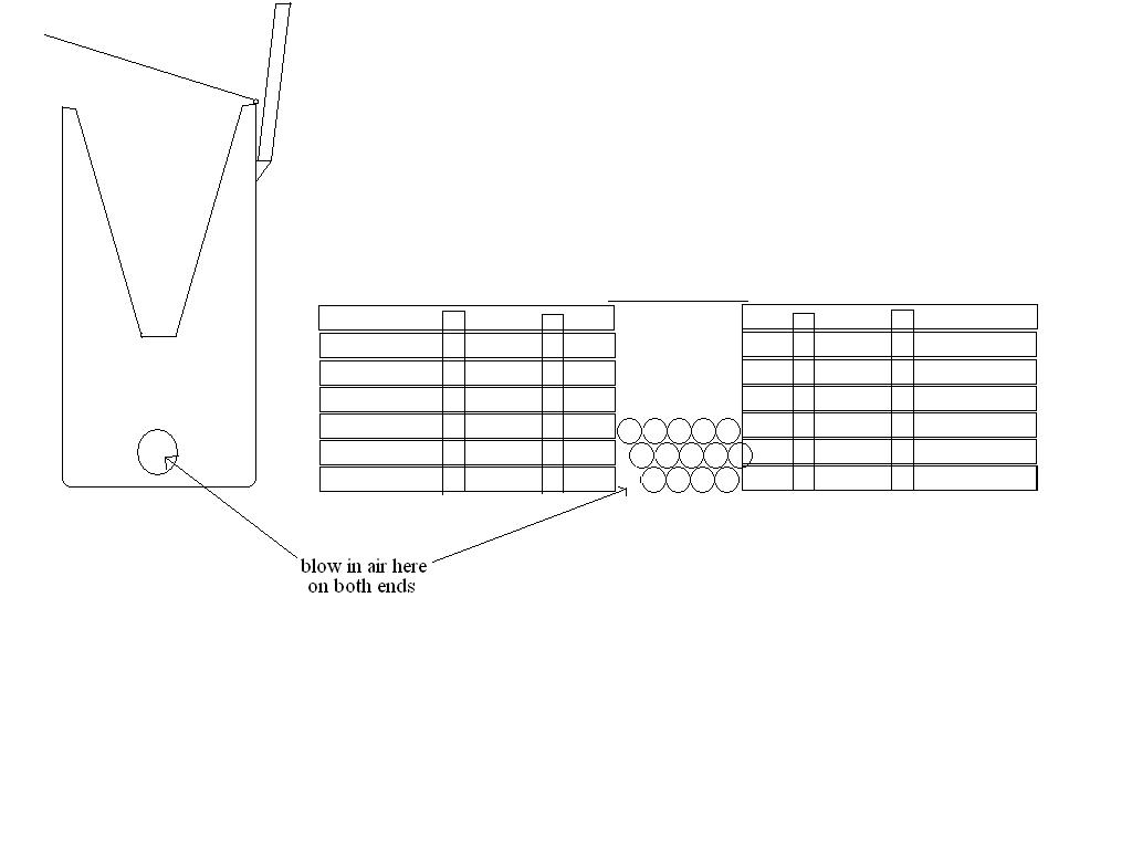

You say you make this out of stumps, but then you talk about taking the top off and putting it back on again. What is the top?.
I had the stumps to cook down, along with a bunch of other stuff. With the stumps, I had a piece of steel plate that I could drag on and off. Something on top is the key as it slows the escape of the heat and concentrates it between the sides of the trough. The plate was a hassle, as it was just setting there and had to be repossitioned a lot. If it was hinged so it could just be flopped open and closed, it would be much easier to work with. If I was making one specifically to burn logs, I would make it out of steel, perhaps an old oval fuel oil tank with the top cut off, and large "V" notches cut down the sides to allow the logs to rest in it. I would cut the logs just slightly longer than the trough so they cannot immediatly fall to the bottom, but instead have to hang in the heat and burn thru. Once they burn thru they will fall the rest of the way down and provide dry fuel for the core fire. Another way, since the OP has a bunch of logs, would be to make frames to hold the stacked logs in piles end to end with a gap in the middle to form the trough. As the logs put in for fuel dried out the logs forming the trough, the ends of the logs could be pushed in to keep the trough shape This would use the material he has a lot of, consume the material, and dry out the logs used for the trough so they will burn easilly in a conventional fire after all the others are gone.
Attached a pic to show what I am talking about. on the left is how I would convert an old fuel oil tank, and on the right, stacked logs forming the trough, with ones piled on each end to form the supports for the ones being burnt. The top of the log built burner would be more difficult to deal with, but would require only the top metal plate...
Interesting that such a small fan would work.
Put in the right place, it takes very little air to get a fire really cooking. Take a long piece of pipe, stick it down near the coals at the center of a fire and blow and you will see what I mean. Now imagine a steady stream of air applied at that point. When I say hot, I am talking too hot to approach the pile to add fresh fuel without getting radiant heat burns... That little bit of air is also the difference between a wet smoky "neighbor complaining about the smoke" fire and a clean fire with almost no smoke... A section of rigid steel dryer duct pipe from the home improvement store, and a 12V computer fan from radioshack and some small angle brackets to attach the fan to the duct. Apply a 12V power source and work the nozzle end down toward the coals and away she goes. It gets so hot that the end of the duct starts to break down from the heat and you loose a little length with each fire. I thought about building a larger one with a car heater blower, but the little one works so well, I have yet to have the need for more air. If I built a large trough, I would use 2 of these, or make the larger one to feed air into both ends, and perhaps into the middle.
