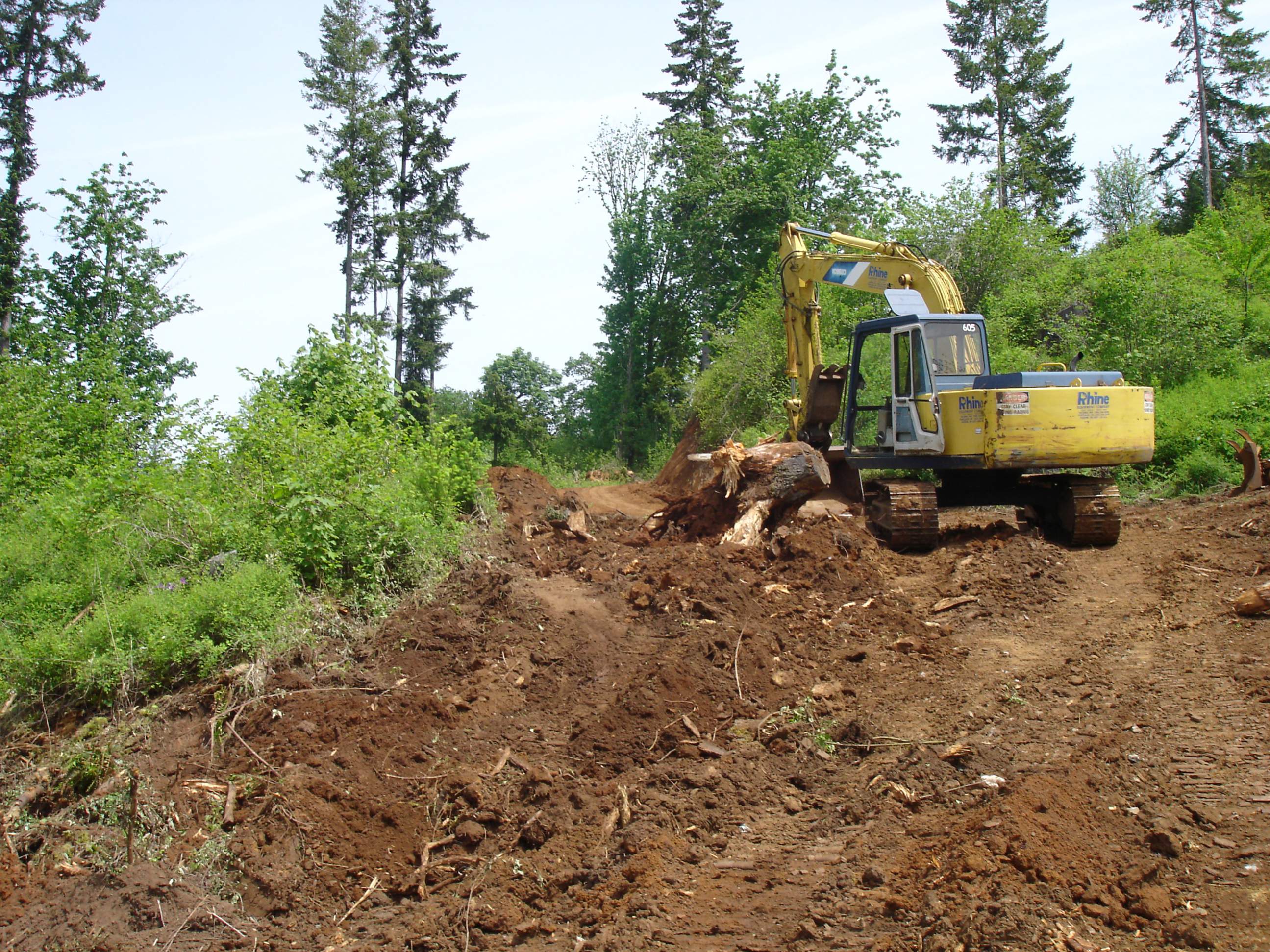

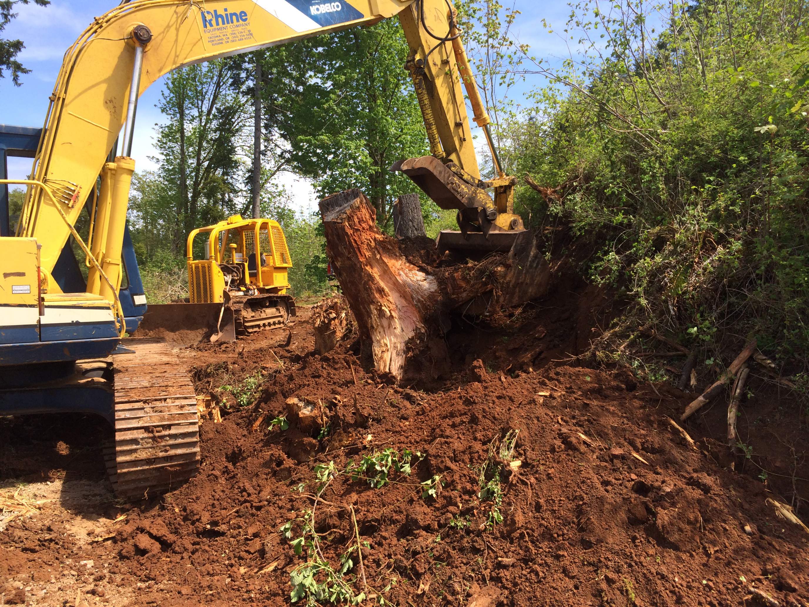

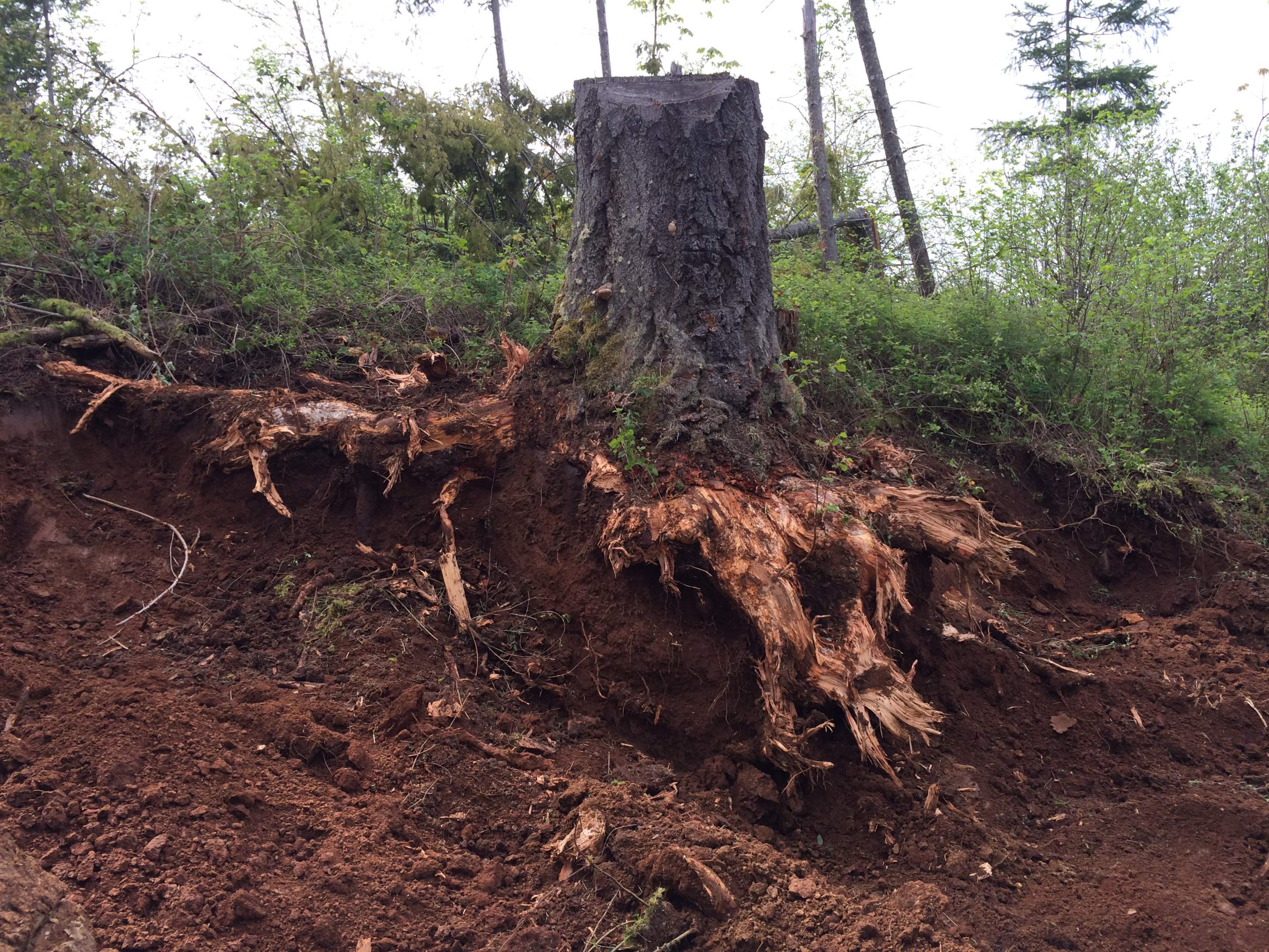

I've just spent 2 months pulling huge Douglas fir stumps. There were a few that had 2 or three that had grown together. I ended up digging around the stump and find all the roots growing outwards and dig along them. Cut them off at the stump and again at about 4ft away. Then keep digging down to make sure the ones that go out are all cut, then I had to start digging underneath the stump (there is another set of roots going straight down) keep digging from the side underneath and cut the roots. at some point a backhoe should be able to pull it over. Some of them took 12-16 hours a piece
That's a good sized backhoe. I would think they would make short work of Fir stumps. How long did you have in the worst stump?
The worst one took 2 days. It was actually one with a 52" diameter at ground level with a 28" and a 14" side by side grown into the roots of the big one. It's a 120 sized excavator and I thought it would be big enough to make the labor part less but it was not to be. It will pull up to 24" stumps with no cutting. Quite a few times I lined up head on, got the bucket under the edge of a root and pulled. This would then raise the back of the excavator up 2-3ft then I would just twitch the controls and get it bouncing and eventually it pulled them free.
