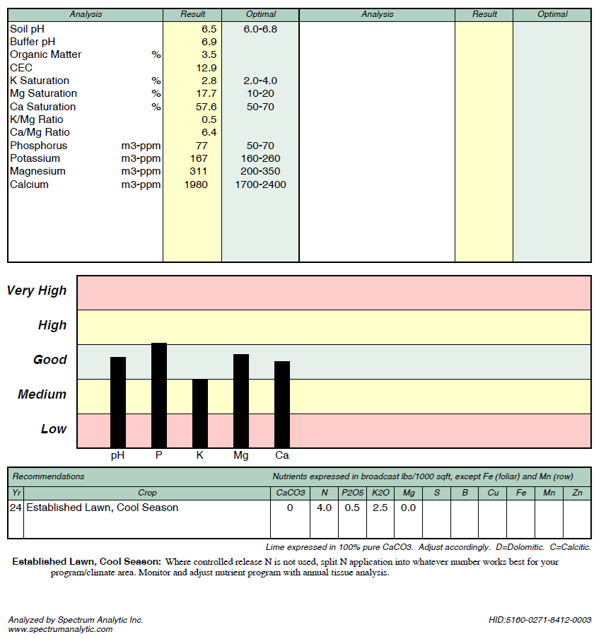

Interesting how different the recommended targets are. I guess we're growing different crops, but wow... never thought anyone would be recommending pH in the 5's!
Here's mine from this spring:
So, you see the little table of recommendations at the bottom? Those are seasonal totals, and I break that into 5 applications. The break is not even, as different times of the year pull harder on one nutrient versus another, but the fertilizer manufacturers have that worked out pretty well by packaging the products you're using (pre-emergent, grub control, etc.) with the ratios that favor that time of the year. Usually you only have a choice of two different nutrient levels in each product type, making hitting those yearly totals like a 9 month long game of Tetris.

Looking at your chart, it's calling for 174#/acre N, the numbers just look smaller cause they are basing it on per 1000 soft, vs #/acre
Yep. The differences that surprised me were more in terms of targets, than recommendations, and mostly the pH.
My numbers are also small because even coming out of late winter, most of my nutrient levels were pretty much right on target. That's from 10-15 years of nailing the recommendations every year, my soil is now to a point where it very rarely drifts outside the "good" range. You'll also find your yearly requirements dropping off after the first year or two, to where you're still doing the same number of applications per year, but using lower-number products.

Just did some quick math on this:
RecommendationMy report (lb/ac)Your Report (lb/ac)
Lime0365(D)
N176NA
P2260
K11080
Mg020
Obviously, you want to do that Dolomitic lime first, as all the other nutrients are a waste of time and money, if pH isn't in range. Also, lime is far cheaper than any of the others.
I'm not sure why yours doesn't recommend N. Yeah, it's not something you can easily test, but there are known seasonal requirements per crop and climate.
I'm also surprised that, despite your K being so low, they're only recommending 80. It's not clear what units "15" is, but they do say "LOW". Mine is in-range, albeit toward the low side of the range, and they're still recommending 110 lb/ac. Again, crop and climate differences...

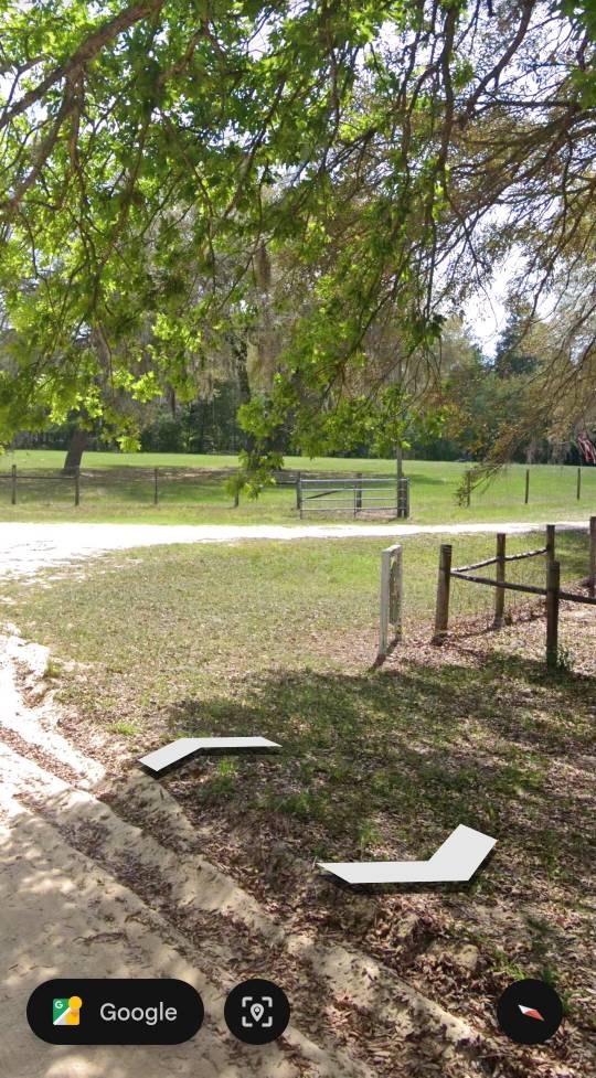

You can't really tell that I've removed any trees; but I've taken down probably 4-5 scrub oaks, around 8"; a dozen water or live oaks around 3-5"; and a handful of long leaf and some other type of pine, mostly 3-6", and 2 large dead long leaf pines,
Looks like those "other pines" are Loblolly

Good question. I see yours came in at 35, and they call that "medium", but up here they recommend 50 - 70 ppm. More interesting, even though mine is above recommended range at 77 ppm, they're still recommending I apply 0.5 lb./1000 ft2. So the implication is that there must be some seasonal loss.
It'd be interesting to know what range they recommended for pasture grass in your climate, prior to P-sensitivity training.
