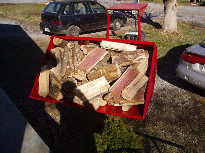

I would suggest you call ahead and have Power trac weld a t-10 plate on one of there larger buckets (Larger than 18 cu.) In my experence it is nice to have a really large bucket. Although I only have a 422 it handles this bucket very well.

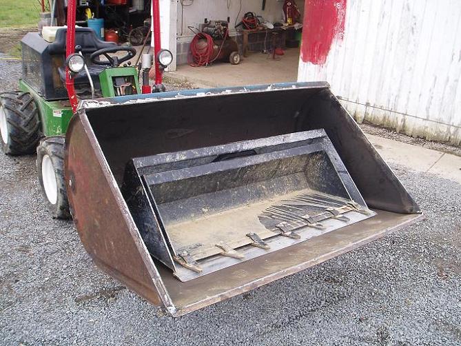

Another size comparison to the 10 cu and the 5 cu

Is the small bucket in your attachment 5 cu ft and is it sitting in a 10 cu ft bucket? Then what is the approx. cu ft of your larger bucket?
What is a t-10 plate? thanks everyone
   / Larger bucket for 1430 #10
Yes that is correct. I fugure about 35 or 40 cu. ft
