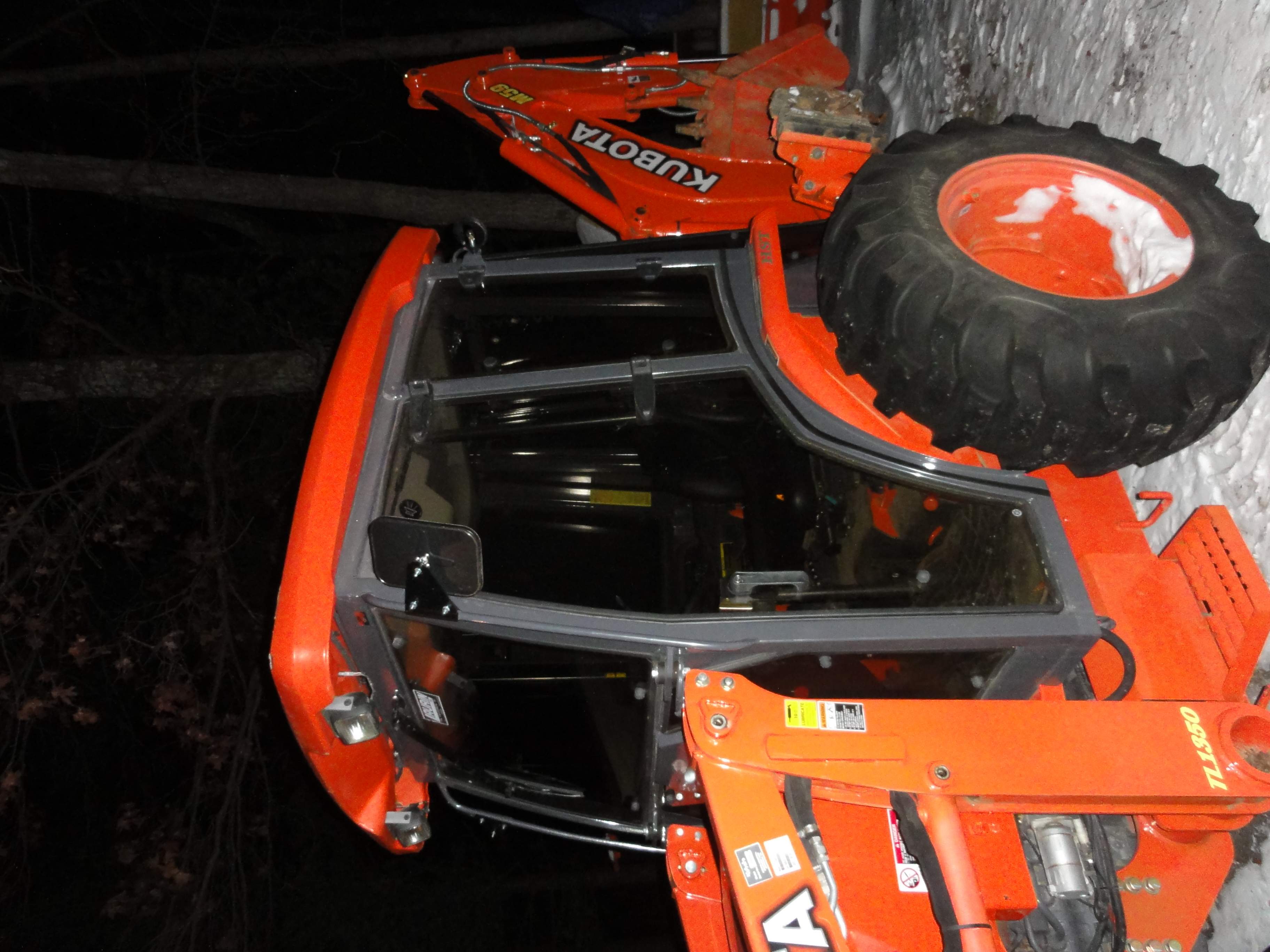

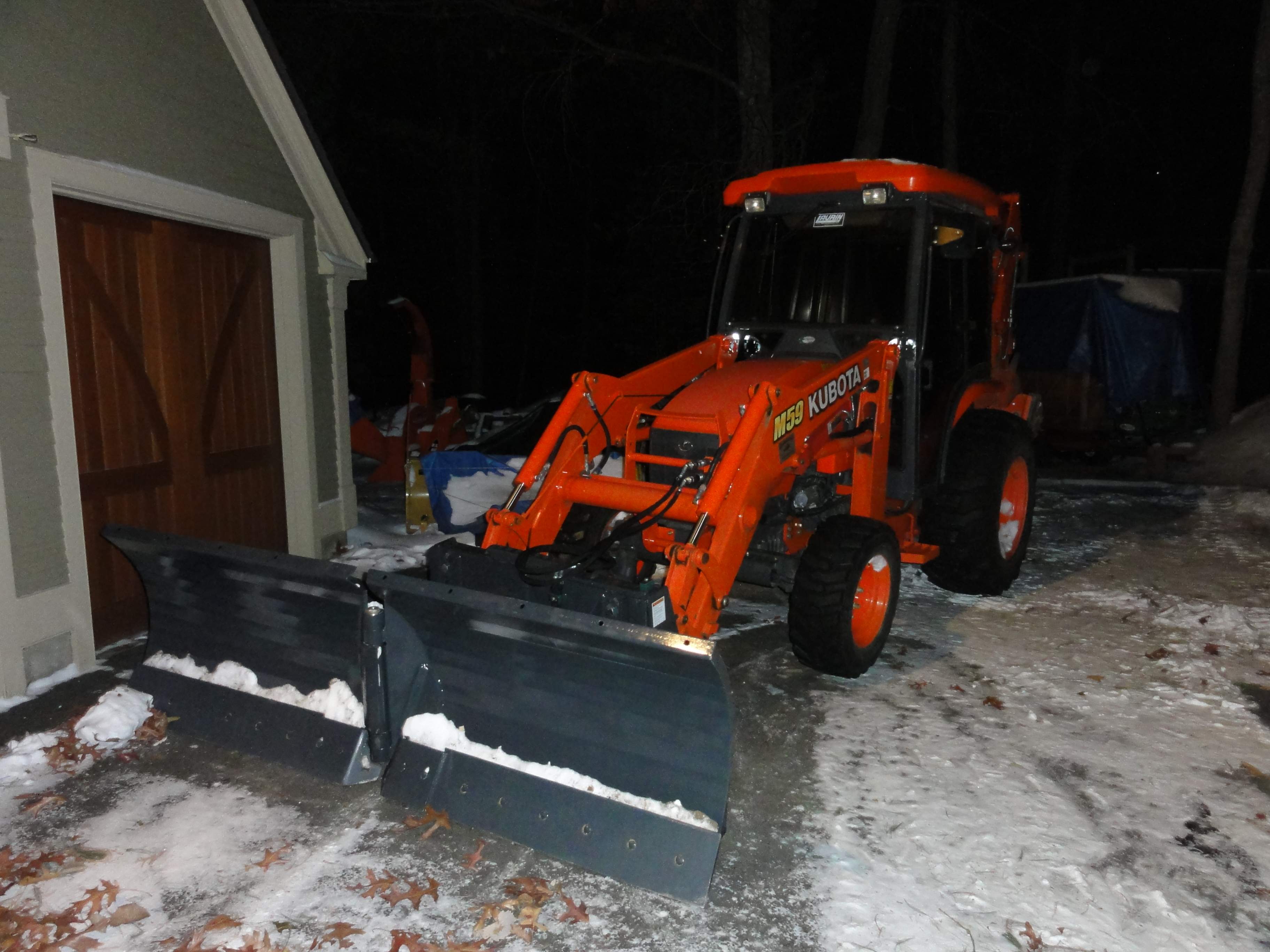

Search my posts for other pics
/ Larin cabs on M 59
Thanks for the pictures, it looks like it is a good fit compared to some of the other companies styles. Did you install it yourself or was it dealer installed?
Thanks
/ Larin cabs on M 59 #4
I posted the following information some time back... many additional details.. have a look
http://www.tractorbynet.com/forums/kubota-buying-pricing/156901-m59tlb-laurin-cab.html
Installed without issues. ROPS comes off... Cab goes on in it's place.
I have modified a few things not to my liking. No major issues. Cab is noiser than others on the farm. Massey Cab on a 3200 series is much quieter.
I would do it again. Plow snow all day in shirt. I remove the doors in the heat of the summer.
