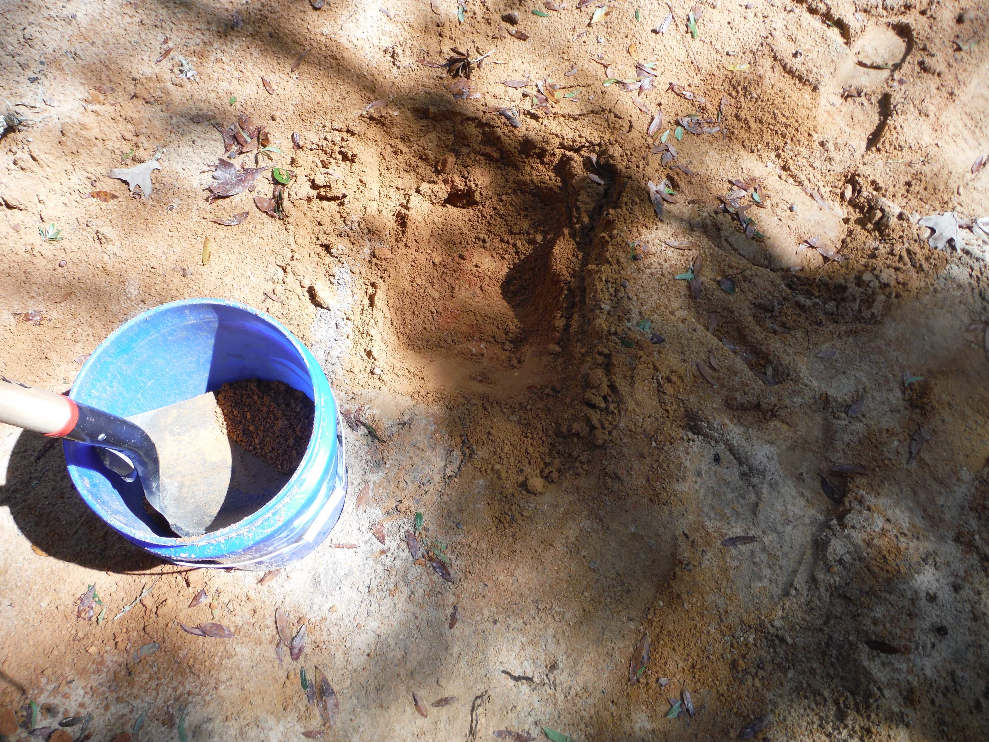

I spent most of the day here around the house. But I did get down to the camp right before dark and got in a little shoveling, including harvesting some clay for making cob. If all goes well, I might use it to make a chimney for my fox stove tomorrow.

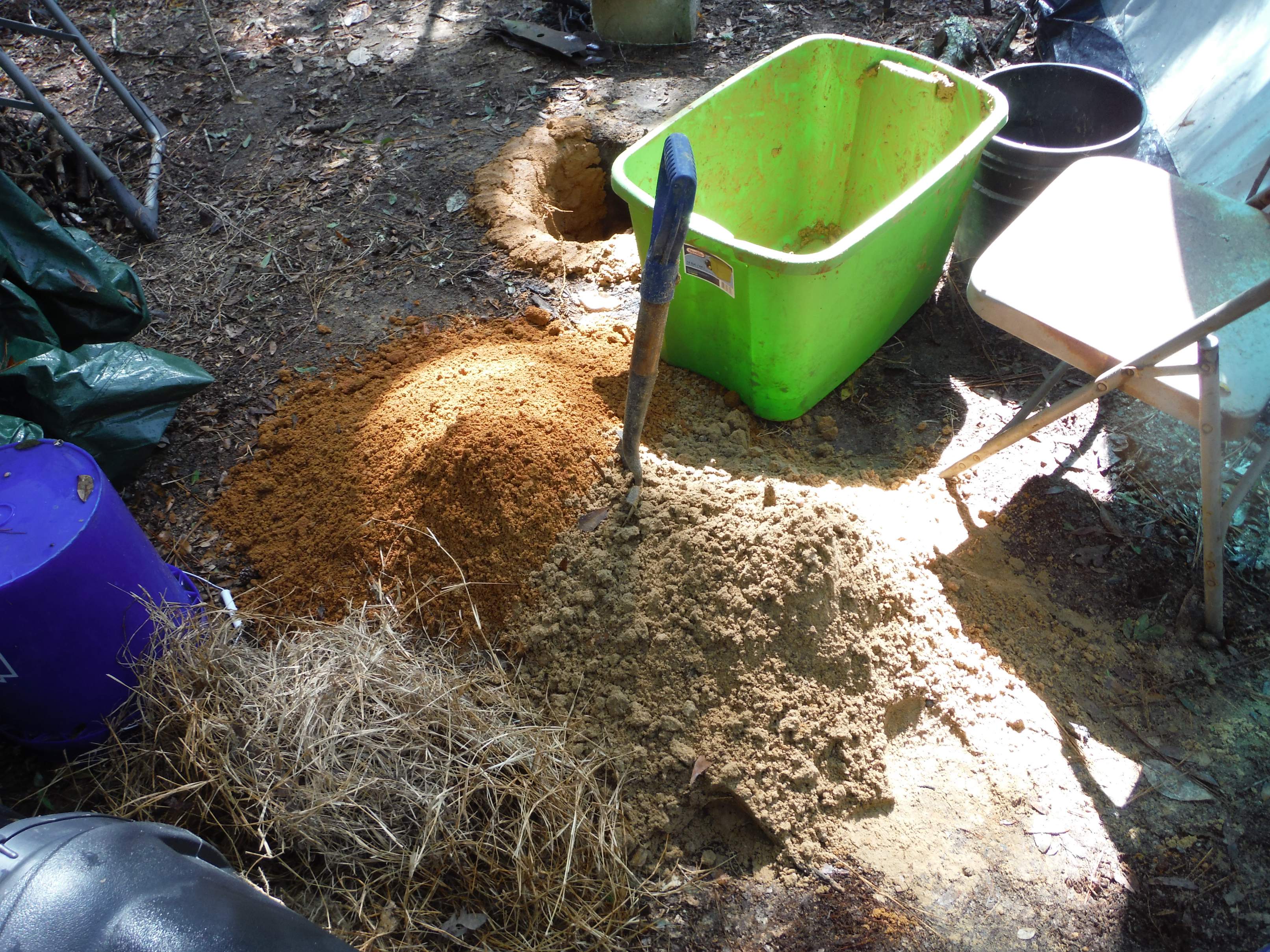

Today I turned my fire hole into a Fox stove. {or Badger stove, according to where you're at} I guess I could call it a Gopher stove:eek:

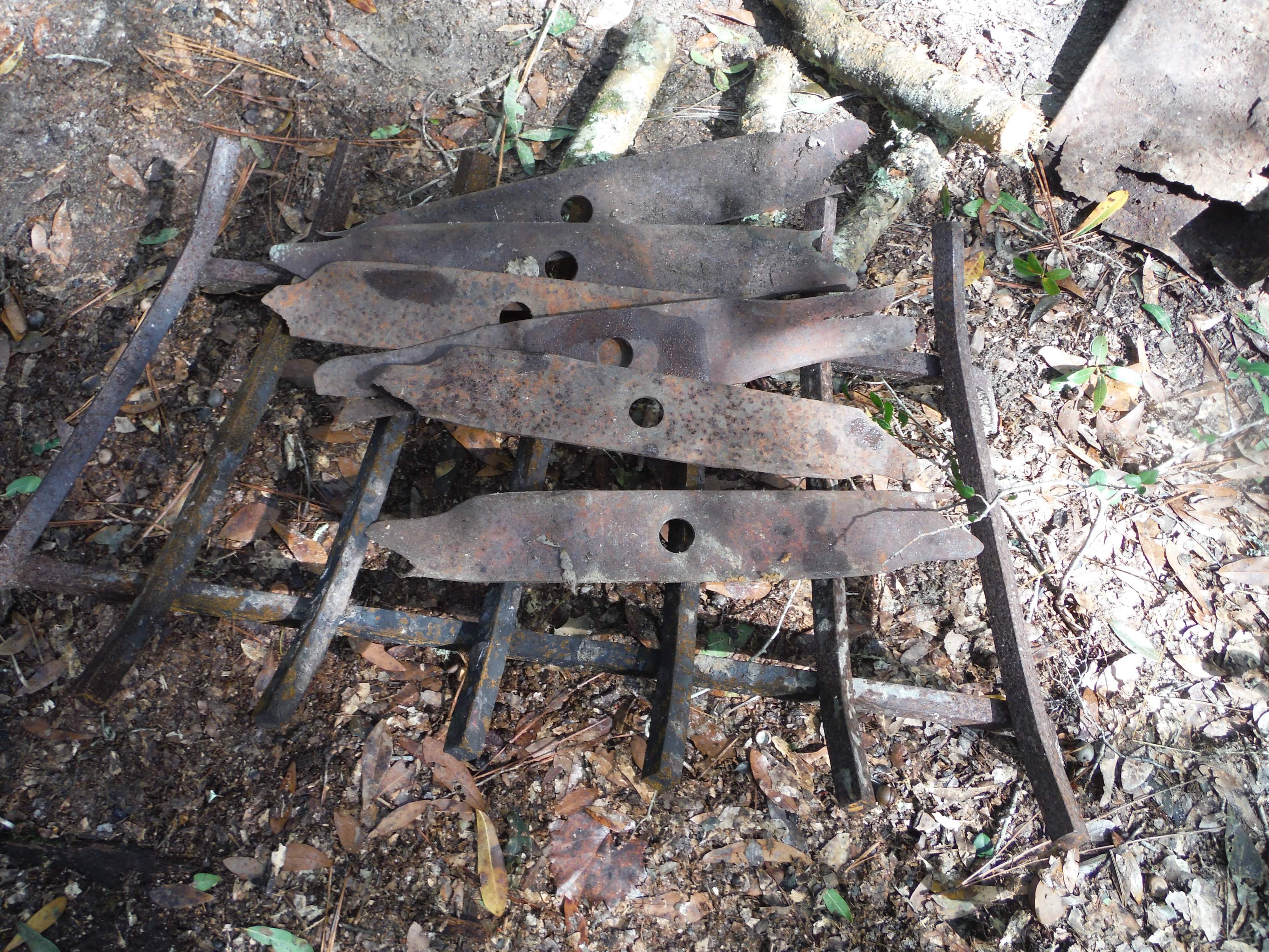

This was my first time working with cob. I used 3 parts {surprisingly good looking} clay, 2 parts sand, 1 1/2 parts water and a certain amount of straw to make the mud. I lined the bottom and sides of the hole, then mounded up a "chimney". The hole is bigger than the stove-top I had planned {used mower blades}, so I'm going to have to come up with another plan. I covered it with an old tarp so it can dry out slow. A few day's time will tell how good a job I did.

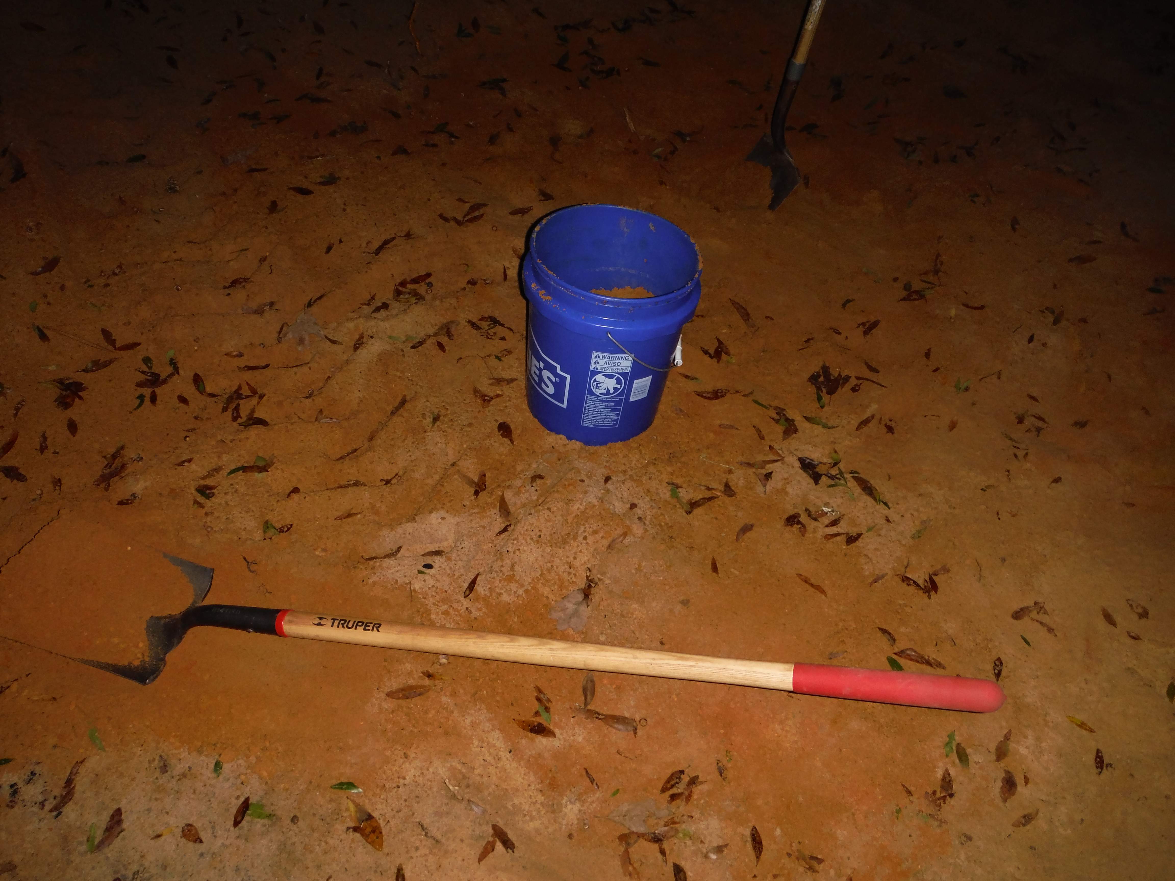

Do you have a hole or something to the bottom to feed it air?
   / Larro goes underground
#68
I used hole diggers and a trenching shovel to dig the air hole. This is a nighttime picture, but you can see the fire at the end of the air hole. {the broken block is to keep me from having a broken ankle} The times I had a fire in it, it drew really well. The higher up I go with the chimney, the better it will draw.
