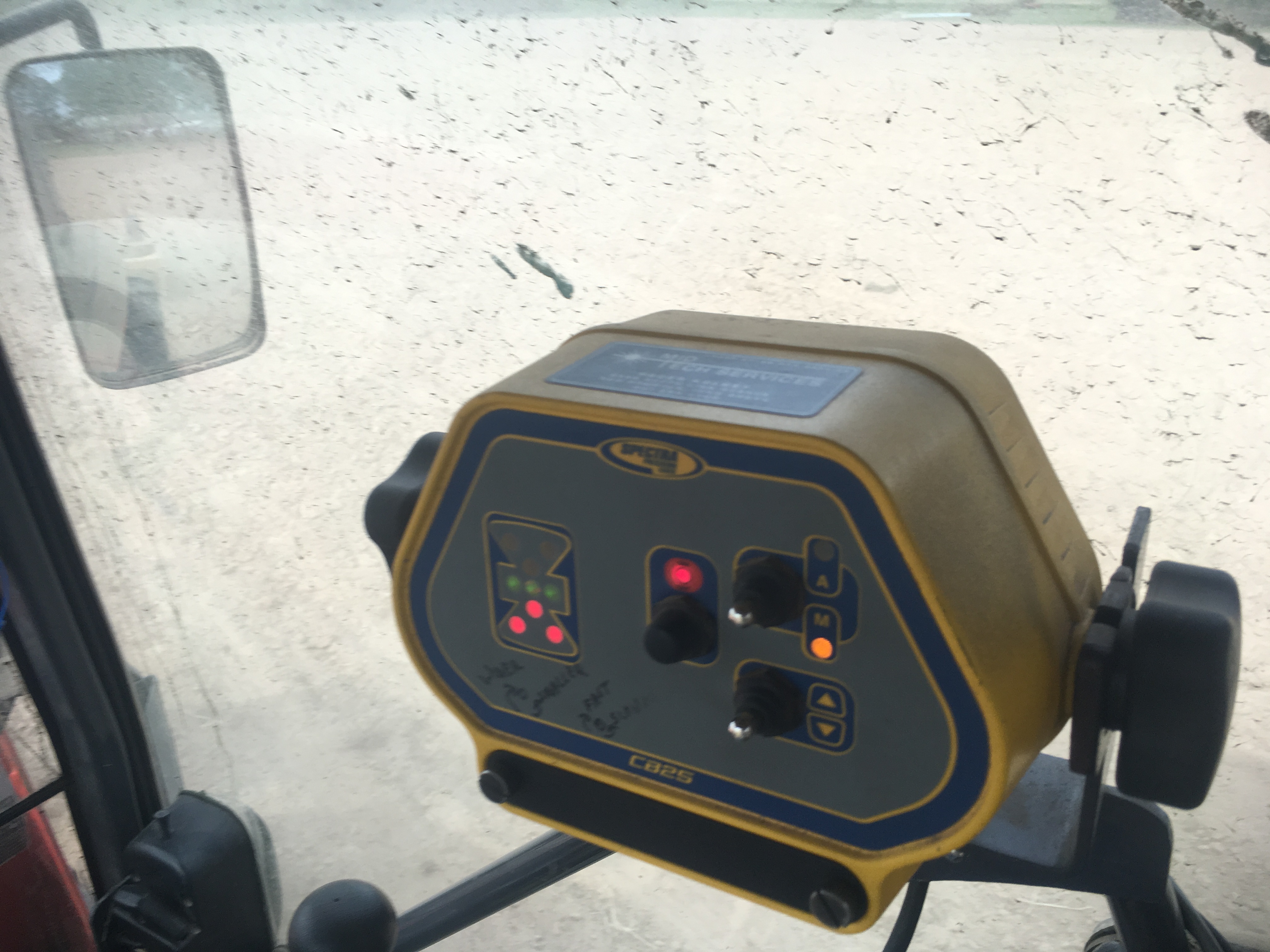

So basically, the only way you know at any location what the ground is doing is to watch the blade? And then you get a feeling for the lay of the land and come up with a best plan in your head for your movements? Do I have that more or less right?
Yes. But instead of watching the actual blade, I watch the receiver, or the control box in the cab. Both have lights that indicate the blade position relative to the laser beam.
In the picture below you see the green lights, and the red lights below the green. This means the blade needs to be lifted slightly to be 'on grade'. Only red lights mean the blade needs to be lifted more, and only green lights mean the blade is 'on grade'.

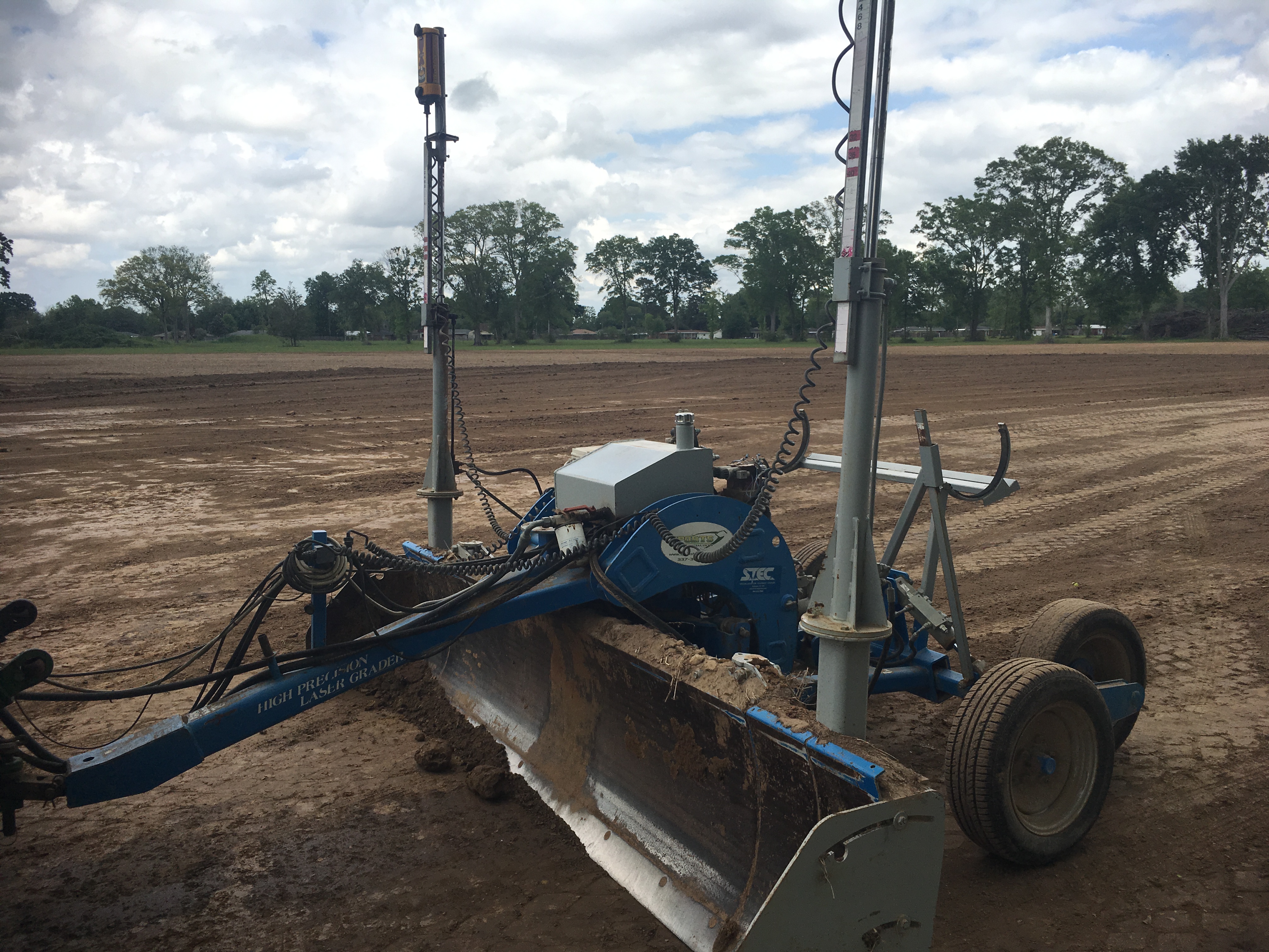

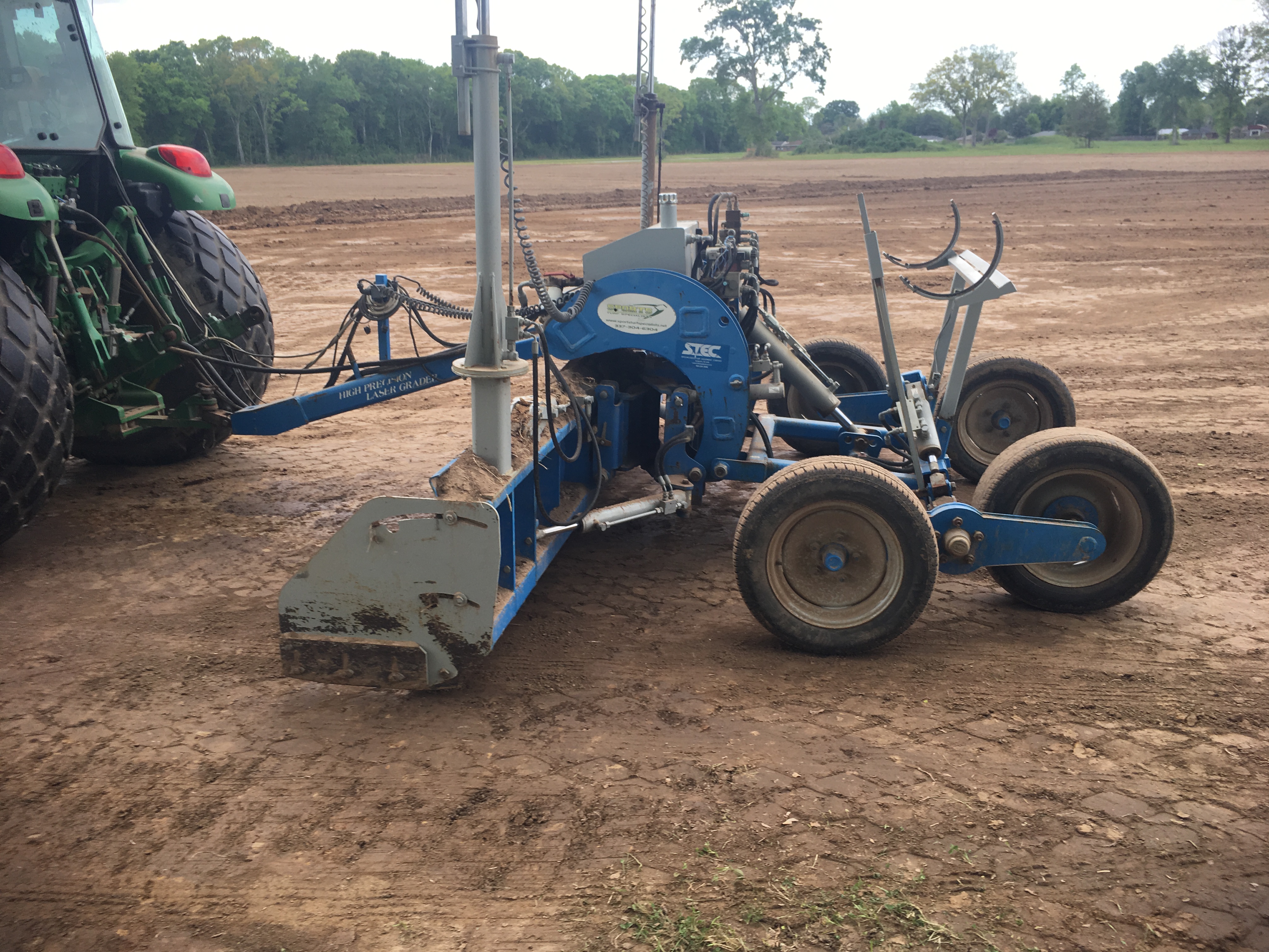

If you look on our blades, you see a pole sticking up with a receiver on top. Mine has one, his has two. The laser is set on a tripod as you can see in my first video. I can set the slope of the laser beam at whatever angle I want. In this case, my slope is set at 0.3% which will give me about 18" of drop across the area I am doing.
The laser beam is picked up by the receiver on pole. If the blade goes below the laser beam, the receiver tells the hydraulics to lift the blade. Basically, we just drive around and let the machine cut the hills and fill the holes. It's a little more complicated than this, but hopefully this gives you an idea.
On this job, the city wants to add some practice area for youth sports teams. There is a ridge about 1/3 of the way across this 10 acres and it naturally slopes to the east on the small side and to the west on the larger side. I took the smaller side because of my smaller equipment. The idea is to match the natural slope, and make it a very even, smooth slope so that it will drain well. And, by matching the existing slope, we have to move the least amount of soil.
