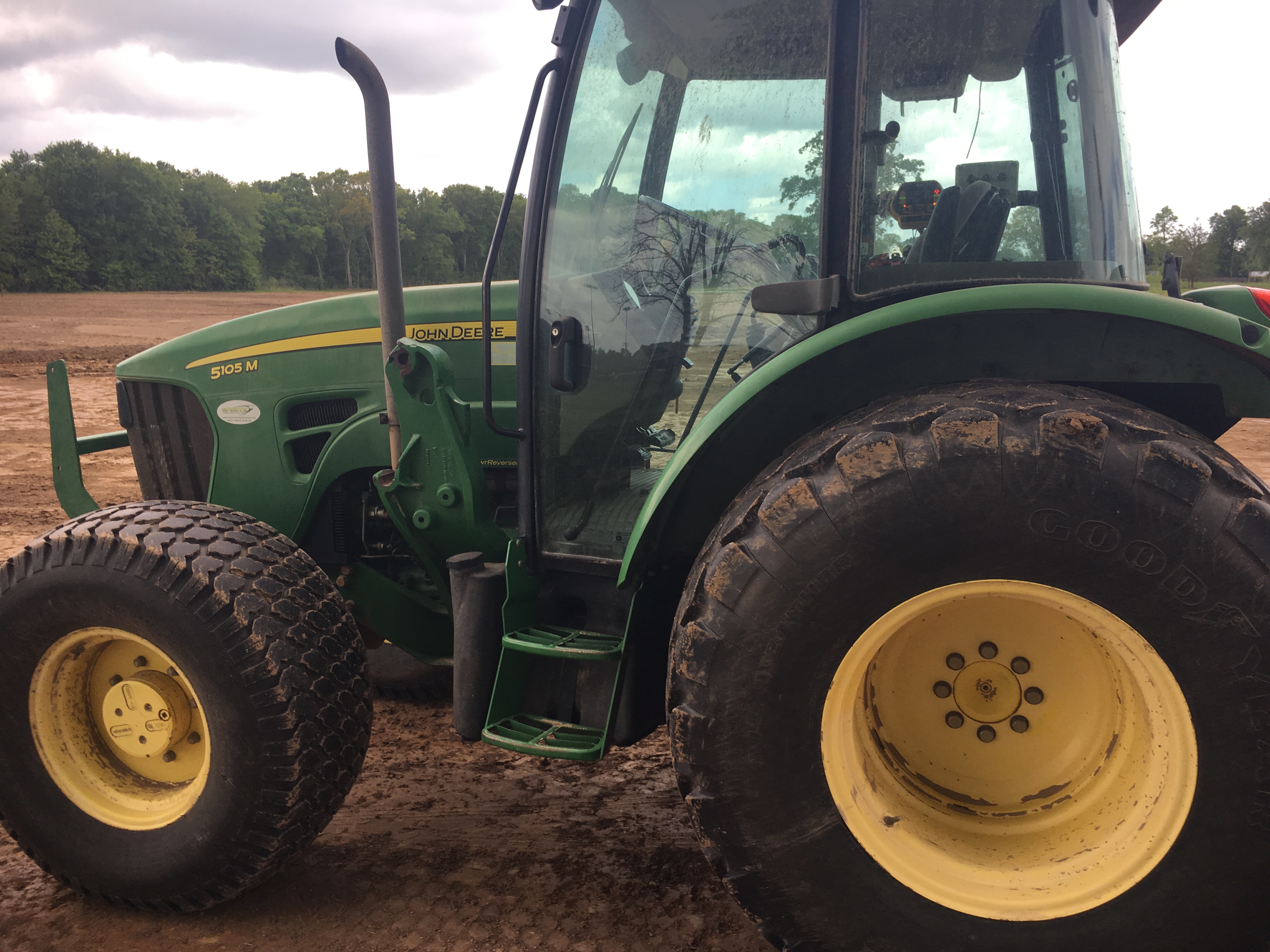

Looks like you are making good progress with the job. What tractor and box is being used in the second video? The rain will tell the tale, sure shows where more work is needed. +/- 1/4" is pretty close tolerance especially on a ten acre job. Will be very interested in how long this takes you.

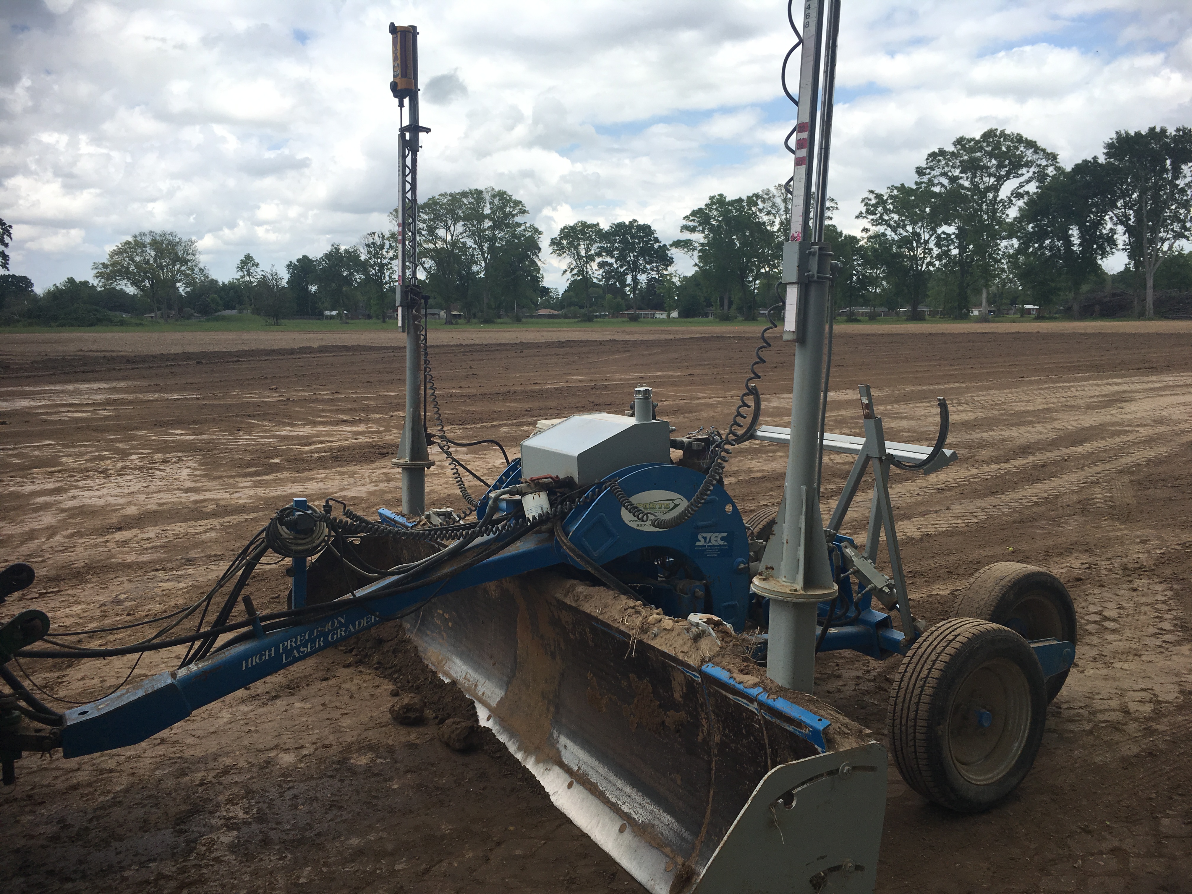

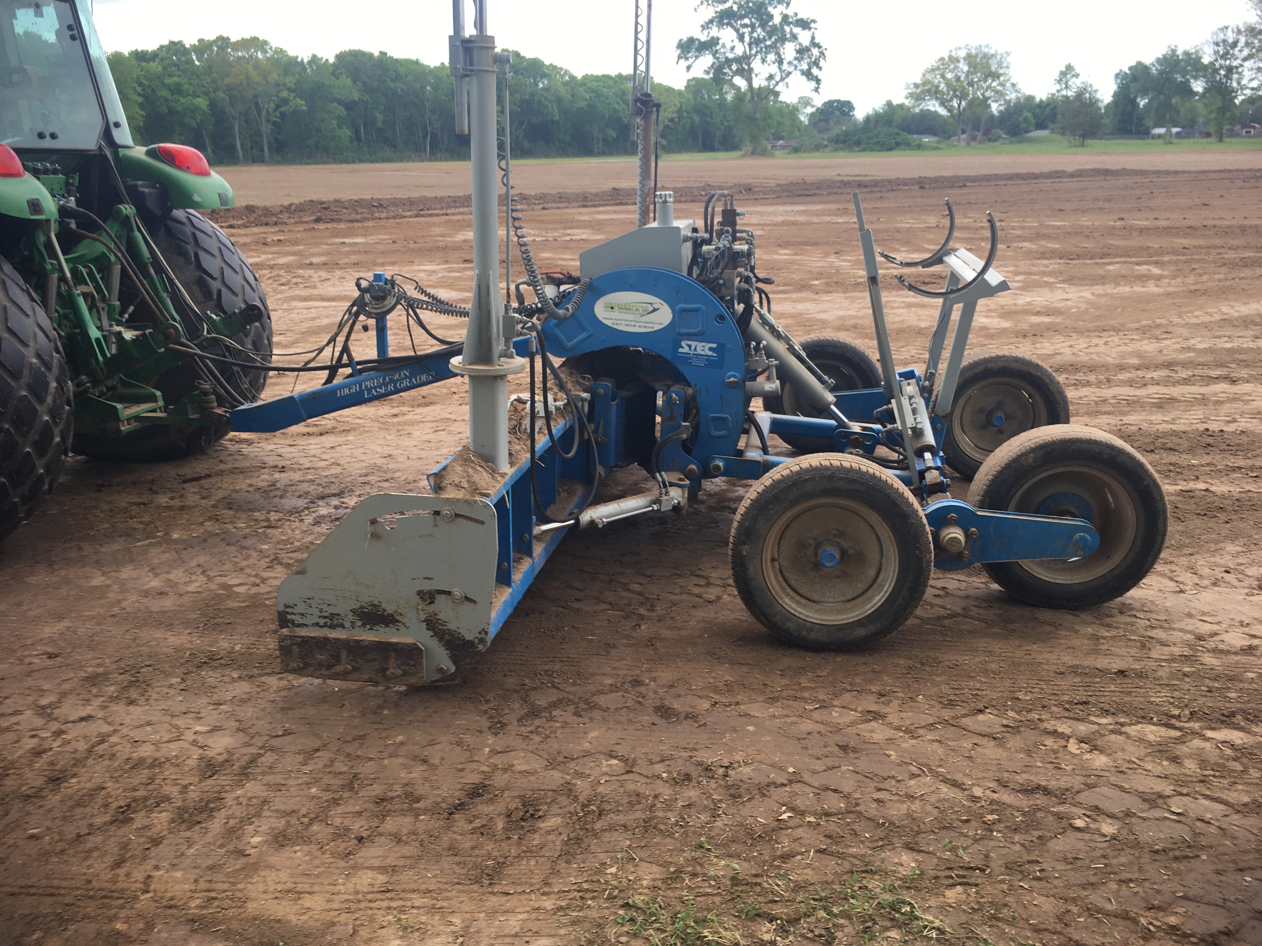

This is a closer pic of his rig. The blade is a $40,000 rig. It's really nice, but he has hired me to do some small jobs where his rig was too big.

That is one complex rig your buddy has. Is that a walking axle in the rear to limit blade travel like a grader? I'm surprised that it doesn't hold more dirt for the scope of machine.
