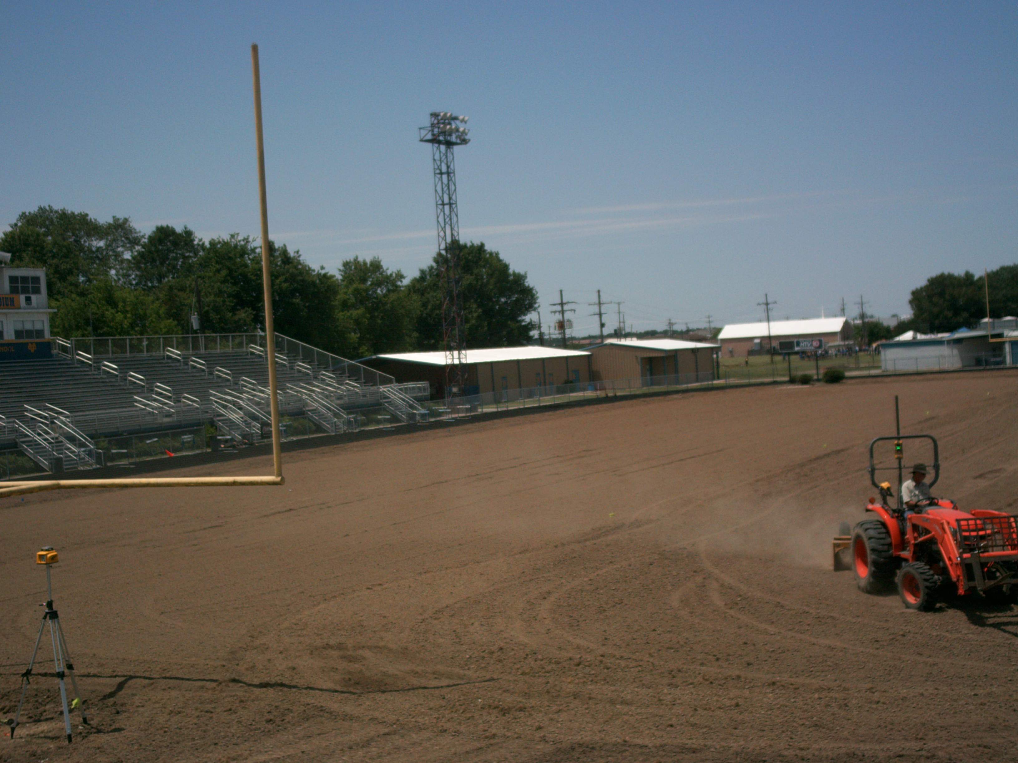

I set up a camera that takes a picture every 1 minute. I will convert those pics into a time lapse video and post it here, but that takes some time, so I'll do it later.
Here is a pic showing the entire rig as I was working yesterday. You can see that the blade is 'on grade' with the green light showing on the receiver.
Here is another shot from the back of the rig
