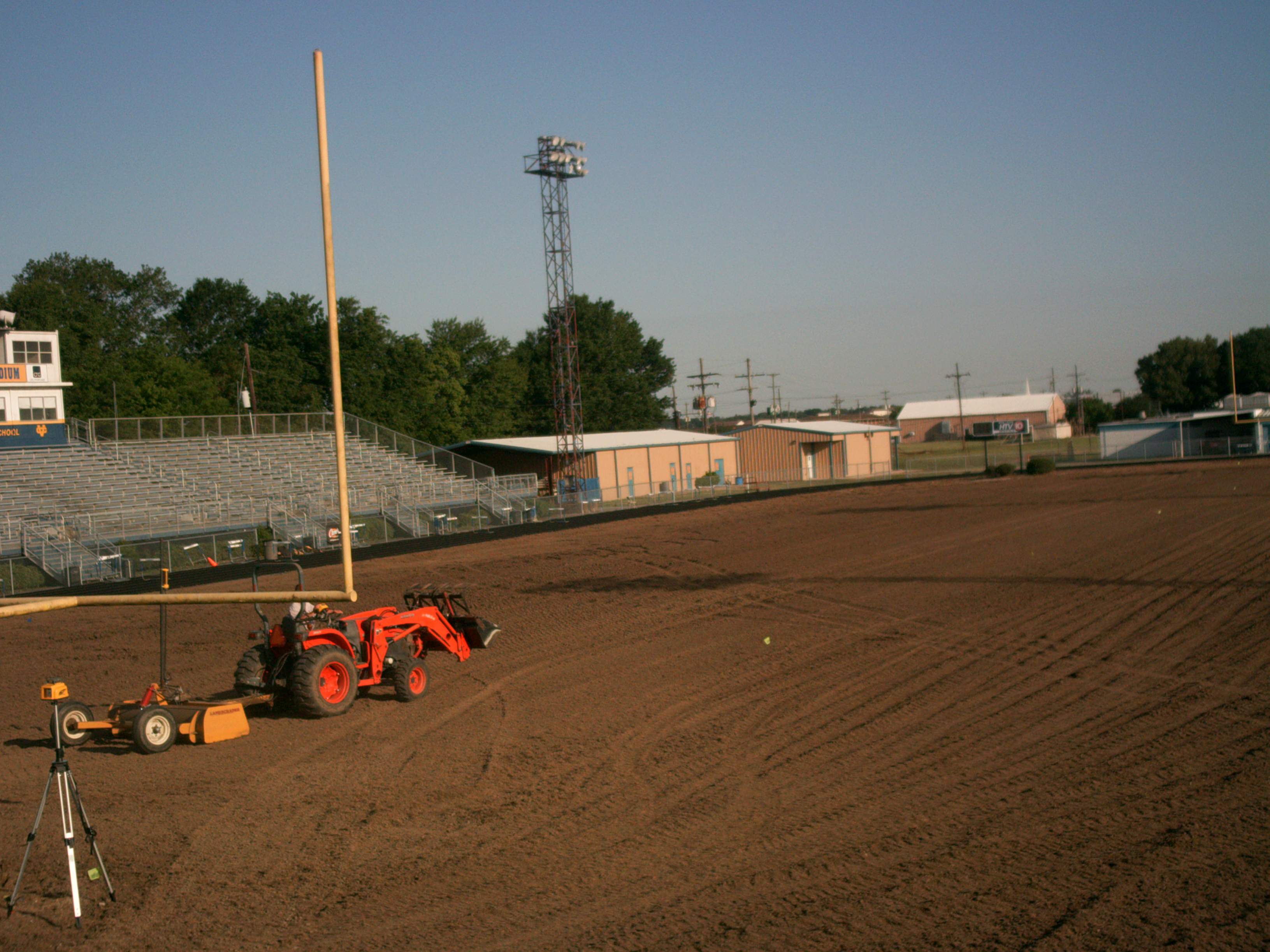

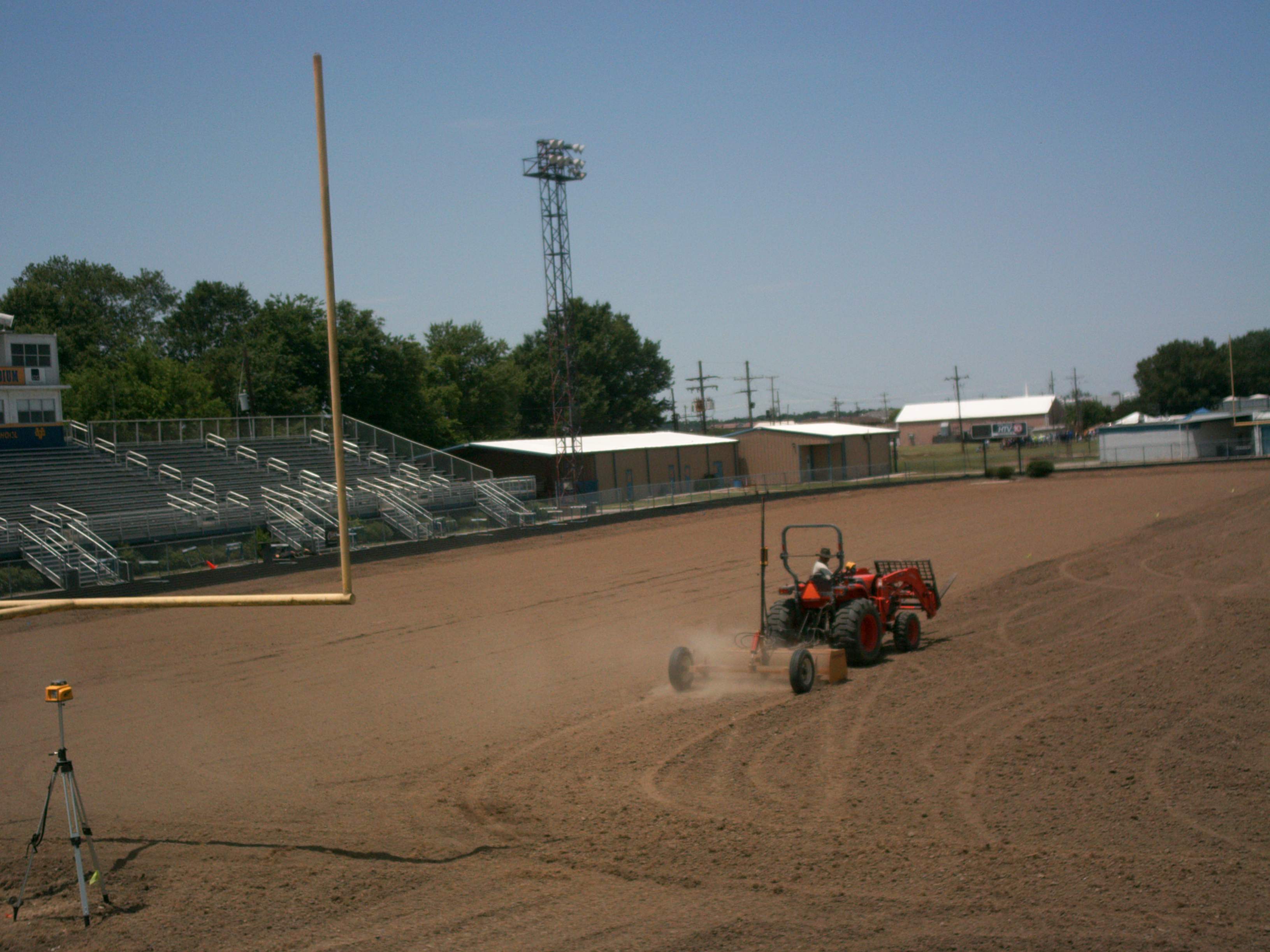

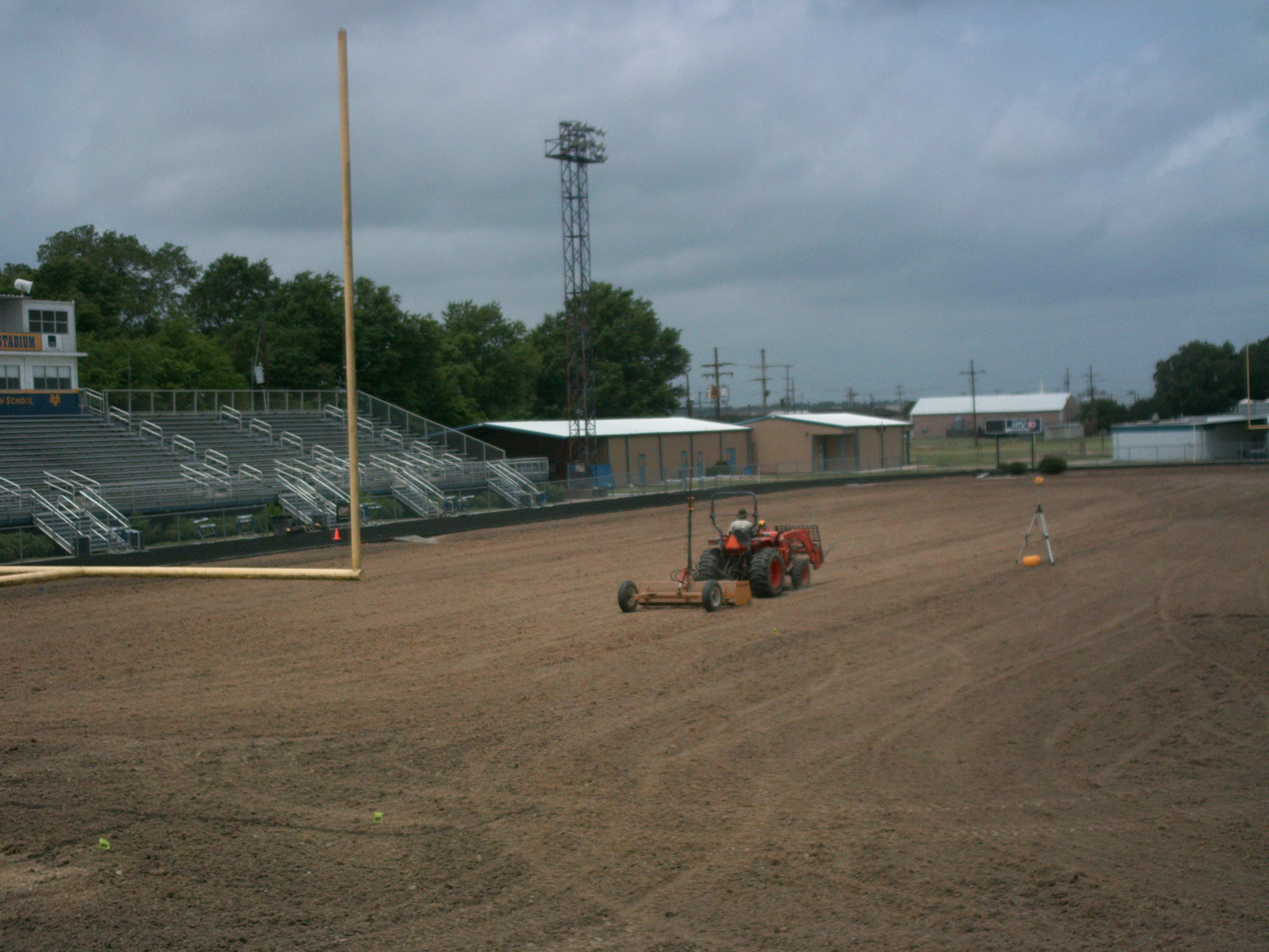

Well....I spent hours today trying to create a time lapse video with no success.
Here are a few more pics of the process. We are scheduled to plant the fields on Tuesday.

Looks good. That's a nice setup you have there!
   / Laser grading hydraulic valve issue. #123
Nice work and thanks for the pics.

Did you buy the vibe poles or did you just weld on poles for your receiver? I picked up my new laser and the first of two receivers Friday and was not expecting the receivers to be so big. Trying to work out the mounting for these tomorrow. I did pick up some tubing sized to the clamps and a shorter piece of 2" pipe to use for mounting with rubber insulation between the two poles.
#128
My pole was mounted by a local welding shop. Mine is removable. It slips into a larger diameter tube which is about 8" deep, and has 2 holes drilled through it and the pole for bolts to hold it in place. It does wobble a bit much, but it's nice to be removable.
The first time I used it with the pole in place I went under a goal and bent it pretty bad. Luckily I didn't have the receiver on it at the time. Now, I put flags on the ground under the goals to remind me not to drive under it.

Here is another video showing more of the actual laser grading. It was tilled, then rough graded, then tilled again, and then final graded.
Sorry for camera angles, it kept falling over.
The video is a bit long, but it does show more of the actual grading process.
