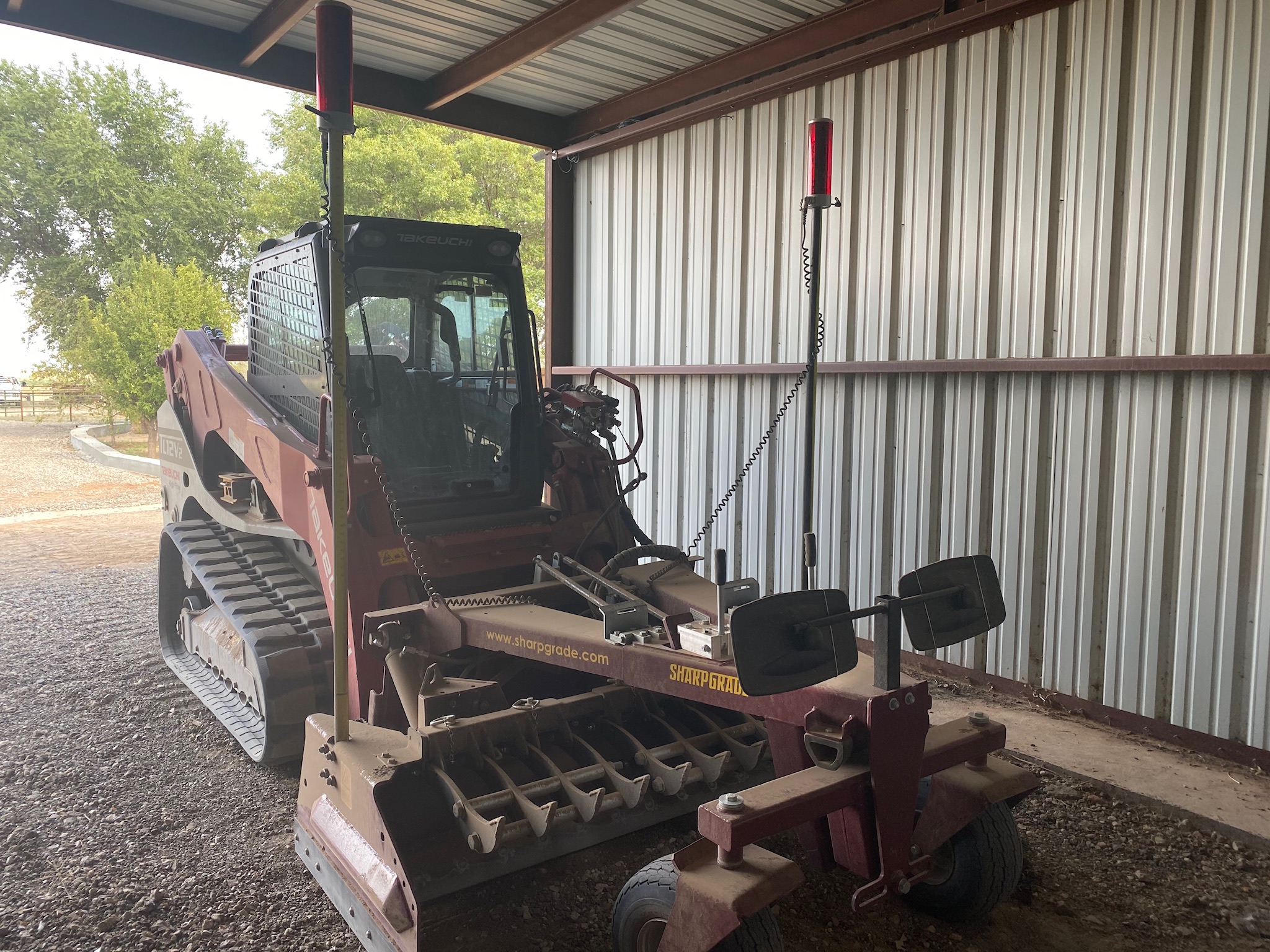

I have wanted a setup to do this for about four years and finally pulled the trigger. My system was delivered and set up early last week. I am still getting the hang of it all and practicing on my own place.

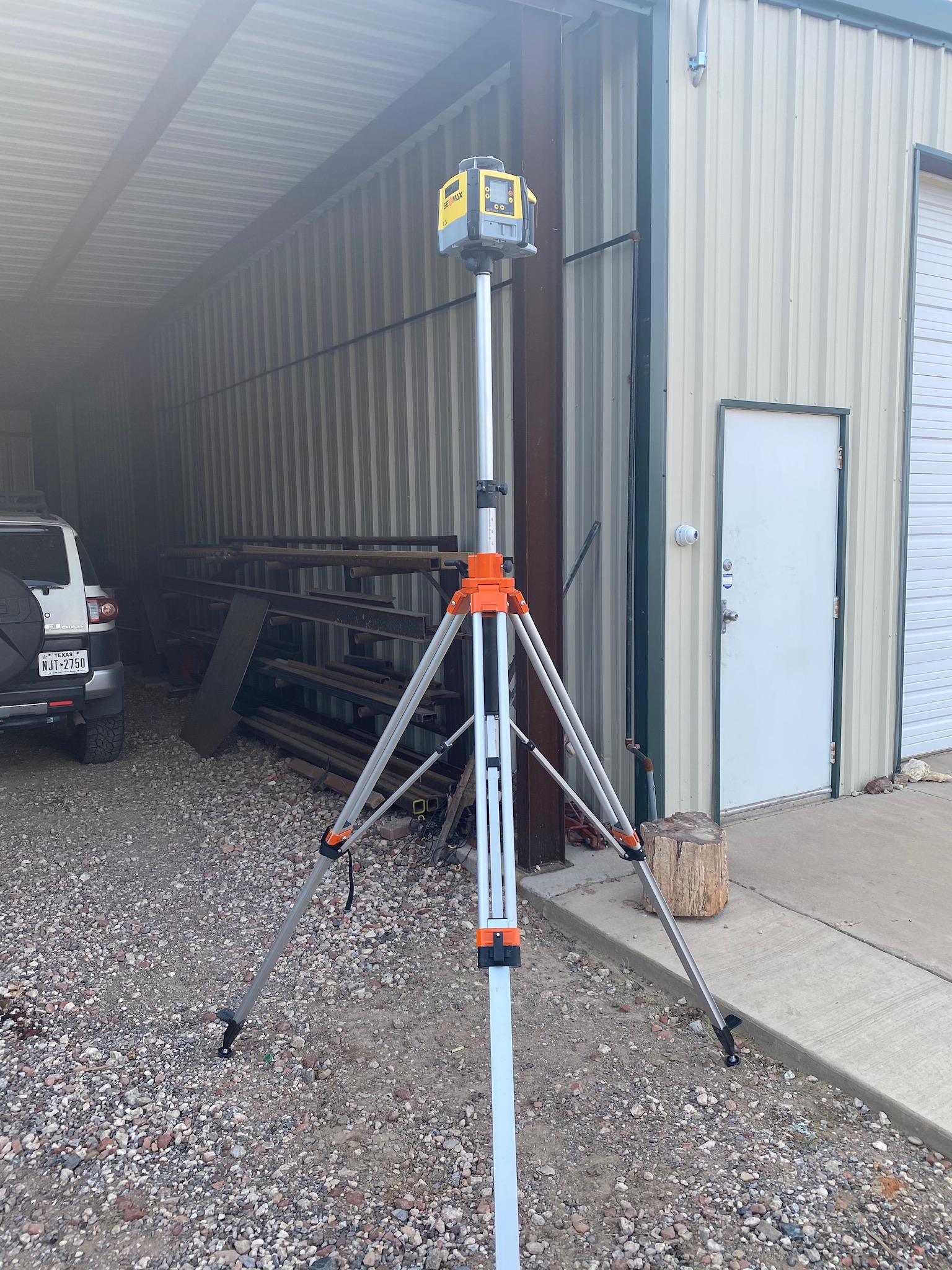

I got a skid steer mounted 7 blade with a dual slope laser. Really pleased with it so far. Supposedly I can grade areas with 1/10 accuracy.

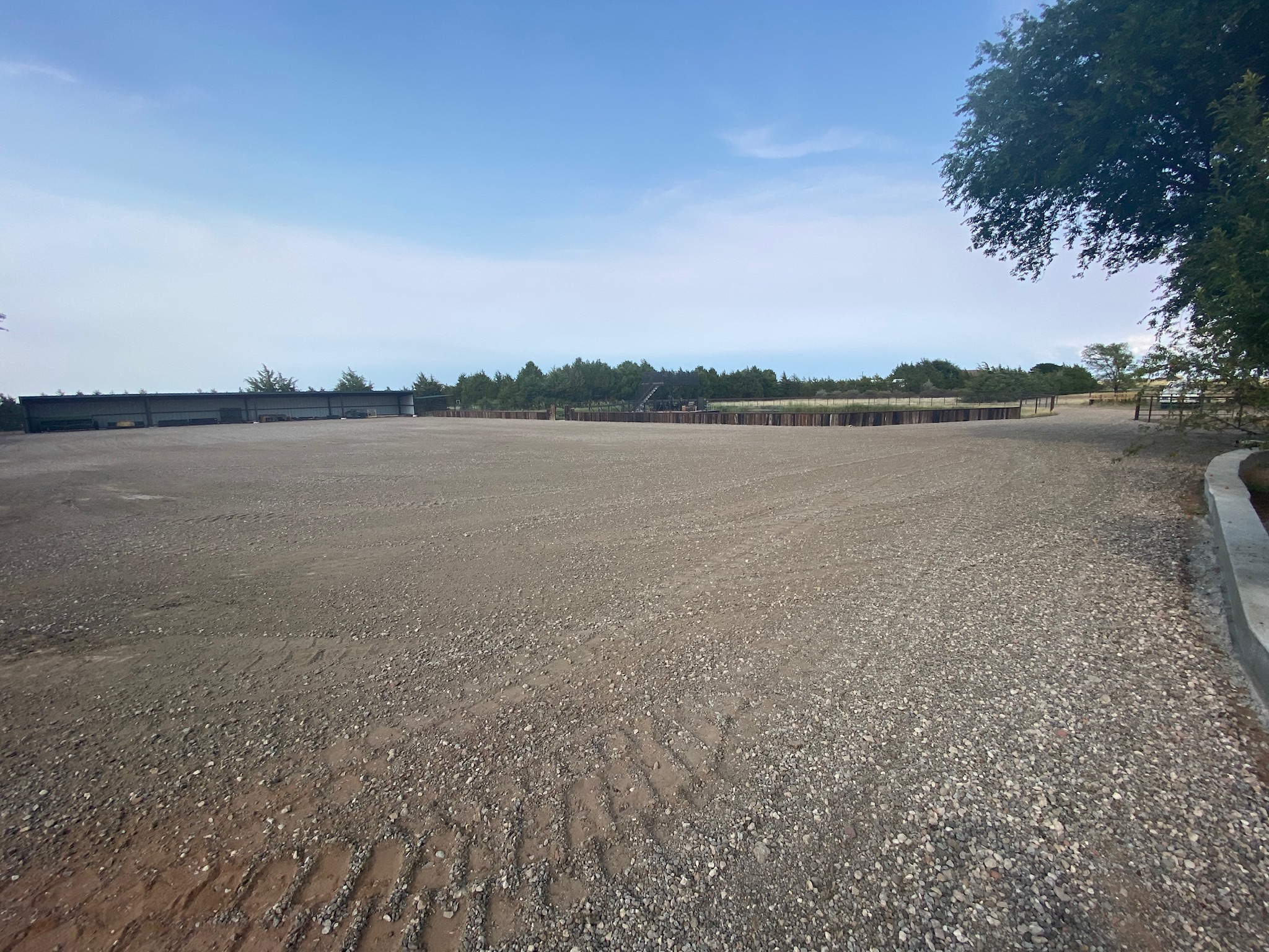

This area at my place never had the ground really leveled but had a lot of crushed asphalt dumped on it ten years ago. Grading it with a 1% slope to the east and 1% to the north took it down to dirt in some spots. Now that it is level I am going to bring in some more material and spread an even 2 on top.
/ Laser grading #2
Does that auto adjust or just give a reference to adjust to
/ Laser grading
It’s fully automatic. Basically once you get it set up all you do is drive around.
