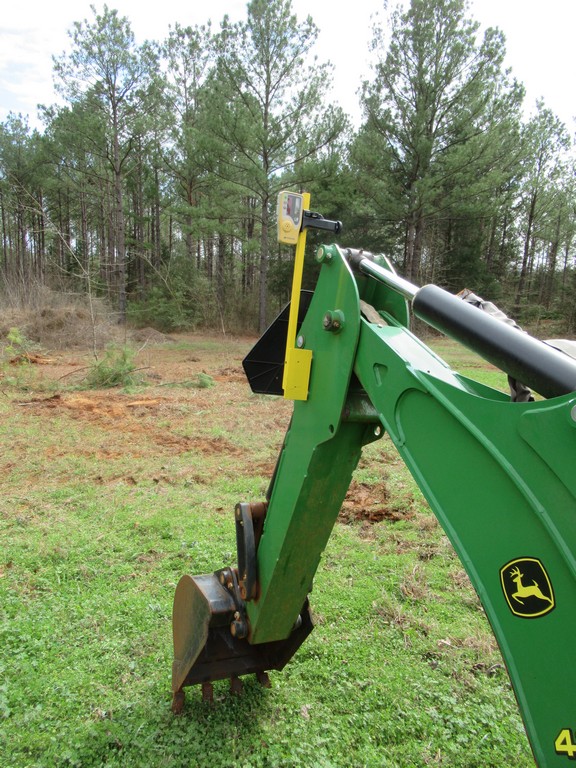

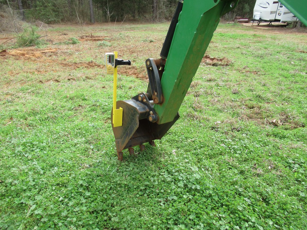

/ Laser Machine Grading--Inexpensive Alternative? #9
Here's what I'm doing. It's a magnetic mount so I can put it anywhere, even on the bucket if I don't dig very deep. Attaches to any piece of metal. It would be nice to have a bigger sensor, but so would a hydraulic control system. This will have to do.

/ Laser Machine Grading--Inexpensive Alternative? #13
View attachment 641467 View attachment 641468
I know this is a 6 year old post, but I'm looking to do this same thing with I think the same laser receiver. Is this a topcon LS-80? How did that work? I'm trying to avoid buying a machine mount receiver, but I'm afraid the sensor window on the LS-80 will be too small and it will be hard to see or hear.
