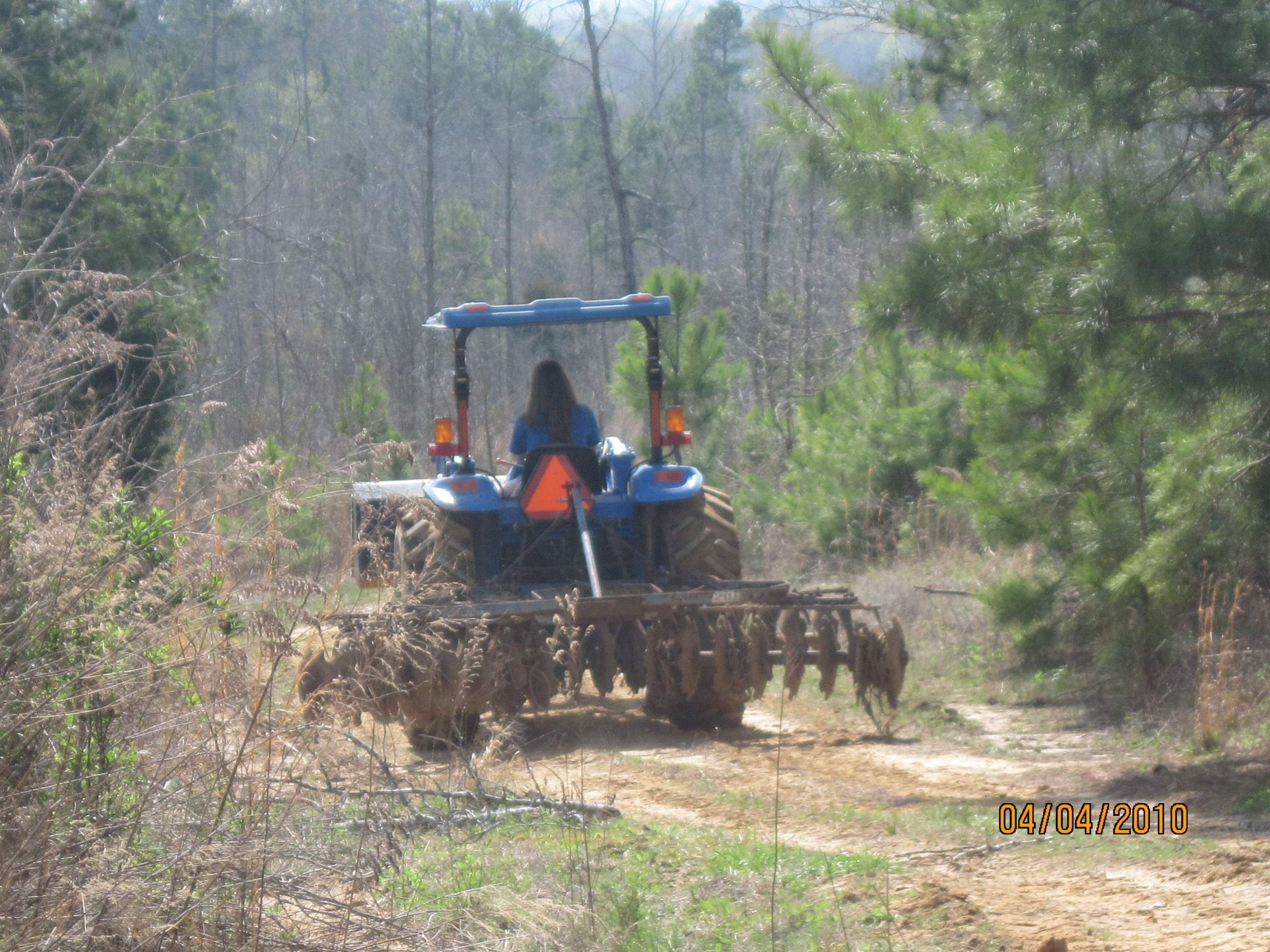

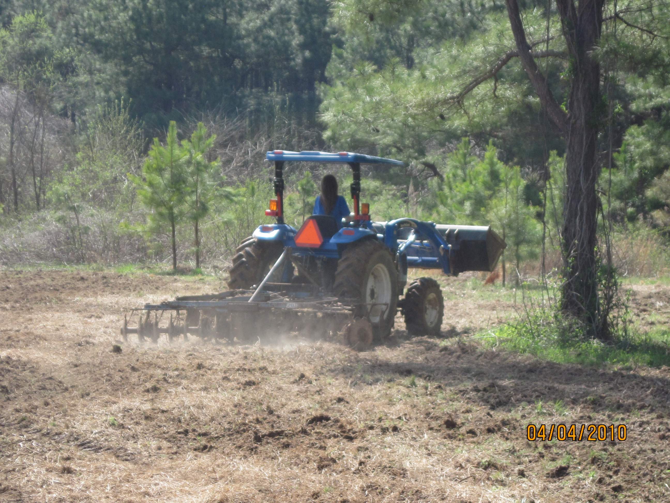

You and me both! I was a "Green Horn" last year and this year I got my TC 48 18la loader in March with 330 hrs and have been blown away by the capability and performance! There is plenty of great advice and know-how on this site and Jim (Jinman) and others have been extremely helpful and kind to a rookie like myself Tractor SKS MS LLC 014.jpg

We'll forgive you because you posted a couple of great discing pictures.;)
Thanks for the compliments. I hope I can live up to them. :)
