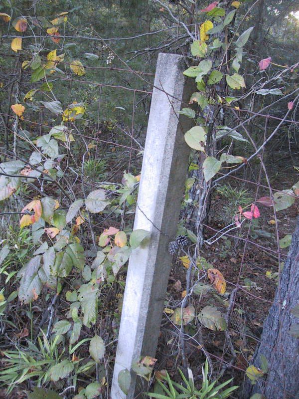

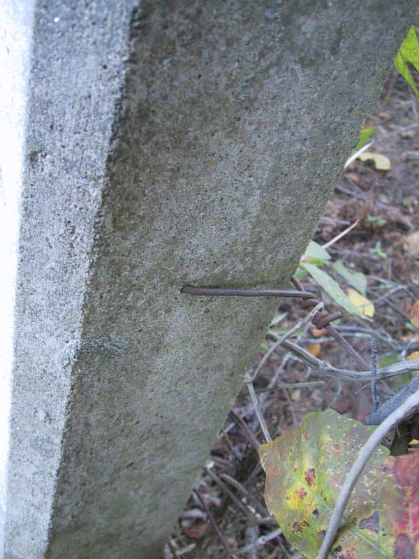

Great Post. and posts.
My father in law built his own concrete post about 40 years ago and they are still going strong. Here is what I think are his instructions, but I am liking your scheme as well. I still have the forms he used in my shed but haven't taken on building any yet.
  • Concrete Post0002.PDF
