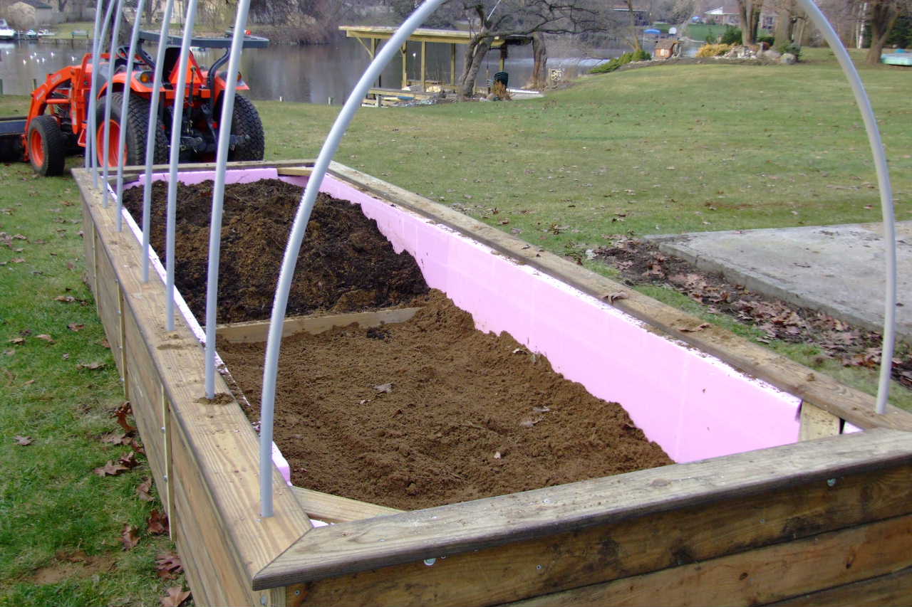

TBDonnelly said:
This was a 'squeak it in' late fall, long weekend project. The wife requested a raised planting bed to over winter some herbs and to have a place for early spring planting.
The planter had to be portable (broad definition :rolleyes: ).
The planter should raise the planting surface to create a more arthritis friendly work place.:)
Actual size of 'planter bed' was 'to be determined'..... :eek:
Disclaimer: Anything I can move with the tractor is considered 'portable'.:D
I interpreted 'raised bed' to mean 'lift' with tractor. :p
Don

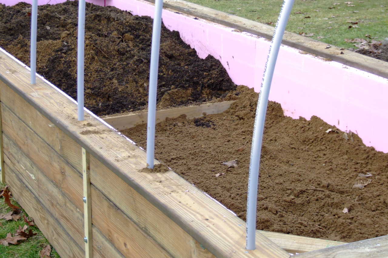

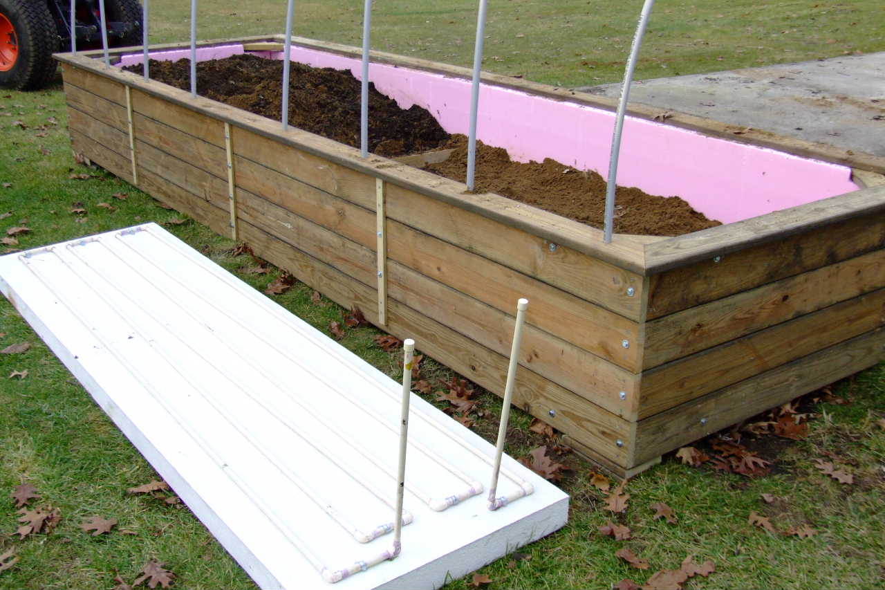

The Raised Bed Planter/Greenhouse/Cold Frame/Hot Bed/Hoophouse update.
I have been researching all the good suggestions. The planter box has been lined with 3" foam insulation acquired from a construction job surplus sale. I'm working jointly on the waterbed electric heating pad and the electric water heater options. The 'infrastructure' is mounted on a 3" aluminum clad foam scrap(see pictures) and will be buried under the surface of the soil to radiate heat upwards. The waterbed heating pad is enroute and will also be mounted flat on the 'infrastructure' piece. This keeps both options open for future development.
All comments/suggestions are welcome....
Don

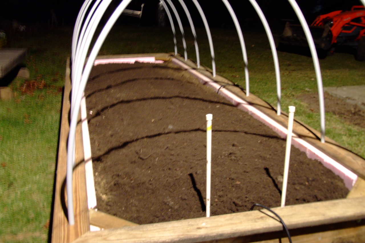

With a rain storm moving in from the west and darkness upon us, I called in some heavy equipment to move dirt from the compost area to the planter bed. The top soil I used was from this summers grass clipping harvest........and now it's rich black gold.:D
The first picture is the heavy equipment doin' their 'thing'. I parked my tractor in front for size comparison. :p
The second picture is the finished product.:)
Don
