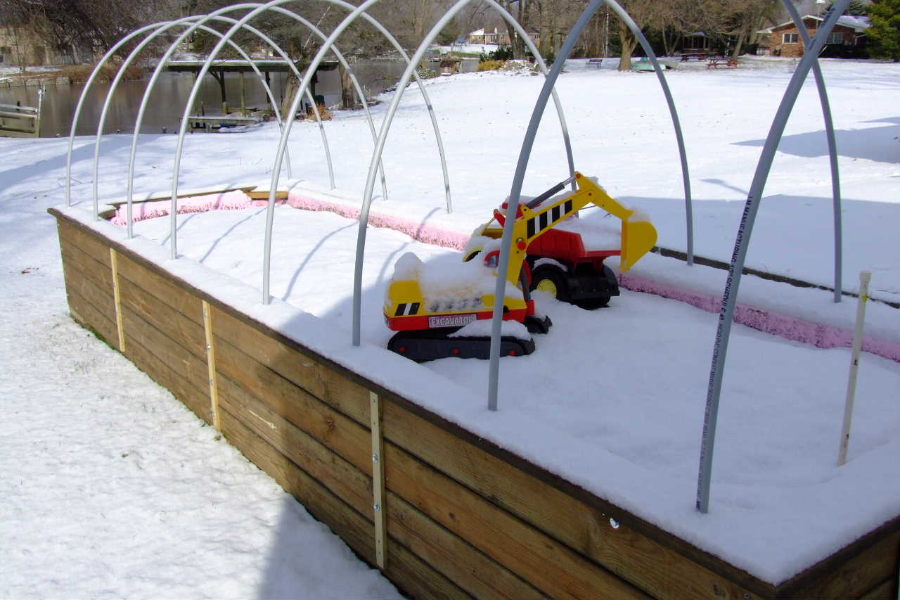

Metal pipe would transfer the heat into the soil a lot faster than the plastic, but with all the heavy equipment you have it shouldn't be to hard to change at a later date, LOL
   / Late Fall>Early Winter Project: 'Raised Bed'
#33

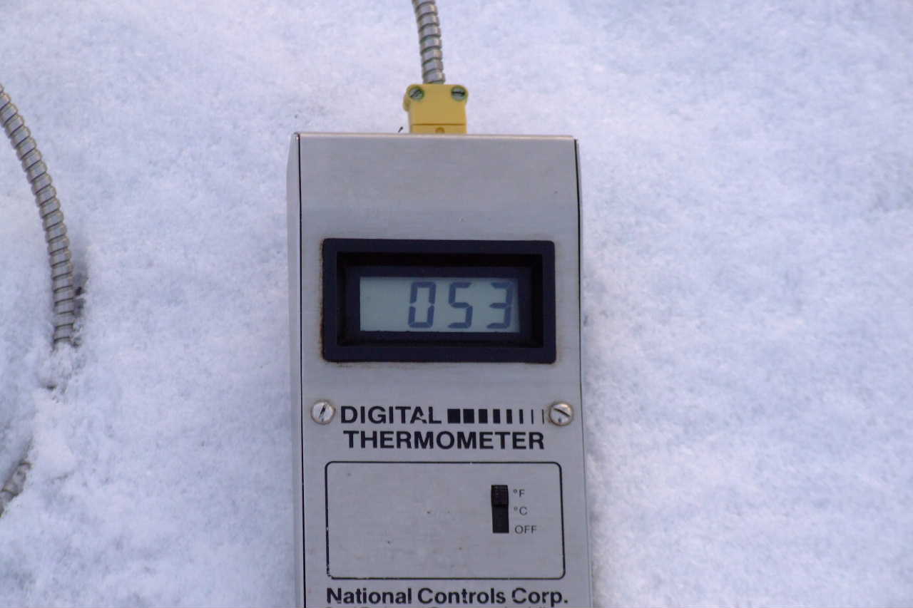

Last night we received 2"-3" of snow. Thought this would be a good opportunity to test the heating mats. Remember there are two heating mats. I'm testing one mat at a time. I used a thermometer with a long probe (about 8") and plugged it into soil. After one hour the core temp was 34-35 degrees Fahrenheit. I'm testing the deeper of the two heating mats first.
I borrowed the heavy equipment from a neighbor who's not in any hurry to have it returned, so it's still here for my use. :D Using metal pipe for increased heat transfer is a good idea. I'll remember that the next time I take the dirt out. :eek:
I set the heating mat on 'low', after 5 hours the core temperature has risen to over 50 degrees (F) :cool: ....see pictures. More later as the temperature rises....
Don
