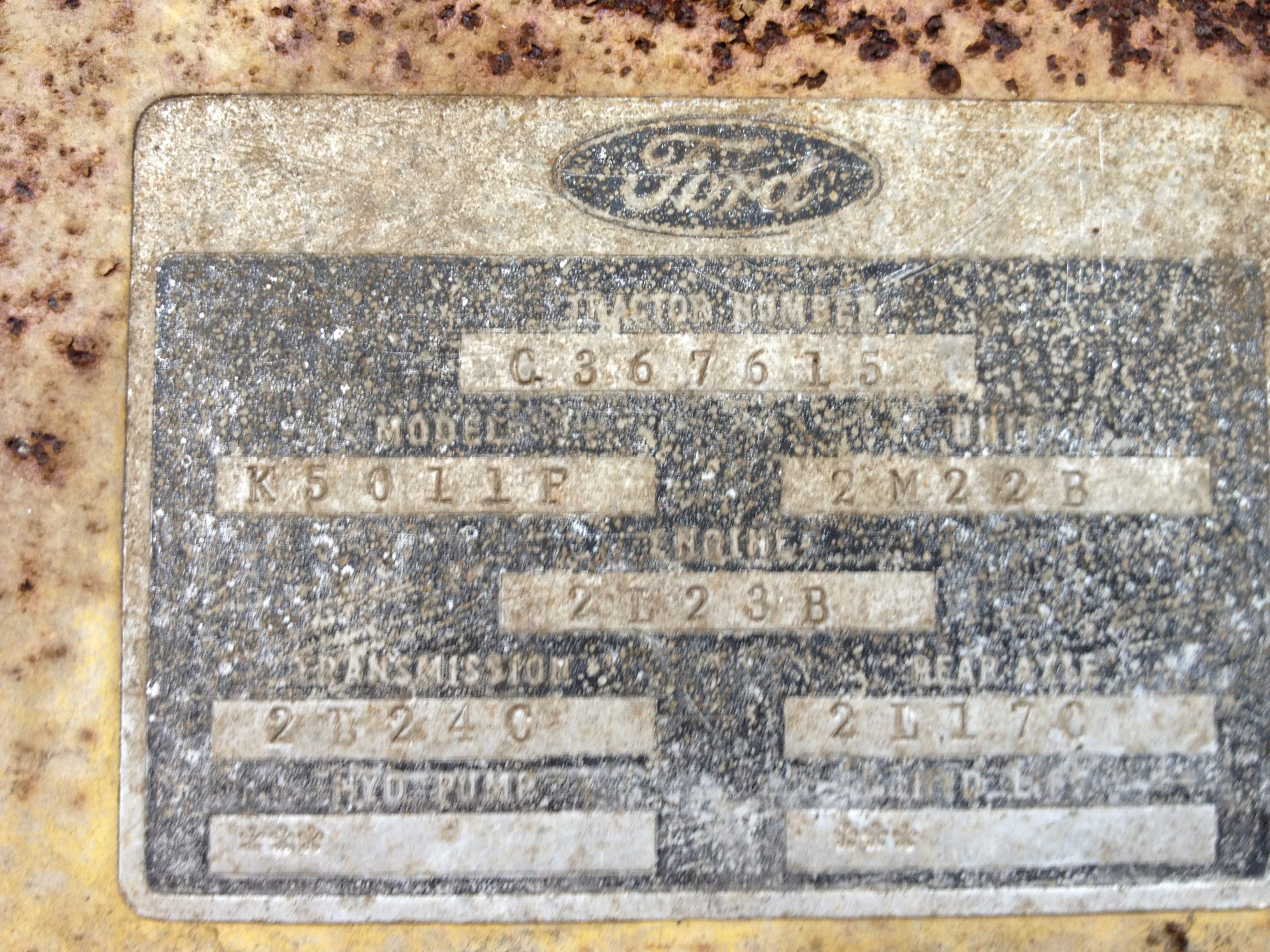

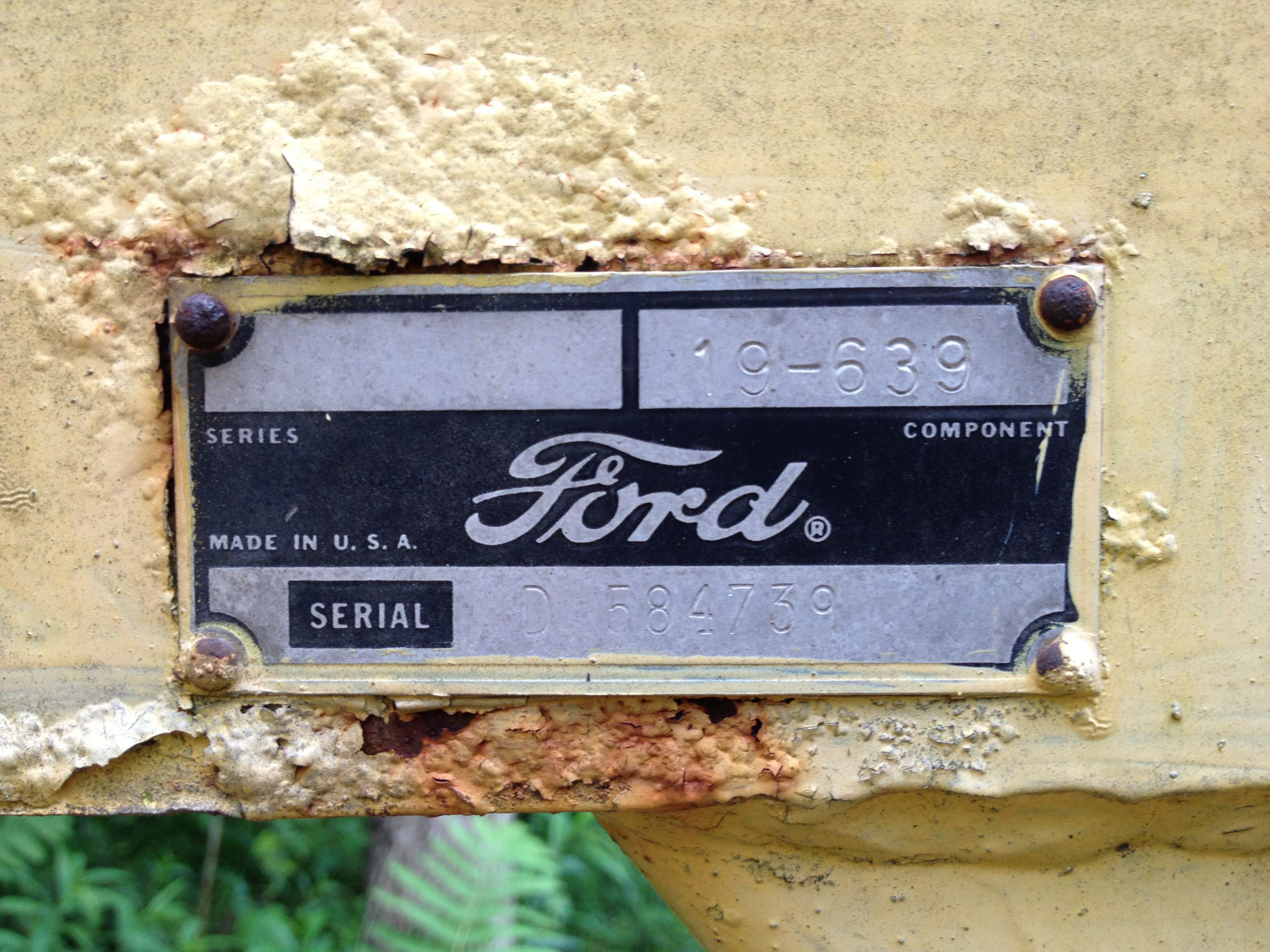

When you say stamped, will they be raised or set into the metal? I found raised ones that don't seem to correspond to the code and for the life of me I couldn't scrape enough of the grime away to find any near the starter. This thing's going to be shining by the time I find them! (mildly related note: can you use a pressure washer on a tractor to get grime off or is it not ok near the hoses?)
This plate was under the hood. Is this good enough or should I find the stamped one on the engine Tractor numbers.jpg?

The under hood plate shows the model code. You must have a newer model. They went away from the stamping to that plate, but I dont know when.
The K5011F is the model code. The C367315 is the serial #. And the rest are date codes. The unit date code of 2M22B Tells me its was made December 22, 1972 On day shift. Probably classified as a 1973 model. According to tractor data on the 3000 series, 1973 started with serial # 367300. So yours is the 15th one of 1973
But the K is the model code is throwing me for a loop. The 3000 series is usually a C in that year. But the rest of the #'s
50- industrial chassie
1- Diesel
1- No PTO
F- 4/4 torque convertor transmission.
That transmission usually has a filter. At least mine does. And doesnt share the same sump as the rear end. They are totally separate.

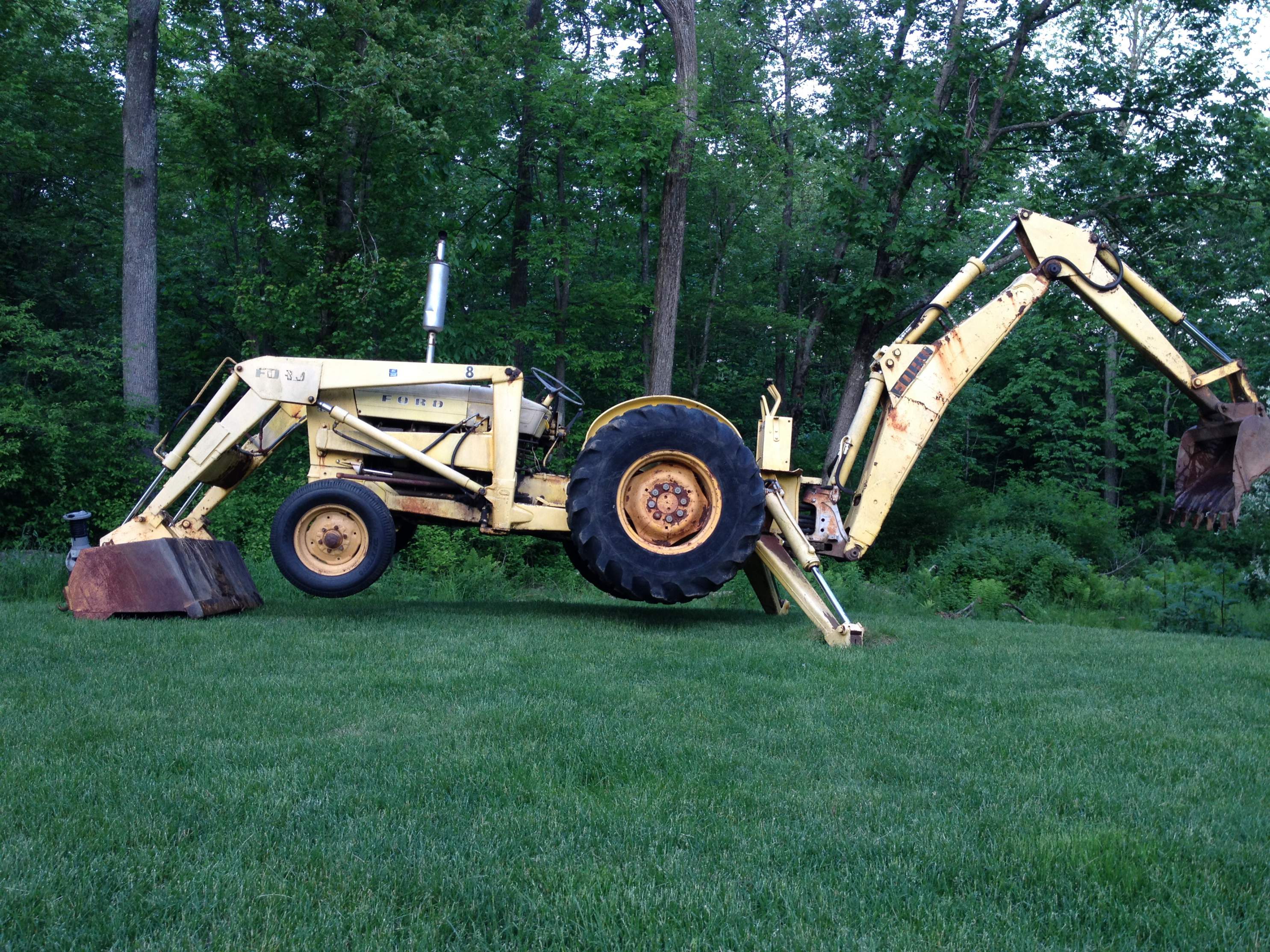

To answer your questions from before, I don't think he put too many hours on it. My guess is that he purchased it to put in an in-ground swimming pool and then used it to play around the yard (I found it parked in a suburbia, seemed very out of place).

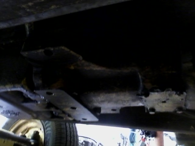

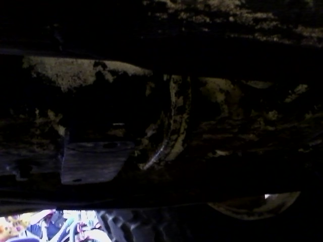

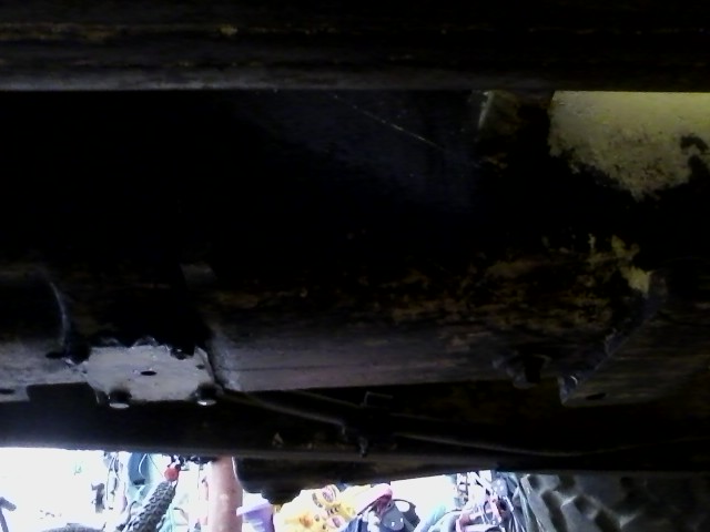

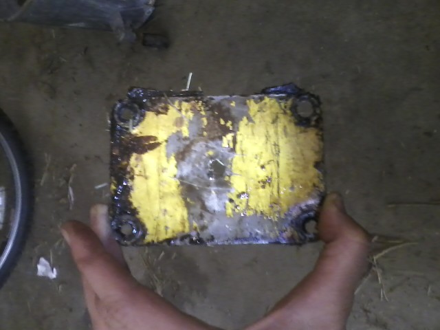

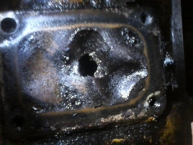

So I got the parking break to engage. I took it off from the bottom and scraped cement out of the ratchet. Good as gold. Now I've located three of my four fluid leaks. Two originate on the bottom. I took a few pictures. They go from front of tractor to rear in order. The first is coming from around a 4"x4" plate with four bolts on the right side of the first picture. The second is coming from a massive joint in what I think is the transmission to the rear axle, shown in the middle of the third picture? I realize I'll probably have to replace the first seal on the little plate, but what do I do about the big one? And what are they? Let me know if I'm being to vague. I can't find in my manual where these elements are covered.

You might have to take some better pictures of that "massive" joint.
But the plate one should be easy. You really have 3 options.....
1. Get a gasket made for it.
2. Get some gasket paper and use the plate as a template to make one
3. Use RTV silicone gasket maker.
All 3 would work just fine. But I'd wait until you are due to change the fluids as you will likely lose a lot. Not sure what it is cause the picture isnt clear, But I would guess its a inspection cover or some cover to get to something inside.
You need to see if you can get some better pictures under there. Use a camera with flash, or get a flashlight cause I am lost.

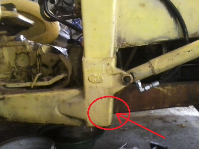

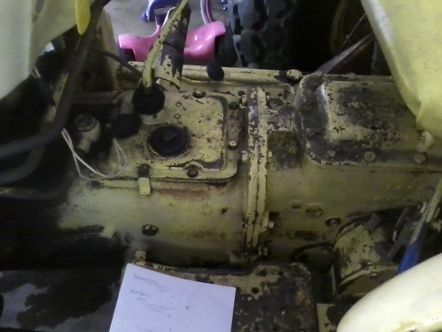

Tell me about it! I downgraded my phone (only camera I've got) and boy it sucks. I'll get some lighting on it. As for my "Massive" joint, it is pictured here as the connection below the seat in the center of the photo (this is the top side obviously). It is where you separate the tractor. I'm hoping it's something where you can tell me: crank on the nuts and it'll fix the leak, but I feel like it's going to be another seal to tend to. 005.jpg

When you said massive joint, I thought you were talking about a hydraulic line or something.
You can try tightening the bolts/nuts, couldnt hurt. Might help it out some. Ford used ALOT of fine threaded stuff. IF those are, you get ALOT more clamping pressure than with coarse thead, if torque is equal. Splitting it to replace that gasket is a Major PITA with it being a TLB
