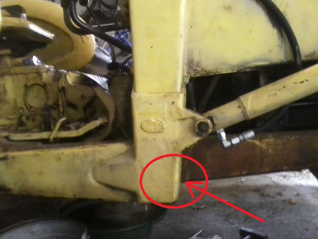

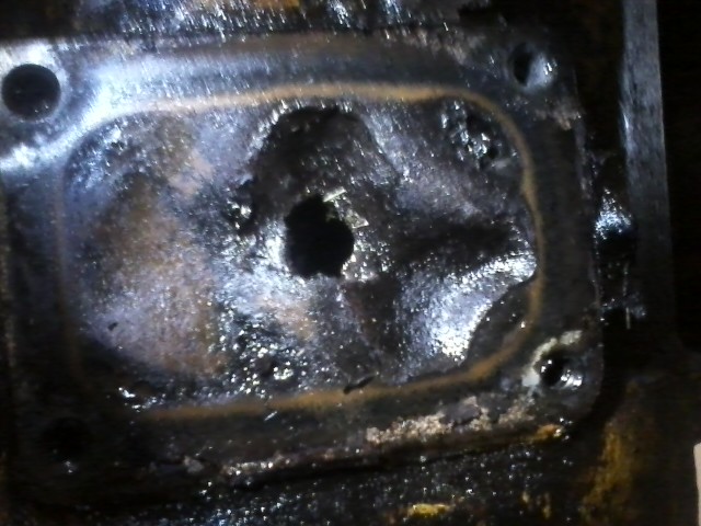

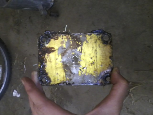

Here's something that I just need someone looking at to tell me that I'm asking stupid questions. Below are three pictures. The first is of a plate I pulled off the bottom of my tractor just forward of the transmission drain plug (note second picture for location as viewed from the right side of the tractor). Note the hole in the center of the plate. The final picture is of the gasket under the plate.
I was getting a leak of white fluid from this spot (transmission fluid I assumed) so I changed the transmission fluid and went to take a look under this plate while I had the fluid out. It looks to me like this cork gasket has a hole punched in it. I should replace this gasket, with a sheet of gasket paper right? I'm not screwing up some "breather" hole or something that probably only exists in my imagination, right? This plate does not appear in any manual I have.
As a fun bonus, there was a dime sized bolt head that looked like it had been sheared off inside, under the gasket. Nothing is acting up. Yet.
