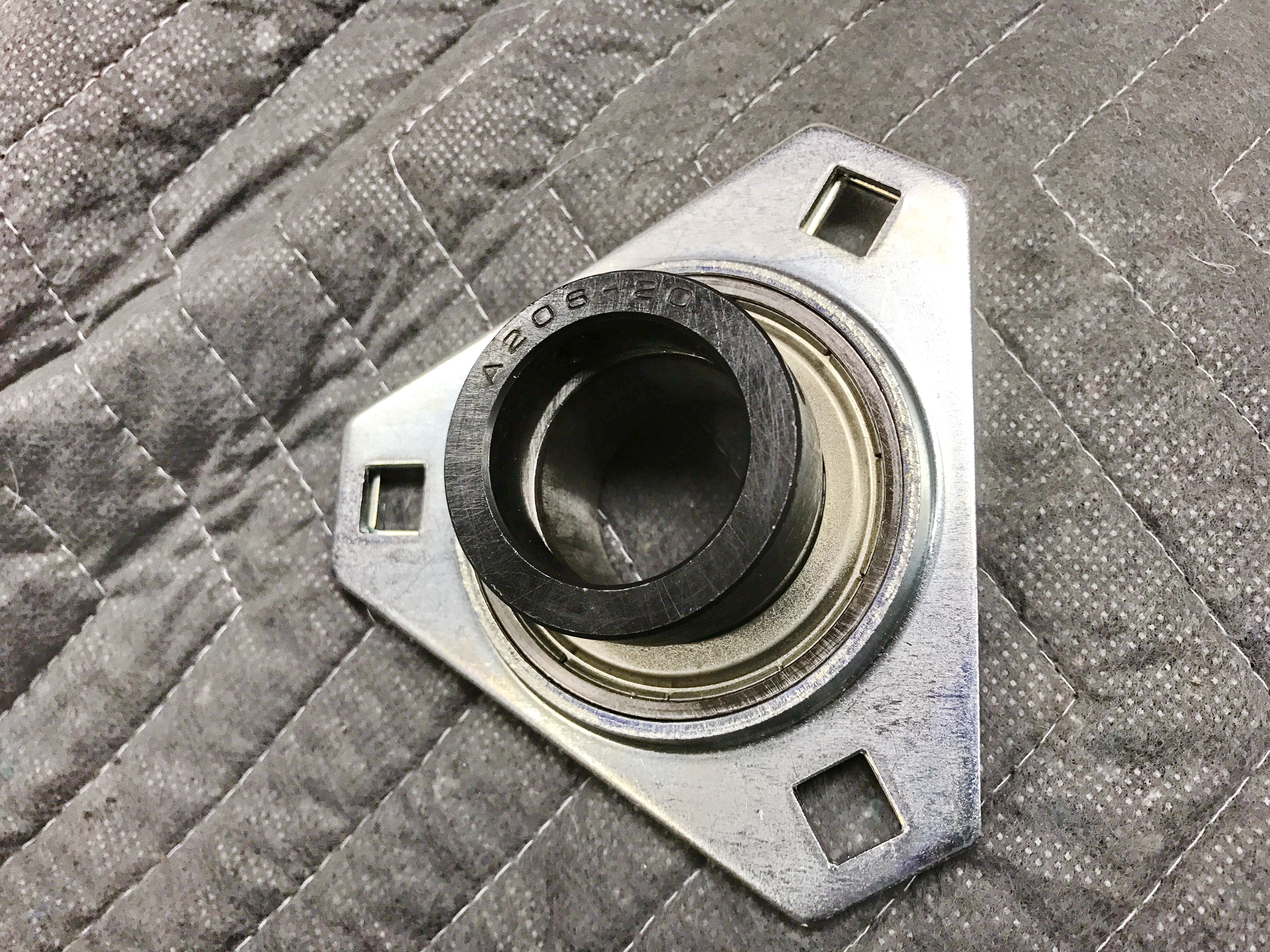

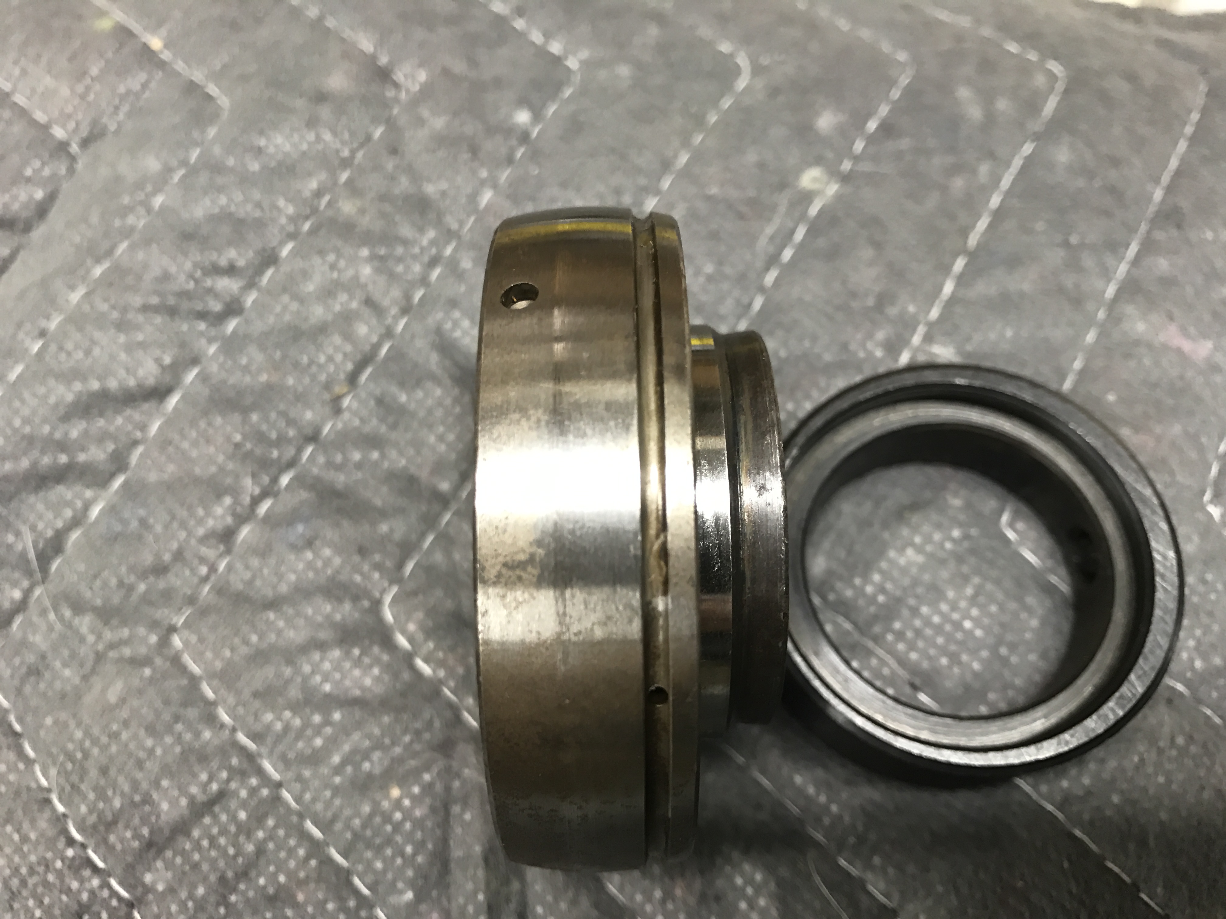

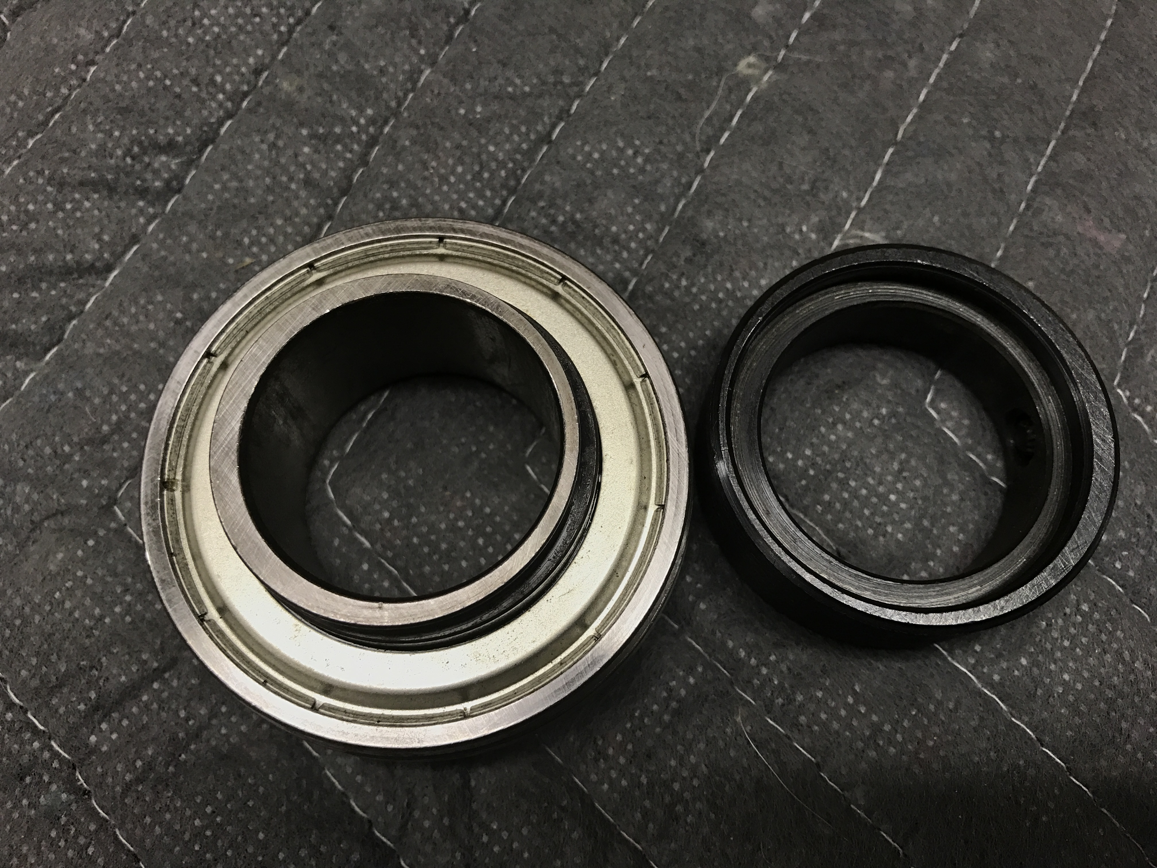

1. I don't have the old gauge roller. It went to metal recycling a few years ago. I do have the brackets. They weren't really only brackets. They were the bearing housing too. It was a cast metal piece with a ball bearing race, and a ring on the inside. Real old timey. They're all rusted up now. I've attached a picture of them. I doubt I could reassemble those as working bearings. Yes you can. The outer race of the old bearings are still in there. They are removed by twisting 90 degrees into the two slots visible in Pic 1 to be pulled out.
2. As you might guess from above, the bearing housings were the brackets. Yes
3. The locking collars are a separate ring that is machined to fit snugly over an edge of the bearing set. The collars are round and not offset. I've attached a couple of pictures of them, too. Yes they are offset. (Eccentric) I can see the edge of the bearing in Pic 3 and the offset is visible. If you try and rotate the collar on the bearing it will 'bind' and not turn 360 degrees??
I wasn't quite sure what to call the 'axle shaft' but let's go with your term.
I think that you've given me a good idea on how to approach this. Drill my own depression into the shaft for the grub screw on the locking collar. There is only one screw on each collar, but let's go with what we've got. I agree, it will keep the collars out of the line of fire from the grass. Hopefully the one screw with the countersunk depression will hold when the body of the roller pushes on the bearing and collar.
I have a friend working with me because I'm way too old and out of shape to wrassle that gauge roller around. He's smarter than me, too. He is sure that we did something wrong the last time we did the assembly because there's got to be other people with this mower that aren't having these problems. Either that or the Matthews Company is making a killing on bearing and collar sets.
Thanks for taking the time to make the thoughtful reply.
There is only 1 grub screw? And I can see the hole in the collar in Pics 2 & 3 is 'blind' i.e it doesn't go all the way through the collar edge??
That hole is for the tool to grip the collar and twist it against the bearing to lock onto the roller shaft shaft. (Like the Chinese Burn you did as kids to each others arm. Twist the skin in opposite diredtions. It hurts.)
The single grub screw then secures the collar from loosening. You can drill the recess into the shaft at this point of the assembly. Use of 'green' Loctite on the grub screw is recommended. The grub screw will bite firmly into the countersunk recess you make. It does not need to be over-tightened. I see people wreck hex-keys by trying to over-tighten these little grub screws. The twist of the locking collar is the securing effect. The grub screw is just a retainer.
Your smart friend is correct and you did do something wrong. The 'fail' was not to twist the collar to lock it.
Hold the bearing with two fingers in the centre where the shaft would go. Place the collar over the bearing. Twist slowly... the collar wil grip the bearings inner race and turn it on your fingers. No matter how hard you jam your fingers in - the collar will... grip. This is the 'eccentric' locking effect.
I hope this can help you understand but feel free to ask if I can help clarify the procedure further.
If you don't have a small 'pin-wrench' to use to lock the collar - Most people don't - use a small punch and hammer to drive the collar around to lock it.

Offset - Eccentric
I lost part of my Post #14 when going back to look at your pics. So, to help you understand what I'm trying to describe:
I want dwell on the terms 'offset' & 'eccentric'.
Place the bearings collar on a flat surface with the recessed side facing up.
Look down the centre as if you were looking at the end of the rollers shaft...
The hole for the shaft is in the centre.
The outer edge of the collar is co-axial with the hole...
The recess for the bearing to sit in is not co-axial - It is offset - only by a small amount, 2mm?
Can you see what I'm trying (poorly) to describe?
Now, the bearing normally would have two flat sides but these bearings have a protrusion on the one side which the collar sits on. Call this the 'nose' of the bearing.
So, if you sit the bearing itself on the bench with the 'nose' facing up - you will see how the inner race has a thicker edge and a thinner edge where the roller shaft would pass through.
The hole is co-axial with the bearing - just the 'nose' of the inner race is machined with an in-built offset (Or 'Eccentric').
It's called an 'eccentric' because when rotating slowly it would look like it was wobbling, eccentrically.
The locking collar has a corresponding eccentric machined into the recessed edge.
Twisting the two eccentrics in opposite directions 'locks' them to the shaft. Then install that grub-screw. :thumbsup:
He was also smart to tell me to post on this forum to get some help. I am amazed at what I didn't know that I didn't know. It's great to find a place to be schooled on this stuff. I have my field of expertise but it's not in machinery. You have opened my eyes to things that would have been obvious if I had any clue what I was looking at.
Indeed, the bearings and locking collar are offset. I just didn't know what I was looking at or observant enough to notice it. While the locking collar will spin 360 when put on the bearing without being on the shaft, once it's on the shaft I can see that it will definitely lock when twisted. One picture attached definitely shows the offset.
There is one hole in the collar that is for the tool to twist the collar. The other hole is for the set screw (grub screw). There is also a hole on the bearing that doesn't go through so it's not for lubrication but it's probably for a tool to hold the bearing while twisting the collar. There is another, smaller hole in the groove on the bearing. I can't tell if it goes into the bearing but even if it does, after assembly in the bearing stampings there won't be access to the hole without a complete disassembly. There is a picture with the holes in the bearing showing and one with the bearing assembled in the stamping.
Thank you for your invaluable lessons here, Spanner.

Phew. I'm glad I got to you before you reassembled and ran it to destroy more bearings. Stay on the line caller. I have more info for you.
Your pics are good, no... great. That's helped your cause.
I'll now refer you to my post #15 above regarding Lubrication AND your Pic #1 in your latest post #17.
There are two holes in the outer race of your new bearing. (As I suspected.)
The smaller hole in the groove is the one that lets grease enter the ball-race to lubricate the bearing.
That GROOVE is to allow the grease to run from the grease gun, through the 'zerk'/Grease Nipple fitting (which you don't have - read on...) into the Housing and run around the groove and into the ball-race. This follows the "Path-of-least-resistance" principle. (POLR)
It doesn't matter where the bearing is in relation to the Grease Fitting (which you don't have - read on...) because when grease is pumped into the housing there is a hollow groove directly under the GF which directs the grease around the circumference until it can pass into the inside and lube those nice shiny balls.
But you don't have a Grease Fitting!
Which is why I would restore those old cast housings and install a GF (Drill & Tap a hole) IMPORTANT that the GF hole is installed so it lines up with the groove when the bearing is installed. Following?
You could probably do this to the new pressed steel housings but the POLR principle means most grease would squish out between the plates.
Now. The other hole...
It is a blank hole. It is there to hold a pin (which you don't have). The pin inserted in this hole is a press-fit, about 2mm proud of the surface and is called the "Anti-Rotation Pin".
Why?
When you are using those cast-type housings I mentioned that the bearing is inserted in the slots and twisted 90 degrees.
The bearing outer race is curved on the outside. Those cast housings are curved on the inside. That's how come you can twist them to install and they remain snug afterwards.
Those pressed steel plates are slightly shaped but rely on being bolted tightly to retain the bearing.
To stop the bearing rotating within the cast housing a pin is installed which sits in the slot after installation and prevents the rotating bearing from using the cast housing as a bearing itself. It's the inner race which is supposed to be rotating.
The pressed plates don't have a slot as they don't need the bearings to turn 90 degrees for install so your supplier supplies bearings with no pins fitted.
The ability to grease the bearing is invaluable and ensures longer bearing life. Especially, as I mentioned before, given the extreme conditions in which these bearings operate with dirt, grass, water etc.
Hoping some/all of this is making sense. Happy to help from down here. :)
