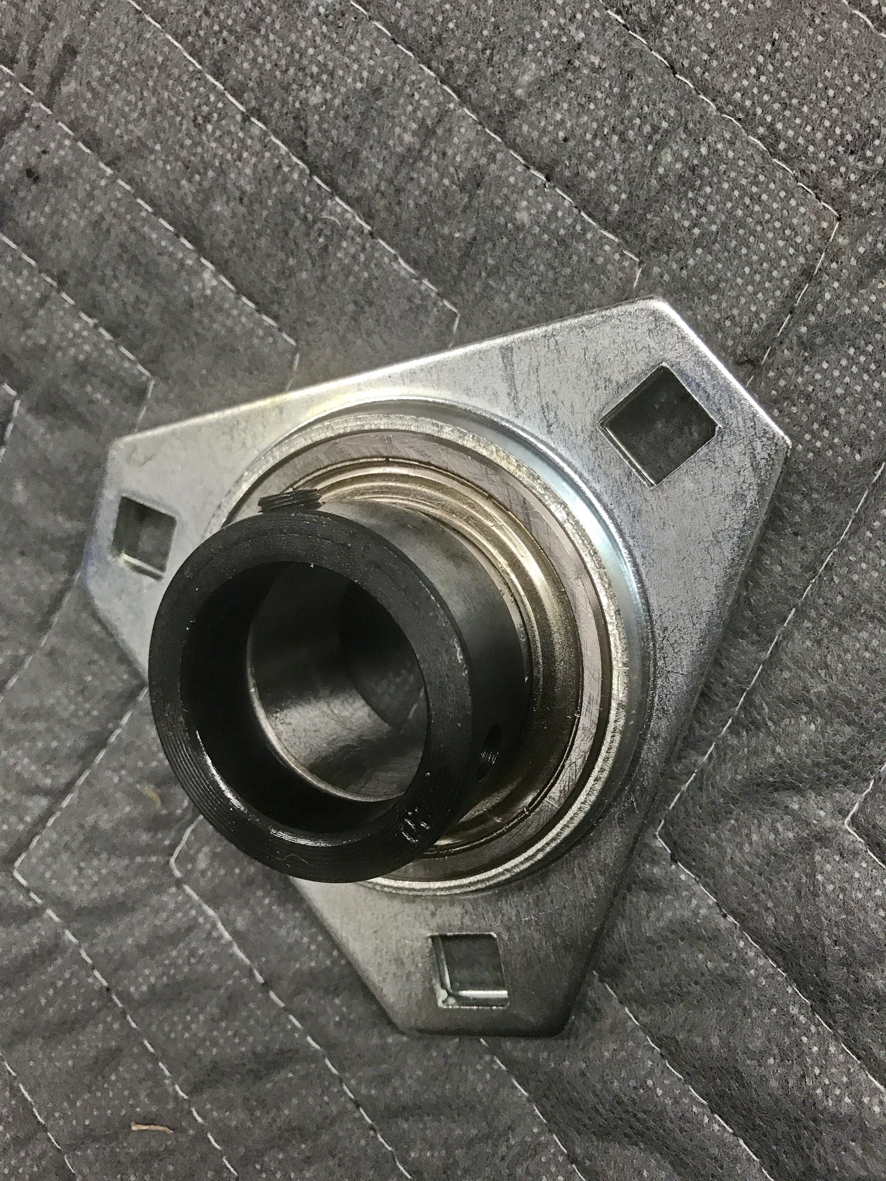

The bearing shown in post 17 is designed to go into the cast iron housings not the stamped steel housing as Spanner has mentioned. Stamped steel housing usually use sealed bearings that require no added grease. The bearing you have may "fit" the stamped steel housing but its not the correct way. The bearing you have pictured requires adding grease and you have no way to do it. If you have to use the stamped steel housing for some reason you need a pre-lubricated sealed bearing. Spanner has mentioned everything I say here (I might have missed it) but I didn't see mention about a sealed bearing.
:thumbsup:
You're right about the sealed aspect. I failed to mention that- was too busy trying to get all the other stuff down in a hurry. I'm a 2-finger, 2-thumb typist.:p
I don't like 'sealed bearings' especially in this application. "Sealed-for-life" is the concept. Unfortunately the lifespan is short on a flail mower roller.

Here's a picture with the bearing stamping laid on the mounting and the outside view with the locking collar included. There's also a picture of another angle of the bearing in the stampings.
I don't see that there is any room for a zirc using the mount & bearing stamping combination I've got. I'd have to find a three bolt housing to match the mount I've got or find someone to fashion a new mount that would hold one of those housings you showed. It's possible that the two bolt housing would work if I drilled a hole across from the bottom hole on the mount. I don't think the four bolt model would work. I think the three bolt model you showed would just be asking for trouble given the weight and leverage of the gauge roller.

AND the other thing I lost with this dreaded Database Error fault was to mention that you should not use the combination of the Pressed/Stamped Housings and those bearings with the grease access hole.
Either - Cast Housings with a zerk and your bearings OR your Pressed Housings with the sealed bearings as Steave mentioned.

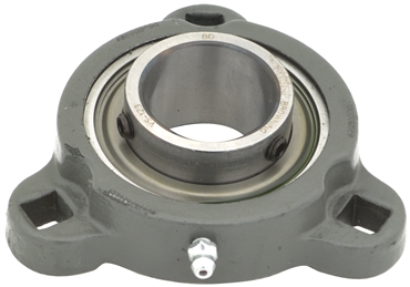

WOW. The cost is significant for some of those. I looked at the first page and saw some of them were over $2,000 each. The cheapest on the first page were over $300 each. Then I used the filter and looked for three bolt, 1.25" options and the costs dropped down to reasonable.
Now I have to understand bolt spacing and bolt circle to figure out which will fit my mount. I'm guessing that bolt spacing is the straight line you mention and the bolt circle is the imaginary circle idea. One of the units I'm looking at has a specification with the bolt circle diameter of 3 9/16". Measuring from the center of bearing, the bolt holes in my mount are out 1 3/4" so that one would probably fit.
One difference is going to be the attachment position on the mount. The bearing stampings and bearing I currently have are attached on the inside of the mount. Any pressure from the roller pushing up against the bearing forces the stamping/bearing outwards against the mount. The regreasable units I'm looking at will have to be mounted on the outside of the mount, putting the stress on the bolts. I've attached a picture of one of them.
That will also mean that the bearing will sit further out on the axle shaft. I'm going to have to measure to see if that's going to work. Now the locking collar is 13/16 proud of the mount at its furthest point. The regreasable unit length through bore is just over 1.5" and all of it is going to be on the outside of the mount.

That bearing in the housing you just posted is one of the "Double Set-Screw" type not an "Eccentric Collar" locking type.
You can use either in your application.

Mounting the bearing inside/outside the bracket will make little difference. The key point is ease of access to the Grease Fitting. So 'outside' is better probably.
FYI: "TRIMAX" brand Flail Mowers use the 'Double Set-Screw' bearing mounted 'outside'.
You'll see an interesting local variation on the 3-hole cast housing in this page: http://shop.trimaxmowers.co.nz/common-parts/bearings.html which allows the mower to run close to the turf.
I think the weak point of your roller mounting arrangement is the 2-hole bracket itself. There is no fixing support below the bearing to the frame.
That was just one of them. I saw another that was Eccentric but it had an even greater length through bore. That's something I'm concerned about because of the difference in length outside the mount along the axle shaft. I'll have to measure to see to what length I have.
It will if the axle shaft is not long enough to handle the extra distance outside.
The key point is ease of access to the Grease Fitting. So 'outside' is better probably. I certainly understand that.
I think the weak point of your roller mounting arrangement is the 2-hole bracket itself. There is no fixing support below the bearing to the frame. That's been evident all along. The side panel of the mower flexes and is even a little bent. We had to use a little muscle to put it back in place.
