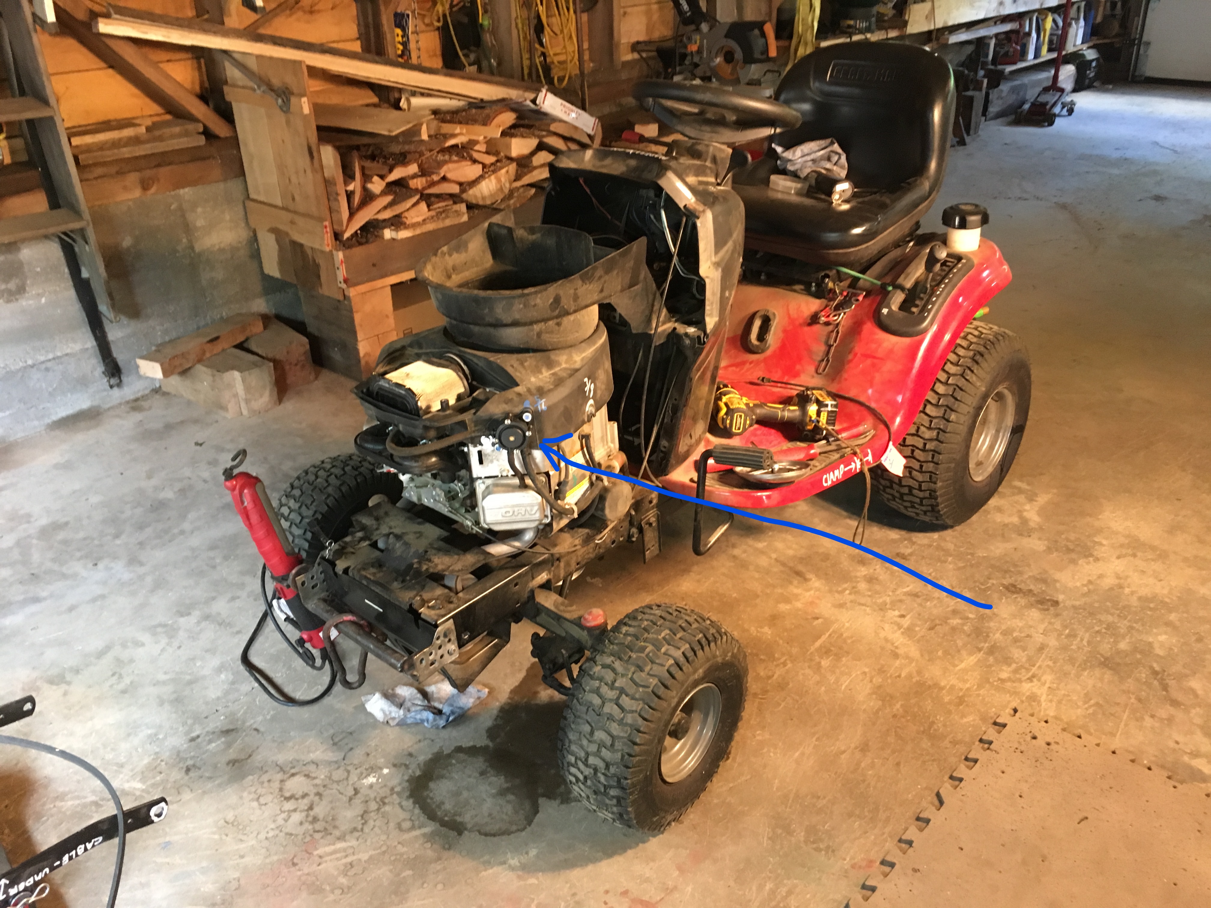

Well I got the fuel pump on this afternoon, easy job. I first did the turn motor over test and fuel started pumping out, then hooked the line to the carburetor and the motor started right up. But,,, why is there always a but, the motor has gone back into the surging mode again and cant find the delete button. Guess now it's the carbs turn for attention, ordered a carb kit so when that shows up I'll see how far that gets on the new priority list next weekend, as if I dont have enough stuff to do, in the mean time I'll give it or me a workout tomorrow.

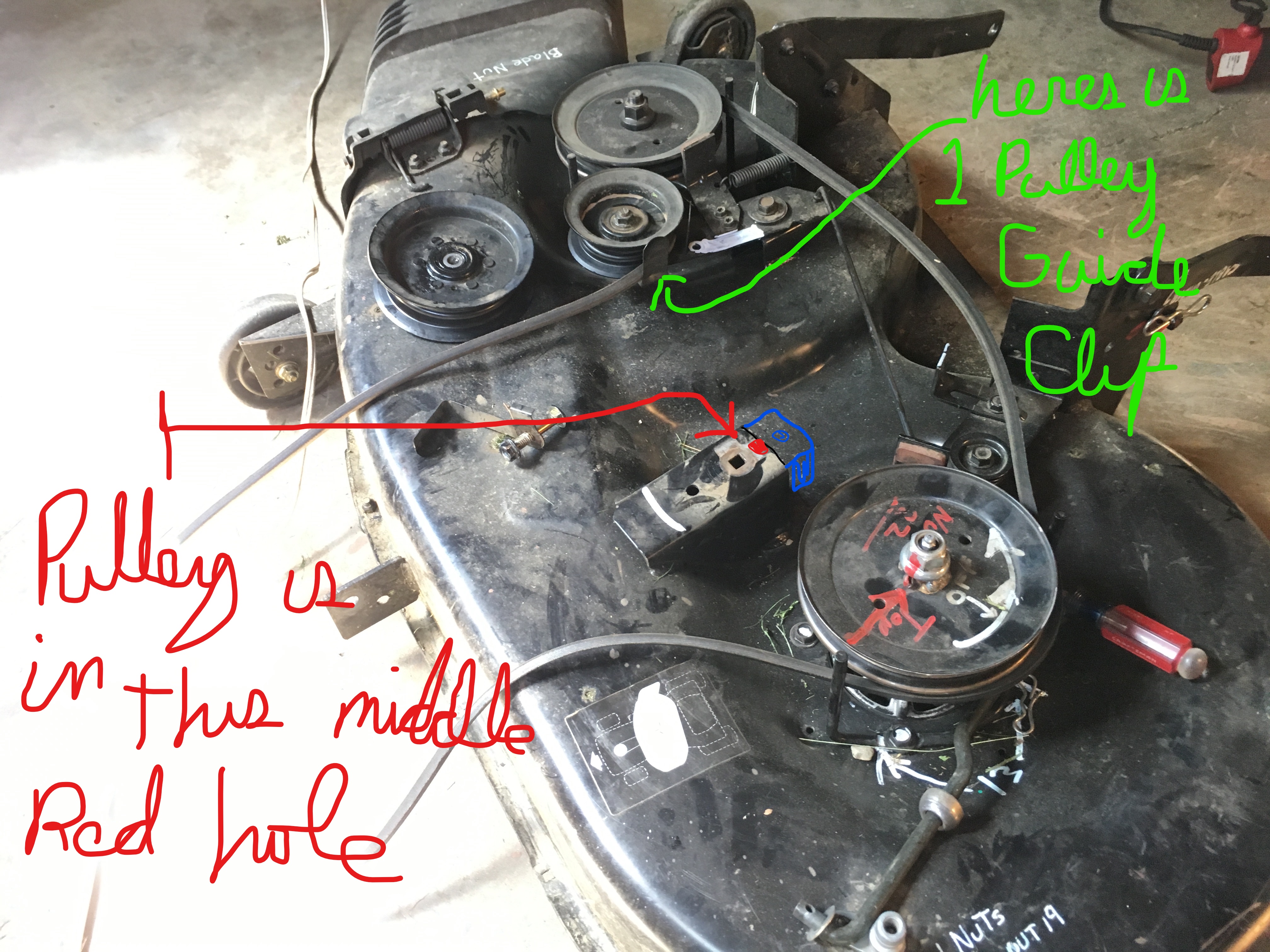

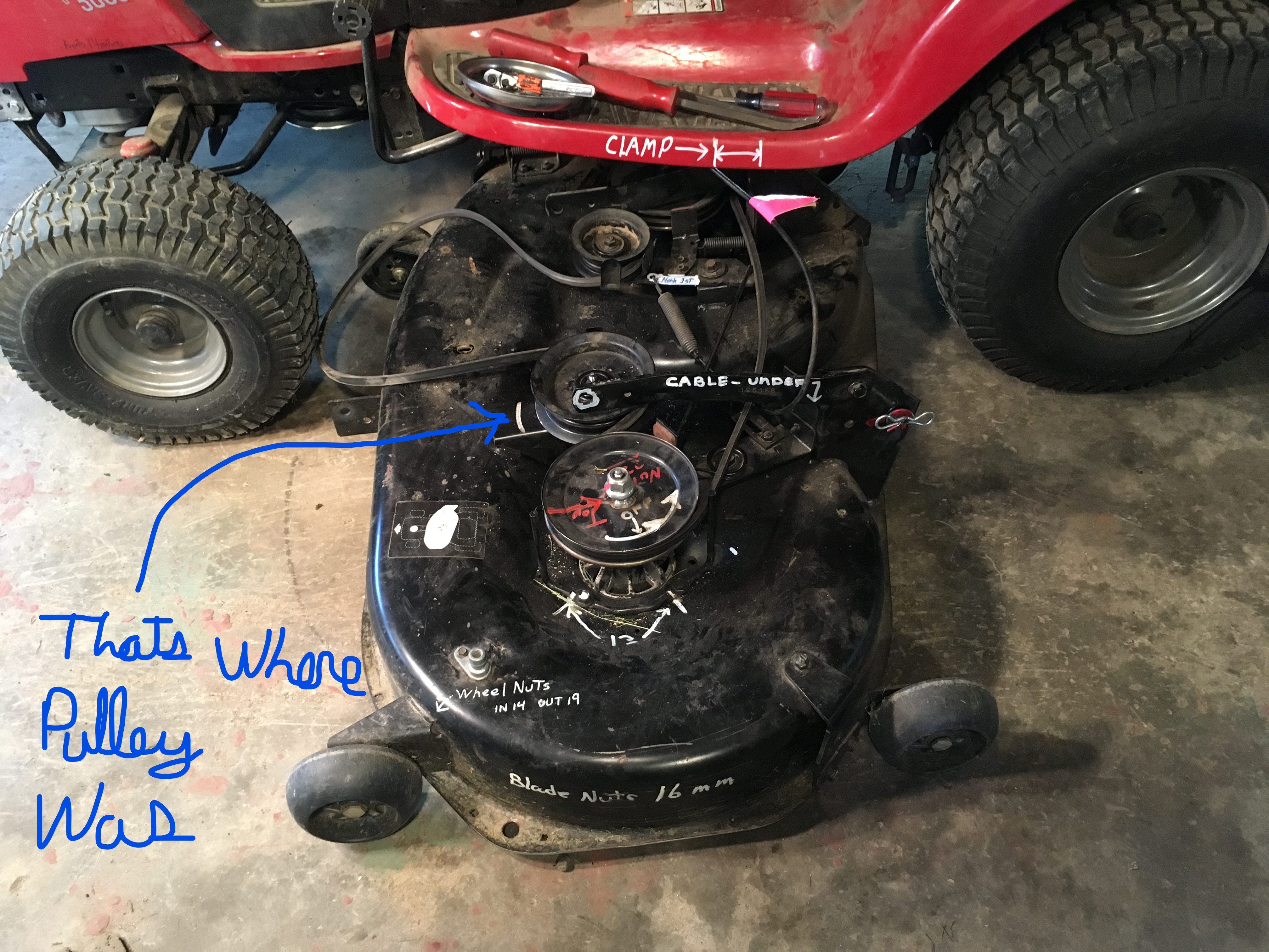

While I had the mower deck off and the motor wasn't running anyways, I decided to tweak the idler pulley so's to have the blade belt snug when engage. I advanced the square notch to end of bracket for carriage bolt, didn't measure but looked to be around 3/4" more. Then for the just in case problem, I added 1-1/2" more to the idler bracket and made another square hole, (side note), square holes are hare to make with round drill. As the afternoon was moving faster then I was I forgot to get a picture of added on bracket with square-ish hole, just imagine the same shape-ish bracket just a weee bit wider, then threw some black paint on while warm-ish.
Also another (side note} when changing one thing watch out for the domino effect, there is a little thin> (1/32-ish) belt guide clip that went on the bracket a certain way. Like a L shape, one end goes up by the pulley, the other end goes under pulley where the bolt goes up threw then L's towards the original end on pulley bracket, then a tab bent down to hold from moving. Well the end of bracket got moved. So quick fix is flatten that little tab, tack weld a nail on, cut to 1/2"long, drill 1/4" in bracket, now that pulley clip guide wont move.

Belt didn't show up today like promised so's to avoid a trip to the money soaking tractor store I dub around with idler pulley bracket, after about a hour got the bracket rebuilt with new holes, now the not so old belt that I have is snug when engage...
View attachment 612834 Sears riding mower - YouTube
Check out this video. this guy seems like a goofball but he knows his stuff.. helped me out a lot. He has lots of good videos on small engine stuff!
How Do I Fix a Surging Engine Video (Lawn mowers, tillers, pressure washers etc.) - YouTube
