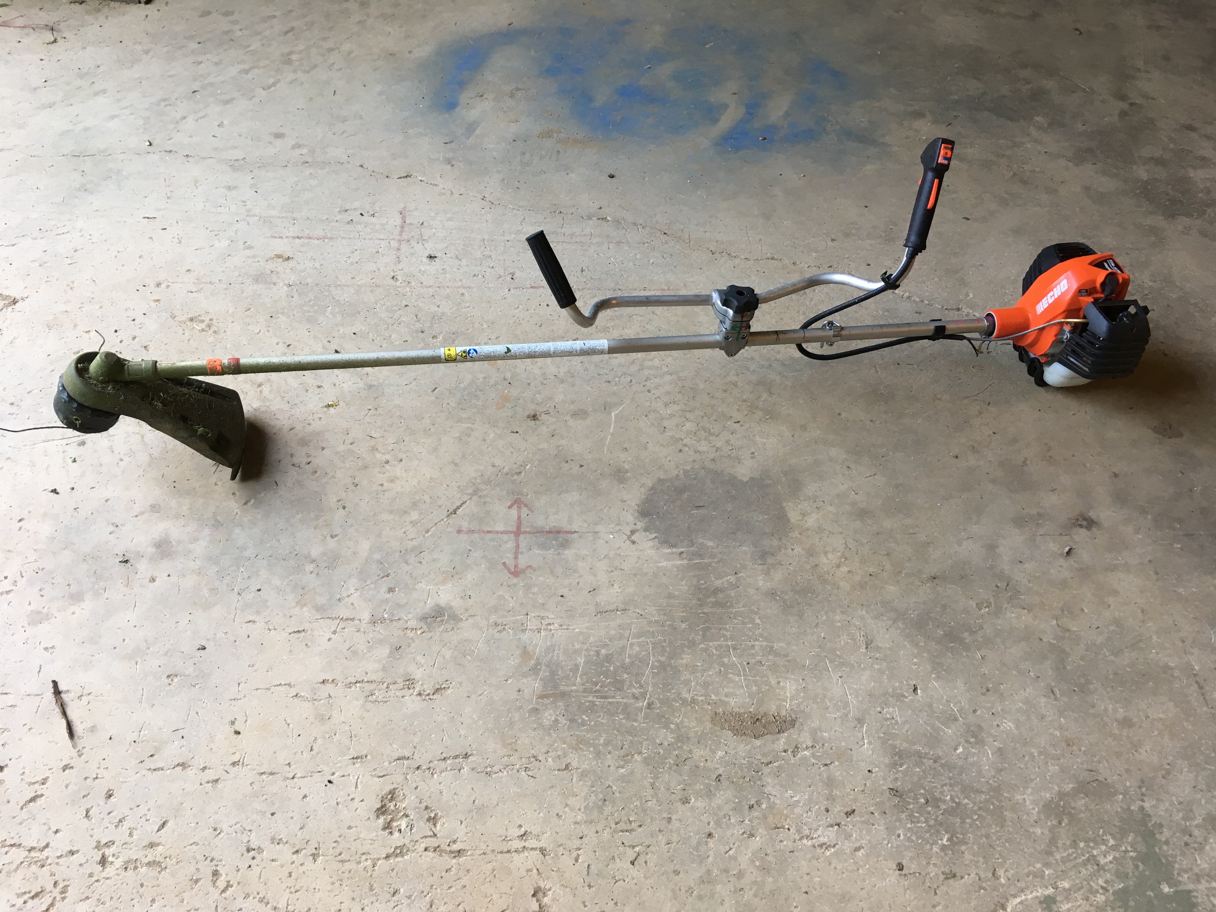

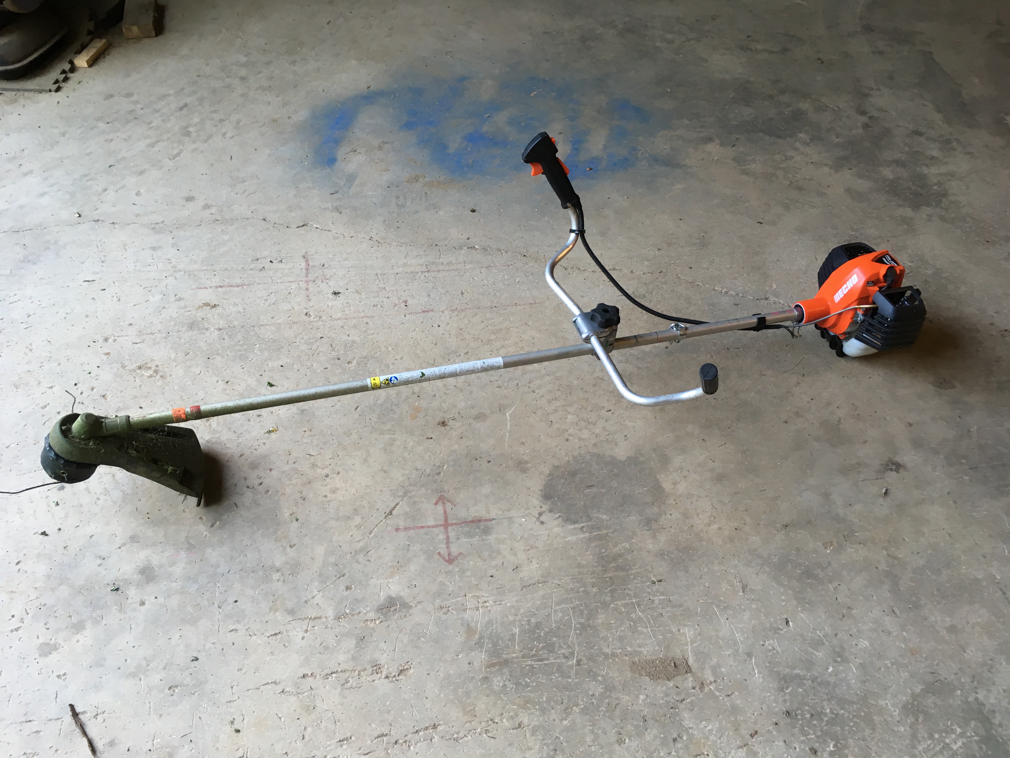

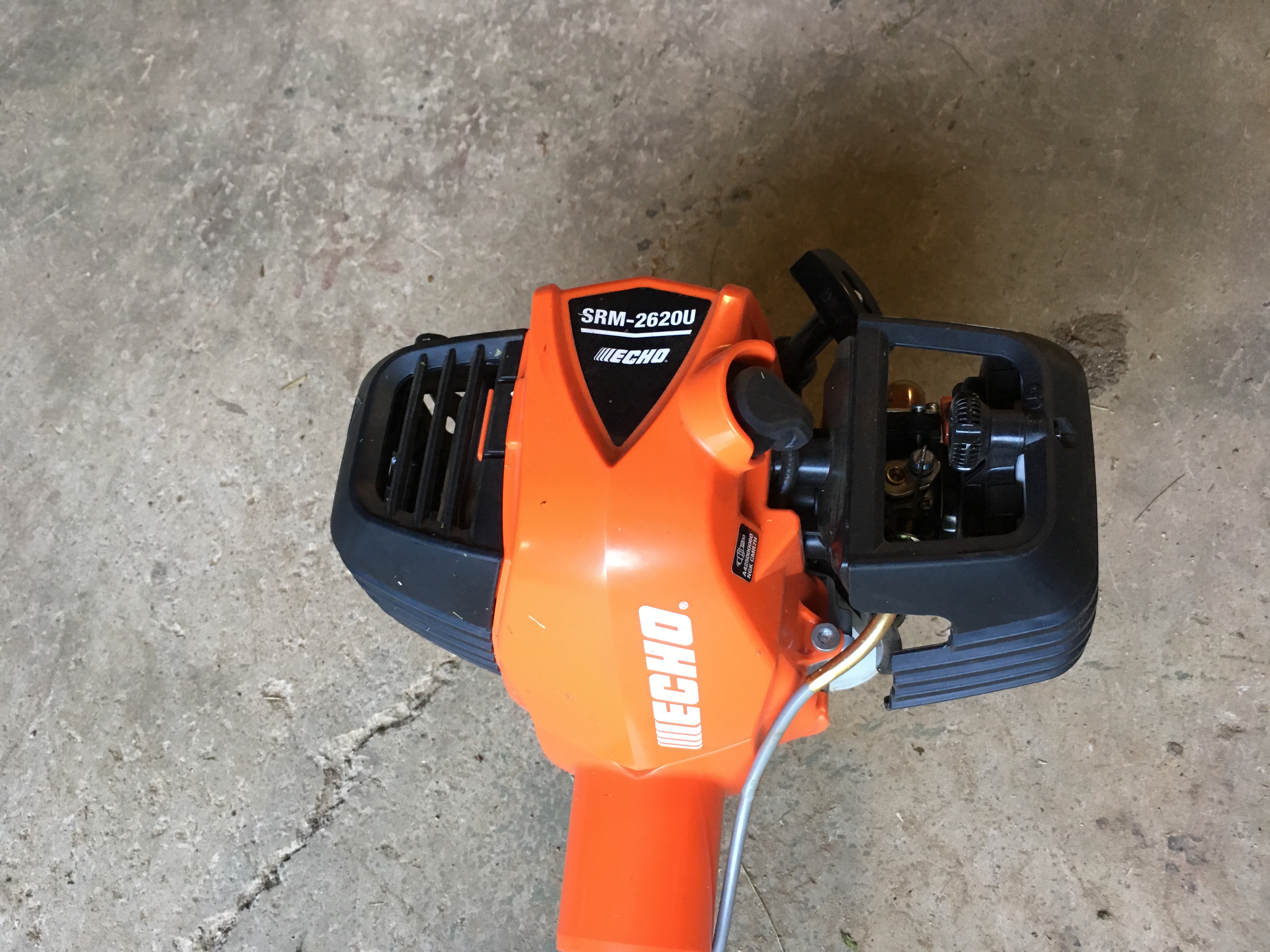

I bought this Echo brush/grass cutter two years ago, it sat or hung with last years gas in it plus a little Star tron in it, ;ast month at first start up it took 4 pulls and today it took 2 pulls, idles great no surging, yet. This Echo cutter has all the power I need, my only gripe is it's made for people 5'-8" - 6' tall, I'm 5-5 and have my harness choked up as far as it can go just so to be comfortable for me to use, be nice if the saw head could have a angle adjustment.
