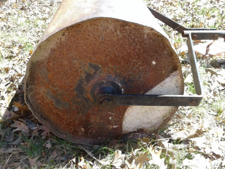

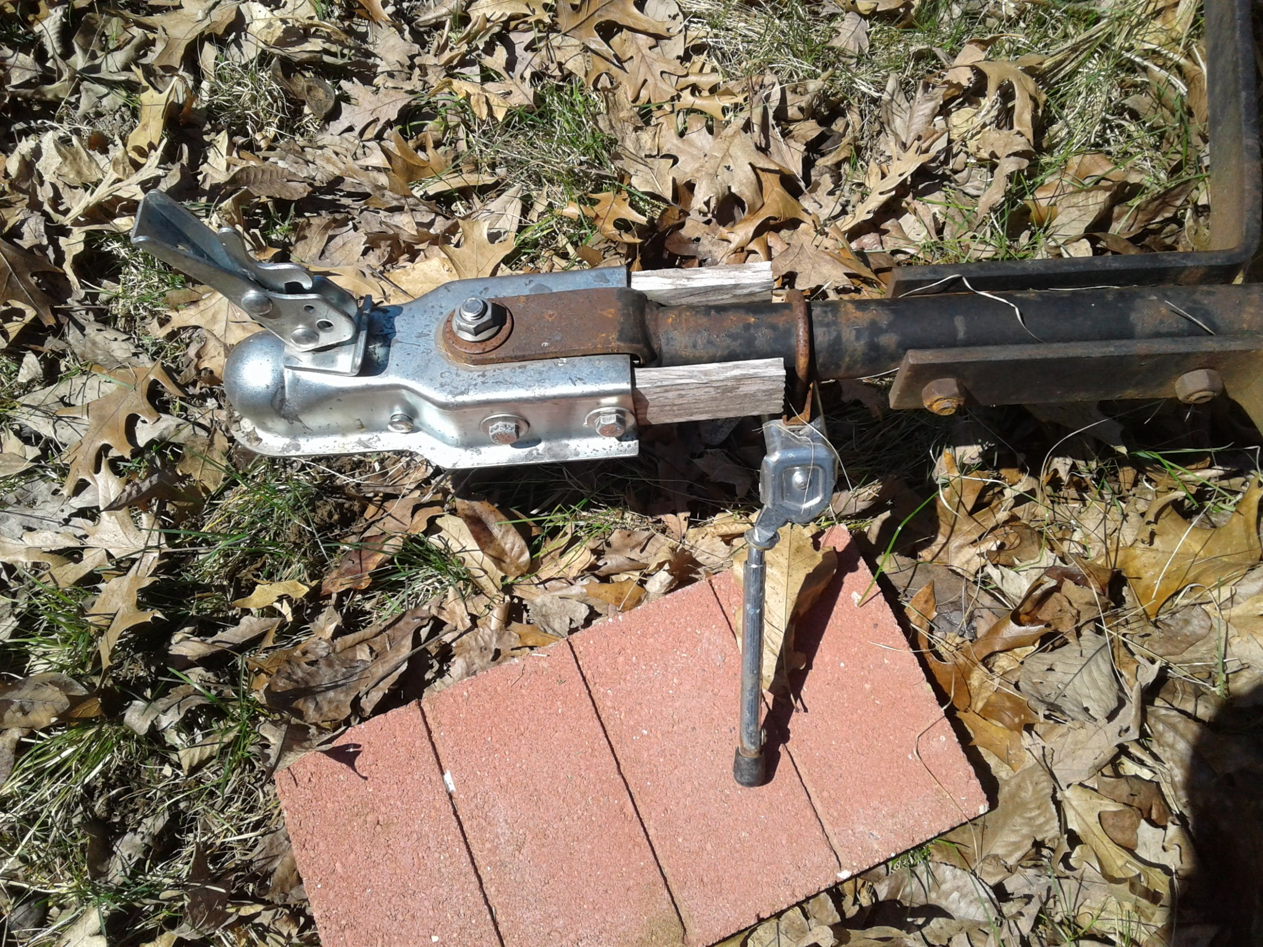

I used concrete filler, no annual fill/empty hassels. Add an automotive style coupler and a 3pt trailer mover.
