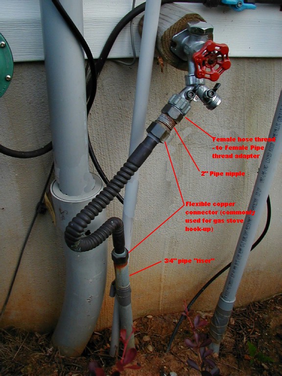

tdenny: Attached is the picture that should clarify the hook up.
heehaw: Yup. That's the B6100.
   / Laying Pipe #16
Re: Laying Pipe part 2
Thats not a water pipe duct taped to an electric conduit is it?? /w3tcompact/icons/grin.gif
   / Laying Pipe #17
WVBill,
Thanks much for the picture. That look simple enough. I have a similar setup with the soaker hoses I use in my front flower beds.
Mine is definitely not as sophisticated as what you've got there. I think I'm going to use your idea to put some water pipe out to my goat's house as well as other areas.
   / Laying Pipe
#18
Dang, Inspector - I thought I airbrushed out all the code violations. /w3tcompact/icons/wink.gif
