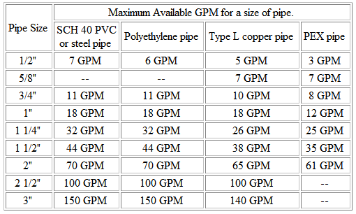

2" pipe is a lot of water and head pressure.....unless you need the maximum pipe output I'd consider maybe stepping down to 1-1/2", it's easier to handle if working with limited help. I've attached a volume chart for your reference. According to the chart (snagged on line) 2" will greatly exceed your pump capacity.

Thanks for the great info! I definitely want to make sure I size the pipe correctly. Is going too big on the pipe a bad thing? I don't need 70 GPM (which the 2" is rated for according to the chart). But the chart doesn't factor in distance. I thought the larger diameter would help given the long distance but if the larger size is actually a bad thing then I would want to go with the 1 1/2". I was trying to lower the losses over the distance.

I was unable to locate my well near my garden. I tried, but could not find water by the garden. I ended up putting my well points (4 points) along a swamp about 350 feet from the garden. I'm using a sprinkler pump that can pump up to 45GPM. Now I need to run a water line about 350 feet.
Would appreciate hearing your thoughts.
Thanks!
I cannot imagine the work of trenching and then putting together and ultimately installing 35 sections of PVC. As you are concerned about pressure drop, you might want to calculate what, if any, the couplings cause.
I'd opt for black poly. Typically 1-1/2" is plenty for most residential uses, but with your 350' of length, you probably should do some calculations. Maybe 2" (whether poly or PVC) is really what you need/want.
Thanks again!
Here's a series of tables that might help you.
http://www.hunterindustries.com/resources/pdfs/technical/domestic/lit091w.pdf

Using a larger pipe size for instance 2" will reduce the friction loss dramatically which will allow for a higher flow and pressure at the garden end. It will not increase the pressure or flow above what you start with it will only allow you to maintain more of the pressure and flow that you have to work with.
