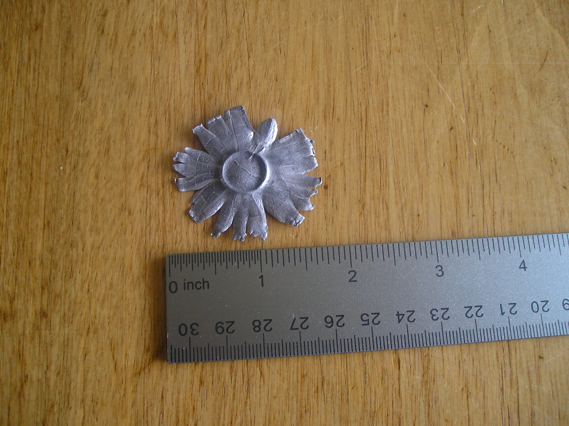

A neighbor has set up a pistol range with steel plates, followed by railroad ties, followed by more stuff (not sure what all is there). In front of the steel plates he hung the rubber horse mats from tractor supply. There's a small gap between the mats and the steel plates. He has a catch basin at the bottom to catch all the bullets. The steel plates stop the bullets, the mats allow the bullet to pass through, but stops the splatter. Seems to work well. (Pistols only, no rifles)

I was planning on making a railroad tie or dirt filled tire backstop. Putting a catch basin underneath doesn't sounds like a bad idea either. The mats too, brilliant. This will be a rifle and pistol range though.

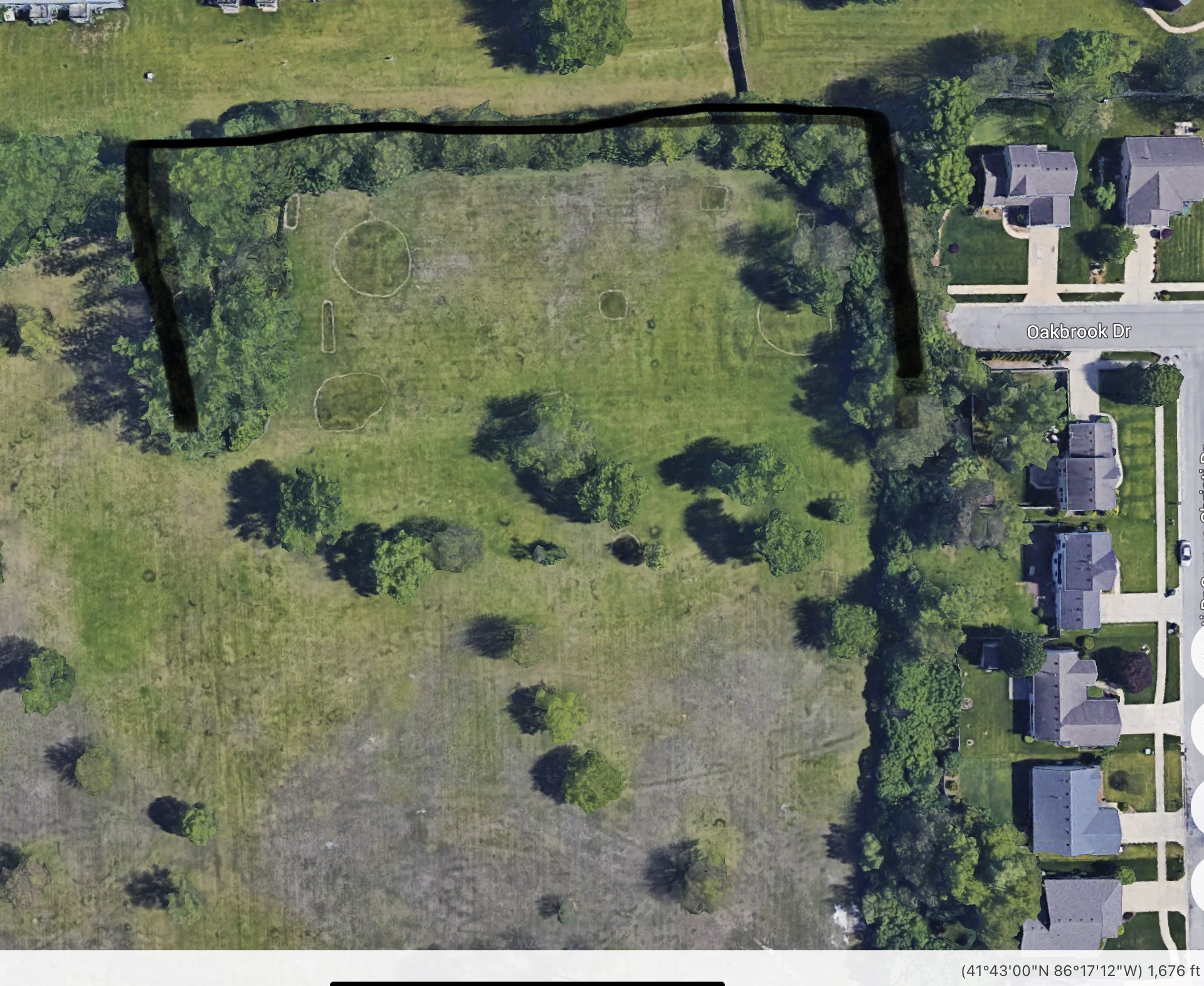

When I was a kid in the late 60s/70s we used to play in this abandoned police shooting range. There was a dirt berm on 3 sides. There used to be cement sidewalks and shooting stations. And there were pits where I assume they launched clay pigeons from. I think it closed in the late 50s before I was born.
We used to pick brass from the grass, and we'd dig lead from the berms. A friend's father would take the lead and melt it down for fishing sinkers and wrist rocket ammo for us. He also made some boat anchors out of it.
A school was built to the bottom of the picture, and houses are now on the right, and apartments on the top. Public park on the left. Someone wanted to build more housing on it, until they found the lead contamination. So it sits 70 years after closing.
(click to enlarge)
